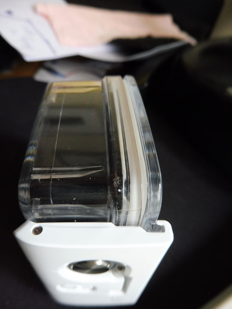

I can categorically confirm that the Yi 4K itself is not waterproof - as evidenced by the fact that mine was ruined on its first outing by the failure/flooding of the official Yi waterproof housing :mad:
I had tested the housing without the camera inside in the pool in our holiday villa and it appeared watertight. However when I subsequently put the camera in and used it in the sea whilst swimming/snorkelling the housing flooded (despite the clip still being securely closed).
Subsequent examination reveals that when the camera is inside the housing there is still a small gap between the main part of the housing and the back door even when the door is closed and the safety clip at the top is secured. Whilst there is a white rubber seal around the inside of the door, the gap is obviously sufficient to allow water to get past the seal and into the housing when the camera is used whilst swimming/snorkelling. Photo below with the camera inside, the door closed and the safety clip secured - you can clearly see the gap.
I'm going back to the retailer and asking for refund/replacement, as this is clearly a design/manufacturing defect. I'd advise anyone who buys the official Yi housing to check theirs very carefully before using in water.
Wow, this is bad.
I got the official waterproof case just to be on the safe side but it looks like it won't be enough. I'll check my case very carefully, anything you suggest to do in order to avoid this issue?
Additionally, where did you buy your camera? What steps will you take to return it? Please also keep me updated (even via PM, if you prefer so), on the return process and its details.
Thanks a lot for sharing, wish you the best for your return.

I will update here on the return/refund/replacement process. I bought it from a small UK supplier. I won't name them yet until I see how they respond, however I will 'name and shame' if necessary, as this is clearly a design/manufacturing defect rather than any form of user error.
Holy **** you are right. The original YI case has indeed the defect you described. I also took a picture of mine, you can clearly see the gap.
This is bad. Still did not put my camera into it but now I'm afraid. Don't know what to do. Should I ask for a refund? Return? Don't know.

That's very concerning. I'd sort of presumed that the issue with mine was a one-off defect, however the fact that your housing exhibits the same gap when closed/locked does suggest that it may be a wider problem.
I have sent a PM to YIcameraCS asking them to have a look at this thread and the photos and provide a response, so let's see what they have to say...
