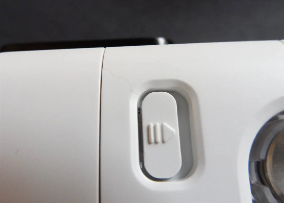

The retailer asked me to take some close-up photos of the case. During the course of taking these I noticed a small hairline crack in the catch/safety lock on the top of the case (photo attached below). So, this may possibly be the cause of the problem? Anyway, the case has been returned to the retailer who says that they will test it (6 hours underwater at a depth of 3 metres, which they tell me is an 'industry standard' for testing - sounds more like the maximum available depth of their local swimming pool...). The fact that they will not test it with a camera inside also strikes me as making the test completely invalid as it is not replicating the 'in use' condition in which it failed. They say that they will place something inside which 'has the same dimensions' as the camera, but I can't imagine what they could find which would be the same, given the reasonably fine tolerences which these things are supposedly manufactured to.
They appear to be trying to be helpful, and have said that they will take up the matter with YI customer services on my behalf - however they have also made a number of statements in emails which are trying to distance themselves from any liability for damage to the camera itself.
Even if the gap between the case and the rear door is not the cause for the leaking, the crack in the plastic surely is an indication of a manufacturing defect (it failed on first usage remember). I hope that YI will show some good customer service and 'do the right thing' by replacing both the case and camera.

Even if the gap between the case and the rear door is not the cause for the leaking, the crack in the plastic surely is an indication of a manufacturing defect (it failed on first usage remember). .
wonder if this will get turned into a 'you must have dropped it and cracked the case' type scenario, hope it works out for you
I very much hope not (and if it does, it will surely be an indication of Yi's attitude to Customer Service). Apart from a few water/salt marks the case is completely new and unmarked (it was the first time I'd used it) and it was certainly never dropped or subject to any other impacts. Any impact serious enough to crack the plastic on the clip/safety lock would presumably have left other scuffs or dents (of which there are none).
