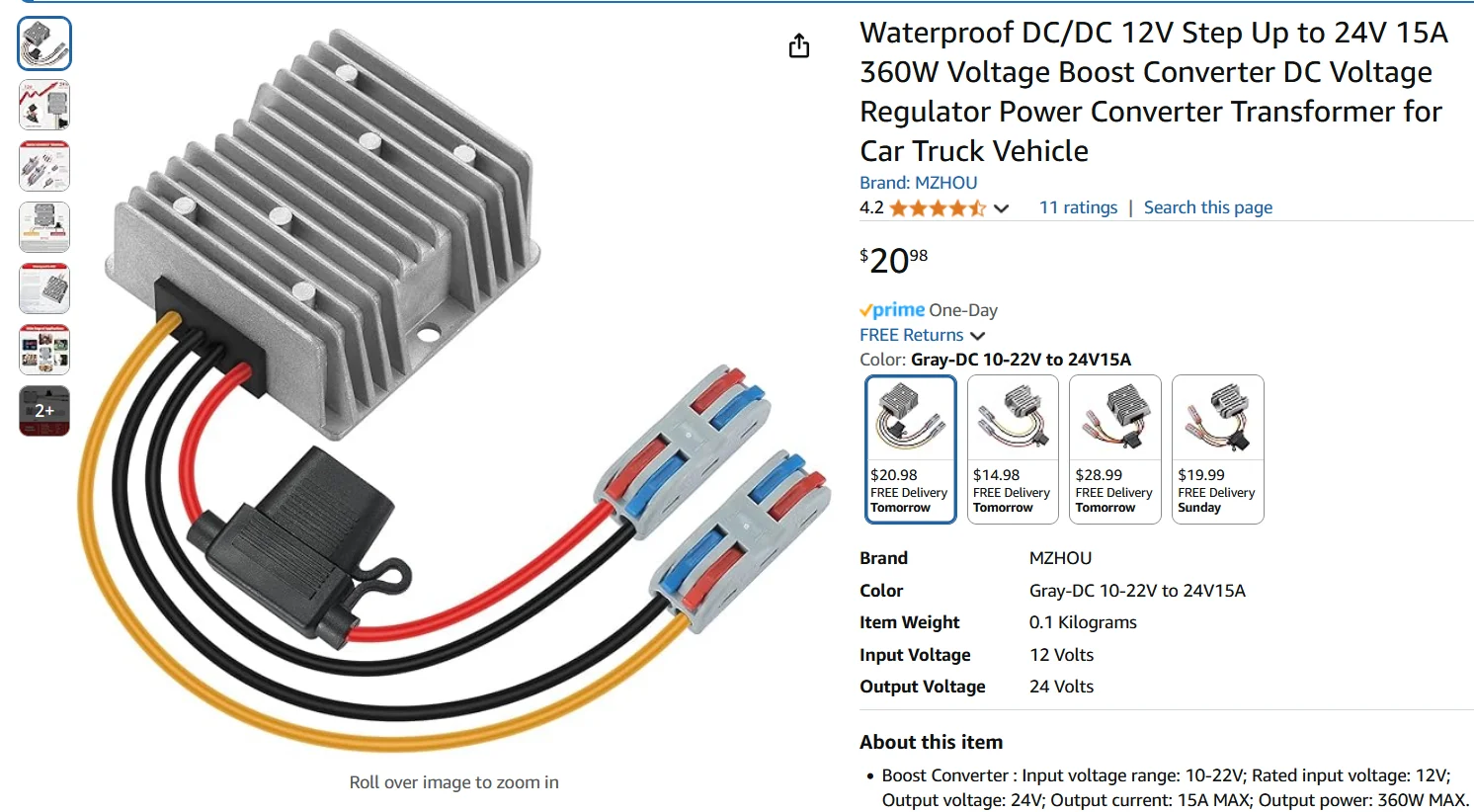

I decided to try a step up converter because it's only $21. And any charge controller that can take 12v and charge at 14.4v would have an internal step up anyway so it should be similar efficiency. I'm going to replace the 40 amp fuse with a 10 amp one and connect it to a switched cigarette lighter port
It works! There's one weird thing, the voltage shown on the charge controller is 14.1v "PV Voltage". I don't know why it's not 24v. I understand a solar panel would have a big drop when you put a load on it, but this is supposed to do 24v 15 amps constant.
Or maybe it's showing charge voltage. Either way, the battery is charging and shows 13.9V

I spoke too soon! The buck converter blew my cig lighter fuse. I'm surprised it drew enough amps to do that because the charge controller only does 12v 10a or 120w. Even with losses, I didn't expect the buck converter to pull 15 amps.
Your Renogy charger has a 10A output charging current.
For simplicity, let's assume that the car's alternator output voltage and the Renogy's output voltage are roughly the same.
Conservatively, let's assume that the charger and voltage converter are each about 0.9 efficient, then the total efficiency is 0.9 x 0.9 = 0.81, then your system will draw 10A / 0.81 = 12.35A from the fuse box!
In reality, your booster/charger efficiency may be less, and there will be some additional losses due to wire losses etc., so you could easily draw around 15A from the fuse box.
You don't want to draw that much current from the fuse box, you risk damaging something or melting the wires and even causing a fire.
If you still want to keep/use this booster/charger (which I don't t recommend), you should connect it directly to the car battery/alternator using a 12V automotive relay, and only the relay's control wire can be connected to the ACC positive in the fuse box. (the wiring diagram is in a link in my post#2)
