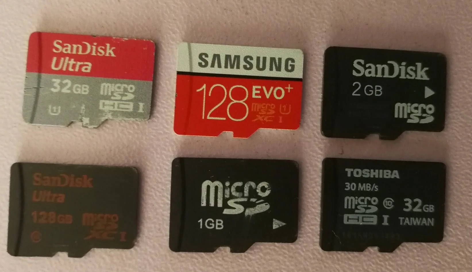

I have the same problem. None of my cards works with YI 4K.
Have you solved it? I appreciate if you could let me know if you did. Merci.

Make sure you have updated your firmware to the latest version.
Failing that, test your card with h2testw. Your card also has to be fast enough to keep up with the camera. You can test the speed with a number of programs.
I have been using 128gb Lexar 633x with zero issues for almost a year.
have you updated to the latest firmware? after doing so, my Toshiba U3 128Gb works great. p.s. if u do have not done, use any microsd (eventually the one you have in your phone, if Android) tu update the firmware, and then insert the 128Gb card...
