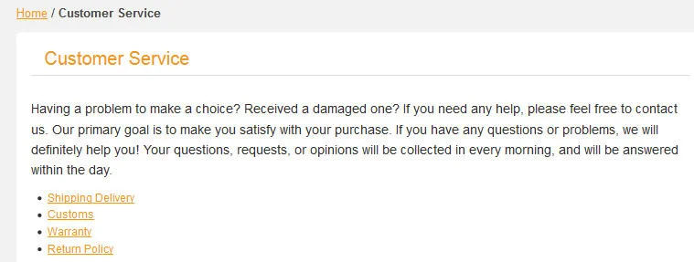

Lukas has a Customer Service Page, are they involved with these issues? Seems like a "Technical Support" bullet is missing. I have seen reps for other cams involved in the forum but have yet to see any presence from Lukas.
Their support page image:
