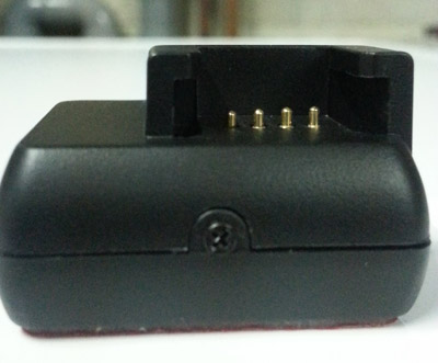

Foxoffer firmware 20140429 V1.0 have bug. Cam freeze after max 6 minutes after power on, if is in GPS stand and if is GPS turned ON.
With GPS turned OFF or if is powered on out od the GPS mount - it's working.
