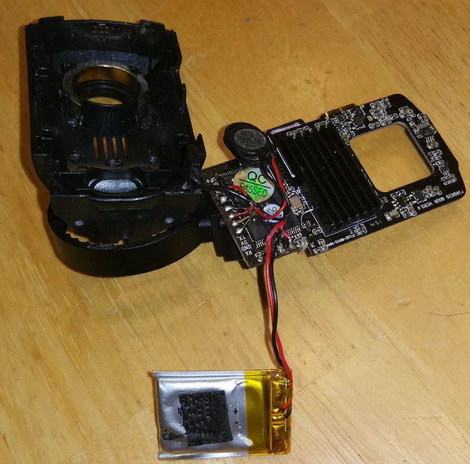

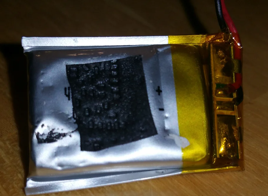

Partly on prompting from RM, I just swapped my battery. It took <10 min.
It sure looks like the original battery was punctured/crushed during the assembly.
I went ahead an ordered 4 more batteries (for USD15.00) from China. Now that I've done that, I'll never need them again (cheap insurance, as I see it).
The replacement battery was low, and even indicated "low battery" but still stayed on for at least a minute (which passes the 5 seconds of run time of the original after full charge). I've got it charging now, but suspect this will be the end of this unit's flakiness.
erkme73, do you think there's enough room to install some small connectors so you don't have to re-solder the wires every time a battery needs to be replaced?
Internally, doubtful. Just keep in mind that baring some premature failure, you should get at least a year (or more) of service life from the batteries. Chance are, by the time the next one fails, it'll be time to upgrade the camera to the latest version.
The soldering is not difficult. The terminals to which the wires are soldered are large, and easy to get to with even a standard soldering iron. You have to have steady hands and decent eyes.
Trickier was getting the two internal boards to separate. There are three multi-pin harnesses keeping them together. While technically I think you can replace the battery w/o separating them, it's easier to get the new battery installed (especially if you're applying adhesive (double-stick tape in my case) to the new battery. Pulling the boards apart has to be done methodically and slowly so as not to stress any one of the harnesses too much. Sounds daunting, but if you take your time, and go slow, it's no challenge.
