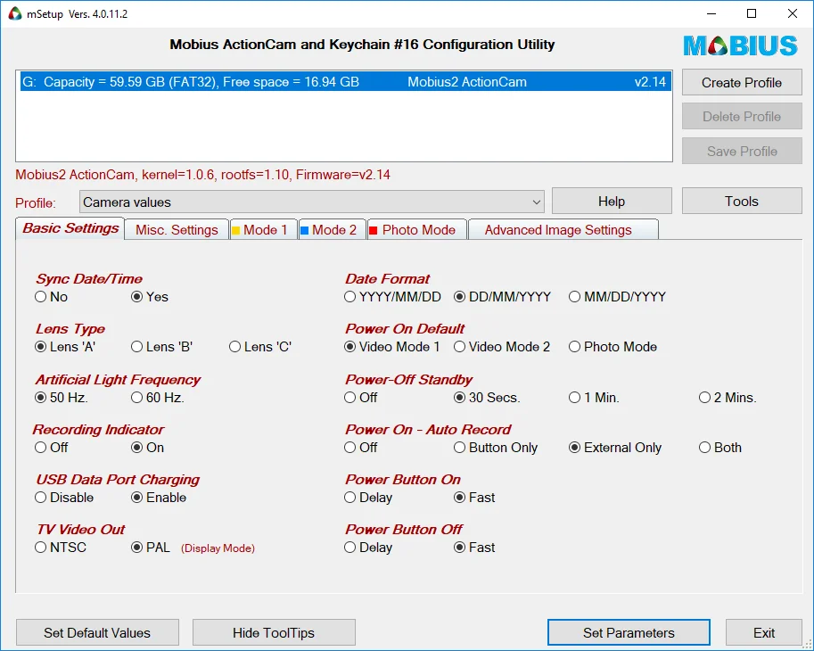

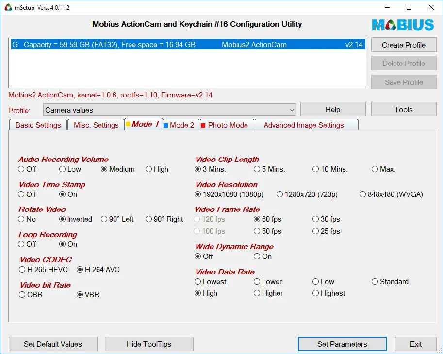

Welcome to DCT @Kalahara. I'll post some screenshots tonight of the configuration I've used for my M2 testing.

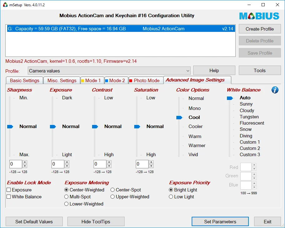

This is my current M2 configuration that I used throughout testing the recent Firmware 2.14 update. Feel free to use this as a starting point for your own camera. The position in the car, plus the car colour and amount of internal reflection will vary from one setup to another, so you may get better results by fine-tuning some of the parameters. I have not included the Misc Settings or Photo Mode screens as I do not use these functions on the M2.

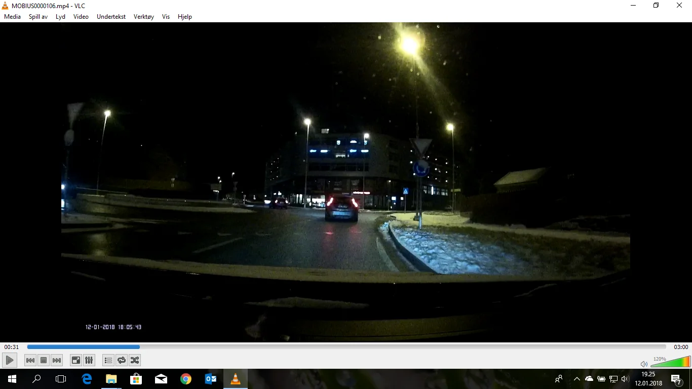

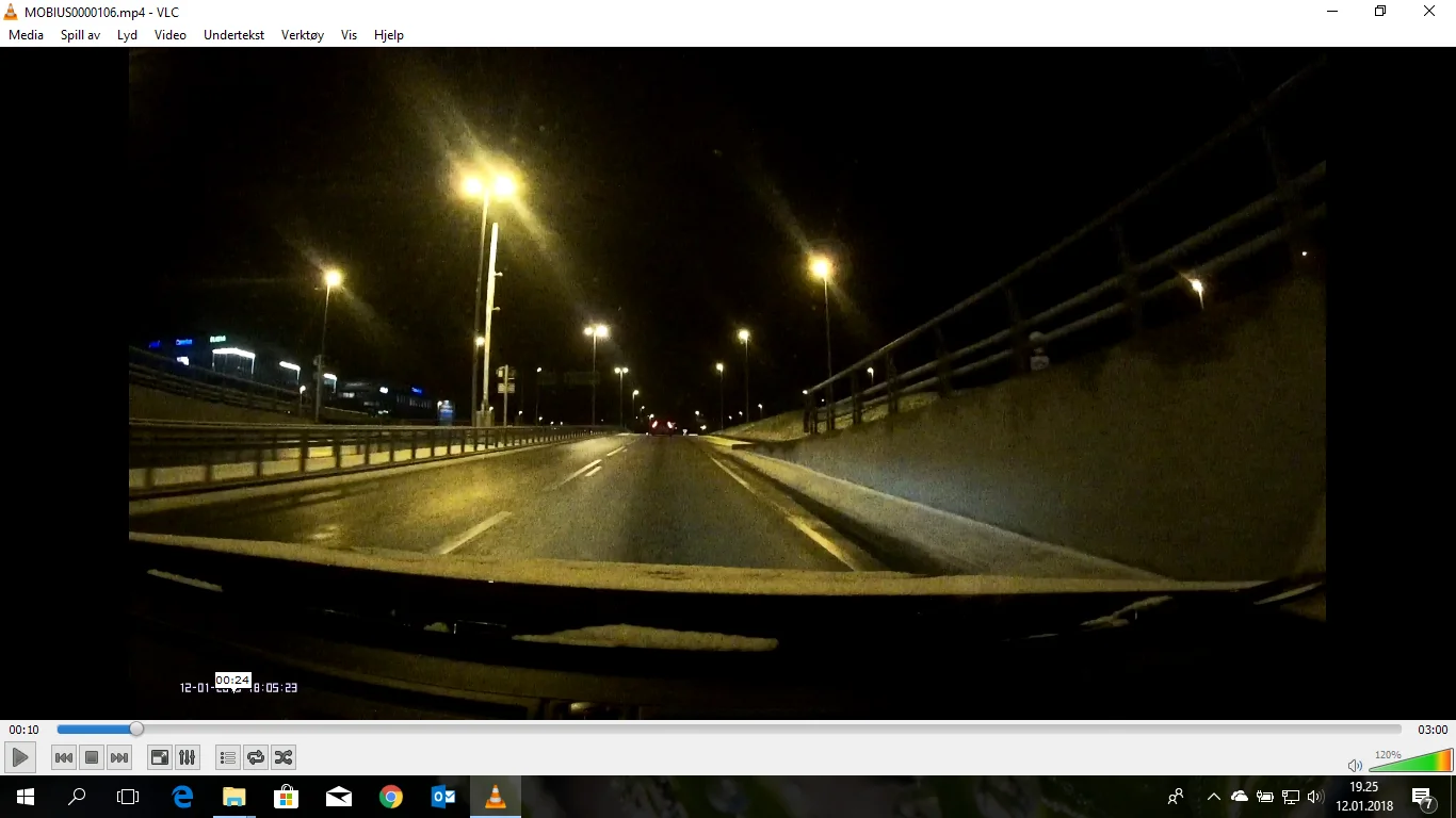

Hi TonyM,

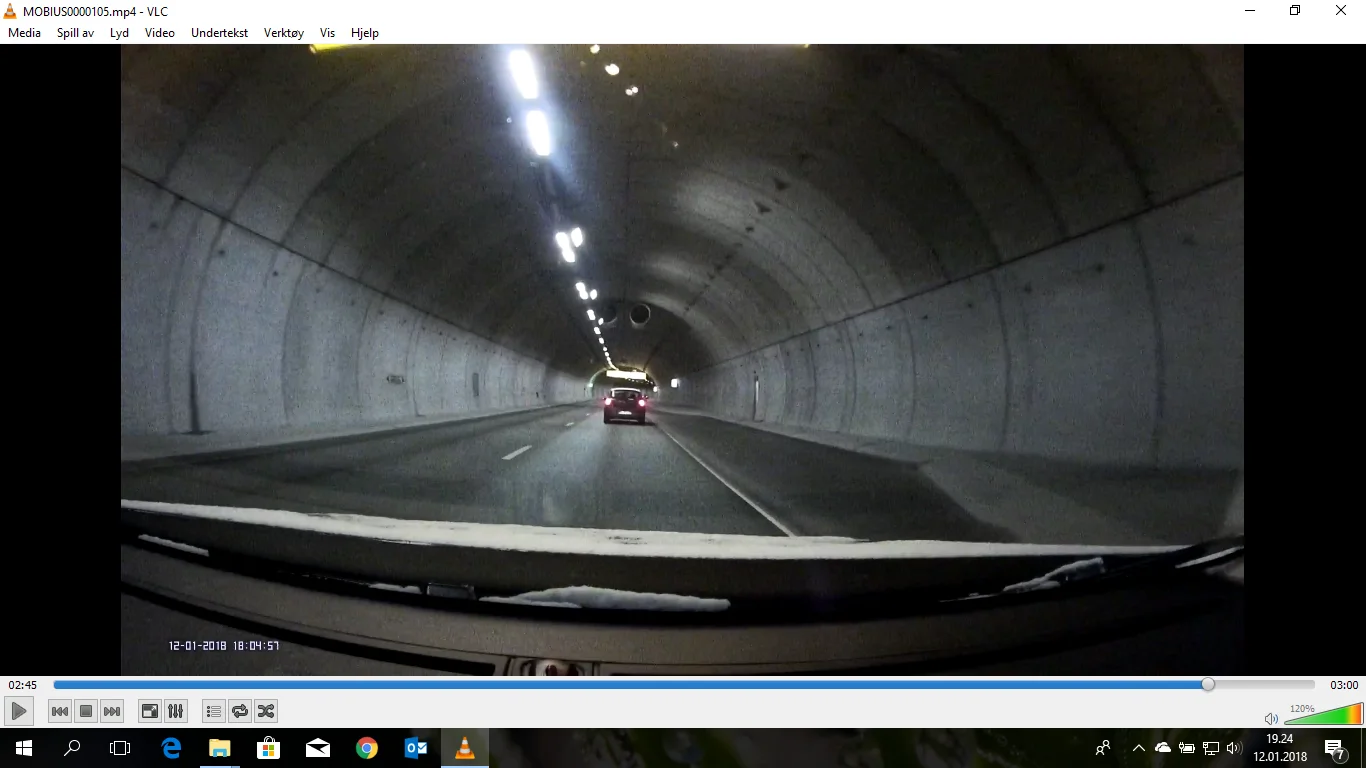

Used your tip for configuration and here is the result from when i was driving home after work. As you see it`s very dark outside with some snow in the air, but i thought the images was pretty good after all. The pictures became a little more grainy when using screen capture on the computer. WDR was off in the configuration.
Watching the recordings on the computer was realy uplifting. Daylight test next. Thanks for your support so far! 👍

I'm using similar configuration as TonyM's one. Except below changes,
Mode 1 > Video Frame Rate > 30 fps
Video Data Rate > Highest
Advanced Image Settings > Sharpness > 60
Exposure > -35
Color Options > Warmer
White Balance > Snow
Exposure Metering > Center Spot
It did reduce a lot grainy at night.

Used your tip in addition to TonyM`s, but in my case it got more grainy when dark outside. I moved the camera around severeal times and the placement of the camera do have an a effect on the quality. Anyway, thanks for the tip 🙂

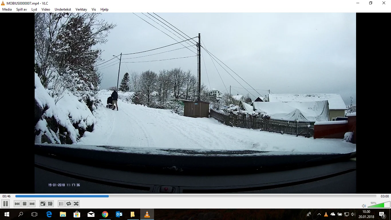

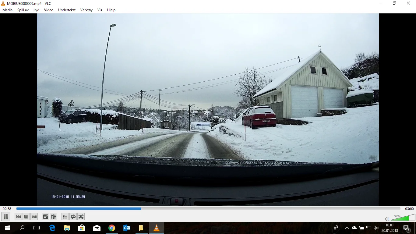

Hi,

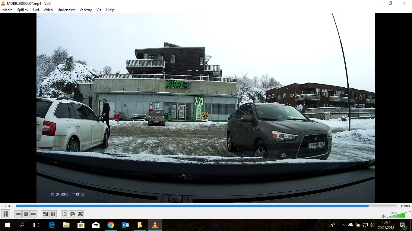

Some examples from daylight driving with the configuration above. The details are rather good i think.

I also noticed the Exposure Metering parameter do affect the night driving sence. I like the Center Sport which focus on the car at front.
After testing all the metering modes at length, I found that centre spot was often the best, although centre weighted is less sensitive to changes as each dark or light coloured car passes by.
