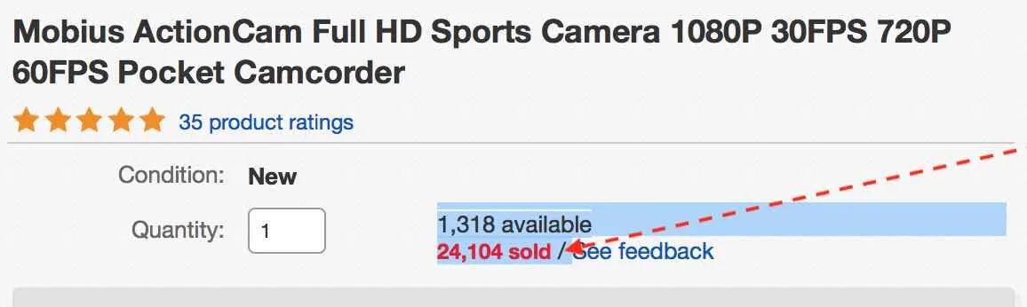

Oh, not a all, I am among them. But I am part of a minority, most people will just use the camera w/o playing, modding and stuff.
Most on the people "here" in this forum (and others such in Rcgroups) might like to tinker and use most of the stuff, but not most of those who purchase the cameras.
Unless you don't see them all over here...
The Mobius is a boutique enthusiast's camera, very different than any other typical consumer action cam. In fact, the camera was specifically developed for the FPV enthusiast, hence the AV connectivity. Tinkering with alternative lenses may be one thing but hooking it up to a monitor is a core aspect of the product. Also, the fact that it comes with a user focus-able lens implies that it needs to be connectable to an AV monitor or a computer, so a lot of users would certainly need or want that ability.
You can't reach such assumptions about how the buyers are using the cameras based on sales numbers alone, so I'm a little unclear what your graphic is supposed to be telling us.

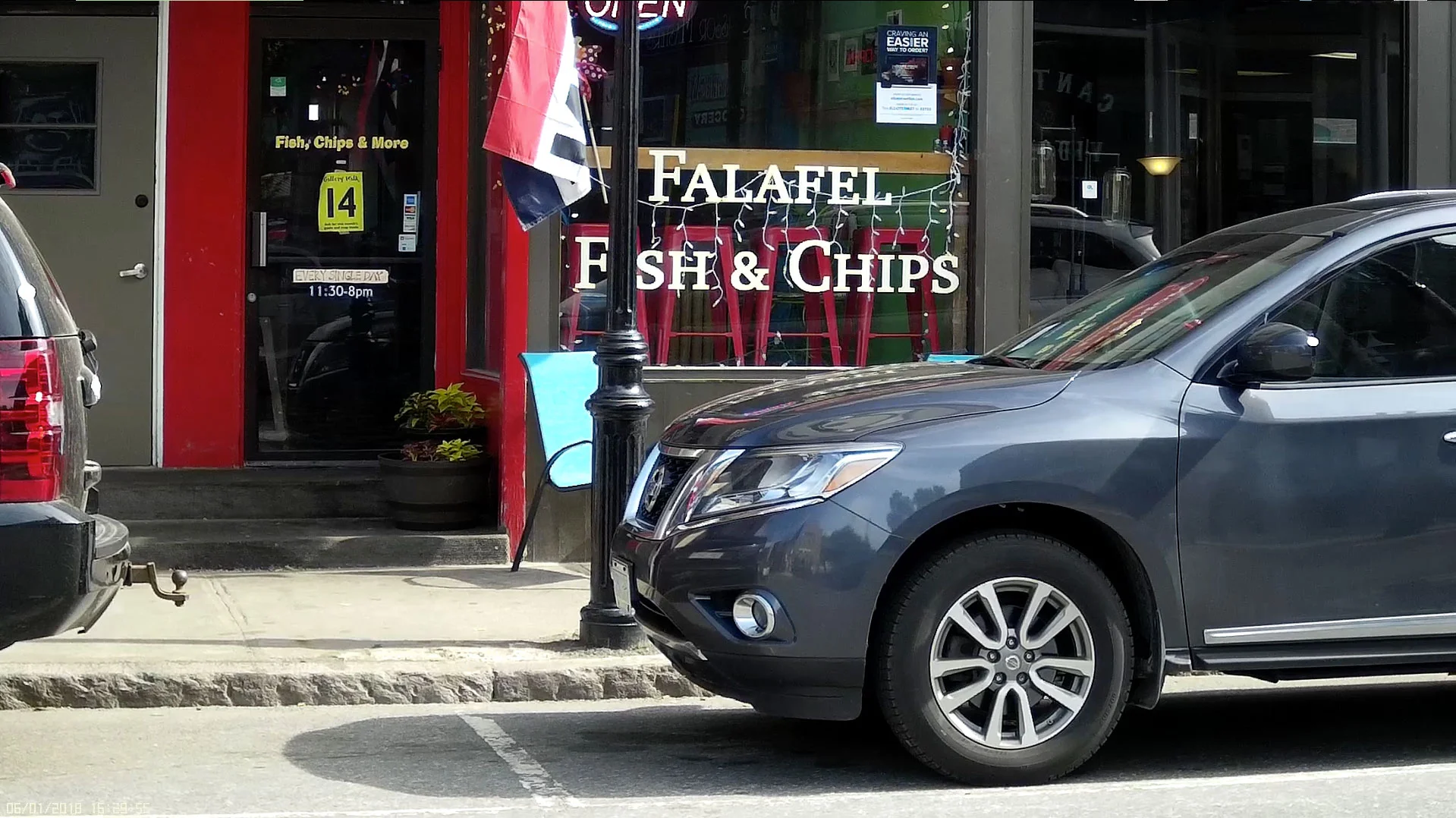

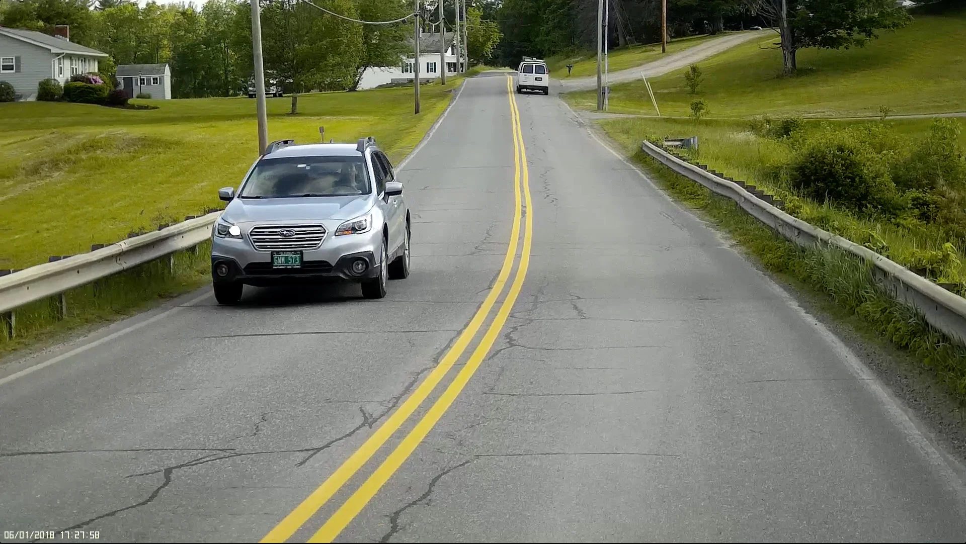

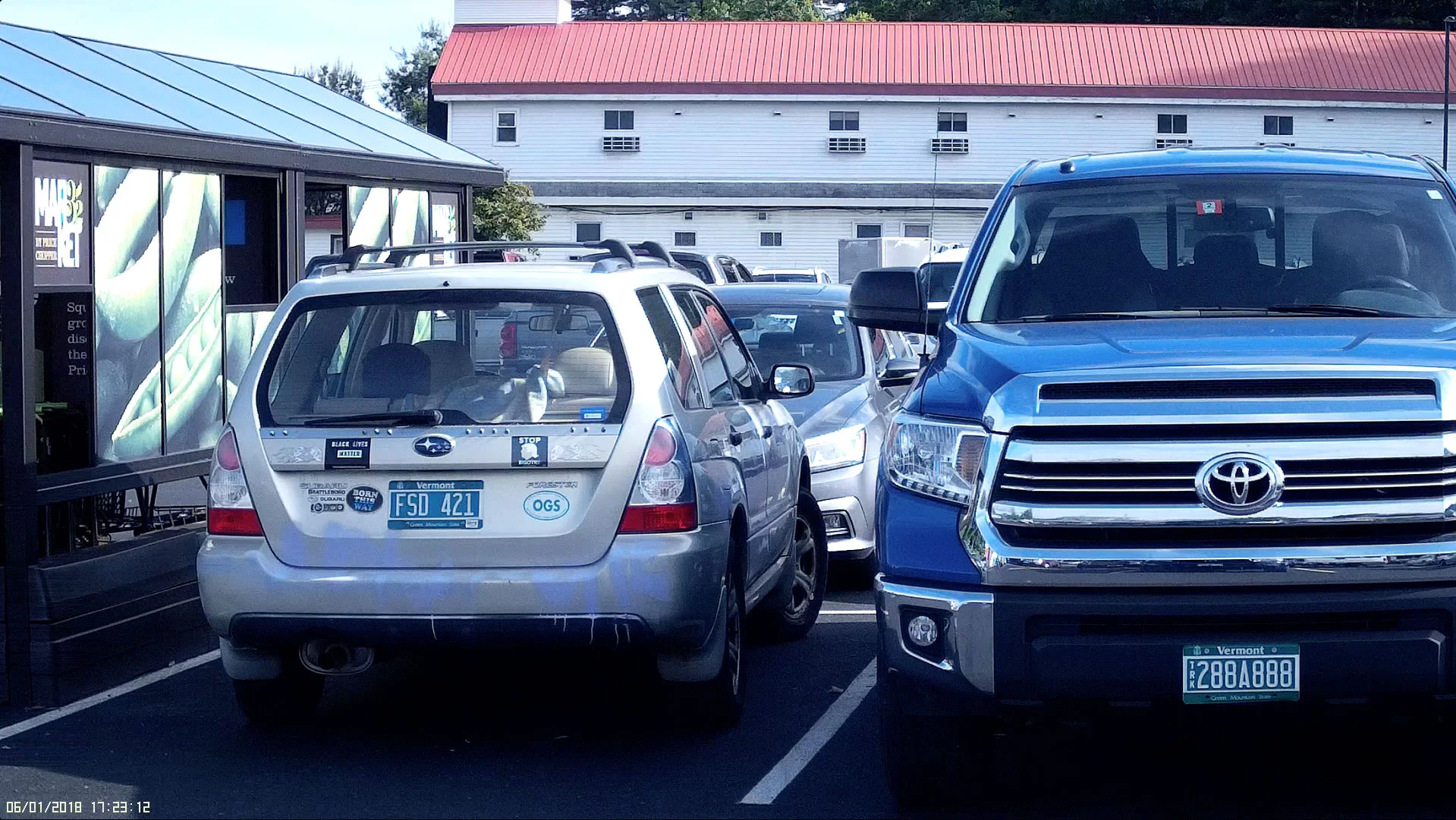

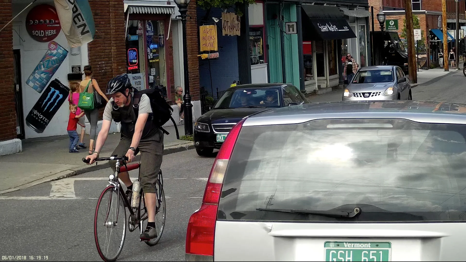

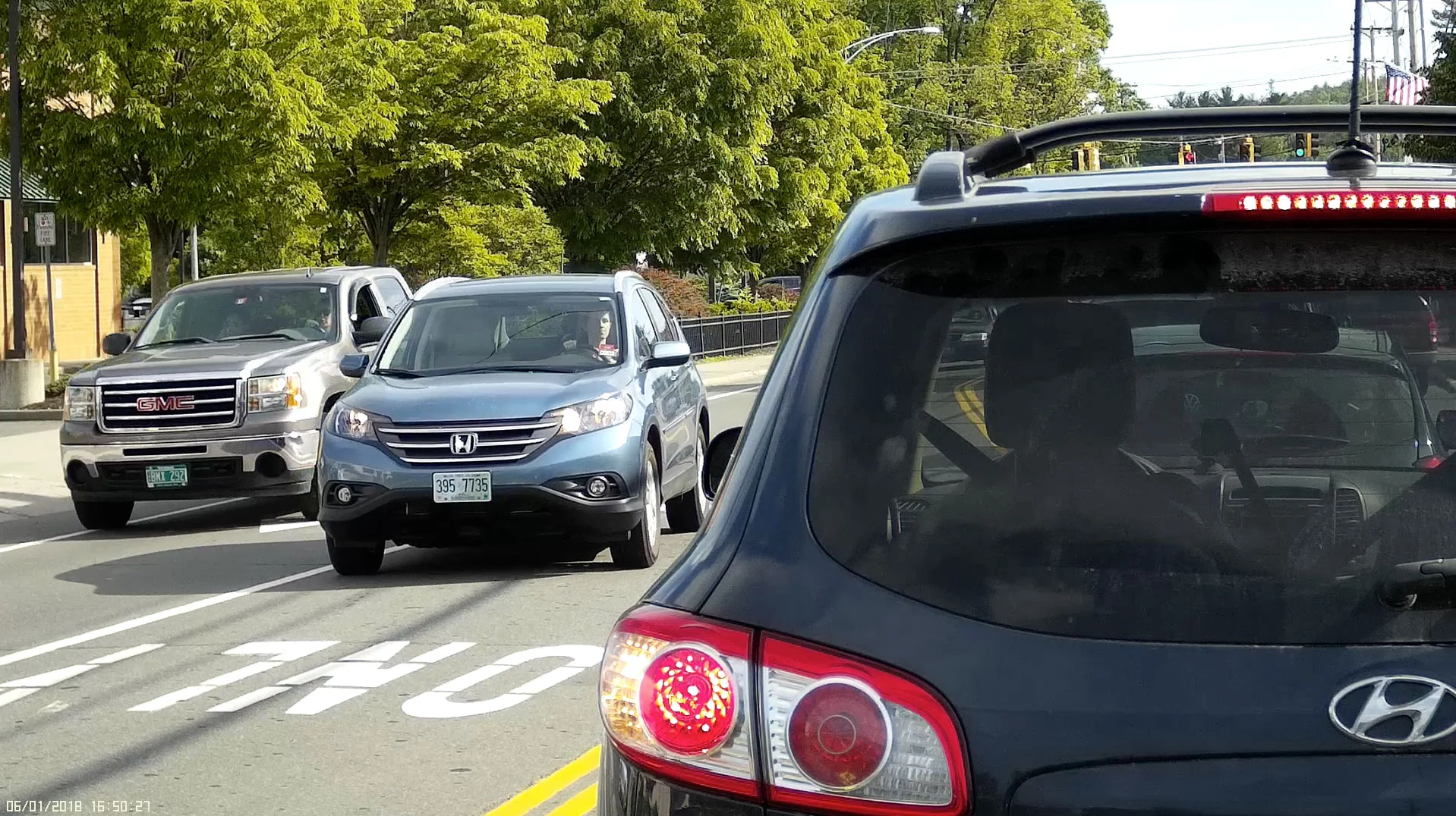

Lens profile "B"
So far, this appears to be an impressive lens! It blows the 2.8-12mm varifocal out of the water!
Depth of field is far better than anything I could achieve with the 2.8-12mm varifocal and the difference between the 3MP varifocal and this 5MP is quite remarkable. I was expecting the higher resolving power to make a difference but was not expecting anything quite this dramatic, especially given the sensor involved. Putting this lens on the new Maxi with its 2.7K sensor should prove interesting as this lens has got some chops! :joyful:
The interesting thing here is that I haven't had much time to fiddle with optimizing the camera settings. I basically replaced the 2.8-12mm lens with this one and ran with it, so further IQ tweaks are still possible.
Very good results and a good illustration of what I was saying above about the advantages of feeding a sensor with an image way above sensor resolution. This has been the finding for TV video for some time, although I'm not sure anyone has explained it scientifically (at least on an ordinary forum) yet. For some reason, downscaled images maintain some of the resolution / sharpness advantages of the higher resolution image and so are superior to a native image of the same lower resolution. Or in very plain English, there appear to be advantages to using a lens with a resolving power way above the sensor resolution.
I am extremely impressed by both the resolved detail and the depth of field in my first trials with this 6-22mm f1.6 varifocal lens.
The land rover in front of me is perhaps 20m away. The obelisk in the distance is 1.5 miles away.

These look great but the focus is just a bit off! You'll see as you become more familiar with using a varifocal lens on a dash cam that achieving optimal focus can be quite a challenge and a sometimes elusive target. It takes some experimentation to find the hyperfocal distance that works best so that you end up with the proper balance between near and distant focus. I think if you compare the 6-22mm traffic screen shots I posted to these with a critical eye, you'll see what I'm talking about. I haven't spoken much about my experiences focusing the varifocals but it's a topic worthy of some discussion here, that's for sure. These CCTV lenses were designed for static surveillance situations and using them in a dynamic environment such as on a dash cam presents a very different set of variables. This lens seems more forgiving than the 2.8-12mm lens when it comes to focusing but still requires tinkering. You'll see!......Have fun! 🤓
Well, I was already fairly happy with these initial results, although I noted that they were not quite as crisp as your examples, partly due to the overcast conditions with light rain. I'll certainly try to optimise the focus point over time.
