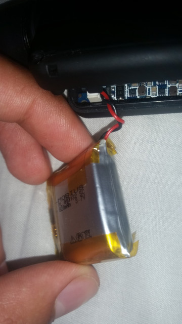

I have had a look the at battery (please find photos attached). I dont think it is swelled, as it feels firm to the touch - and I still get 2 hours recording when pressing the record button manually.

Your battery does look slightly swollen. It should be flat on each side not curved or rounded. Even if it still works you should consider replacing it. A swollen battery can put pressure on the buttons from behind and cause unexpected problems.
As I explained yesterday, you need to methodically eliminate each possible problem one by one.

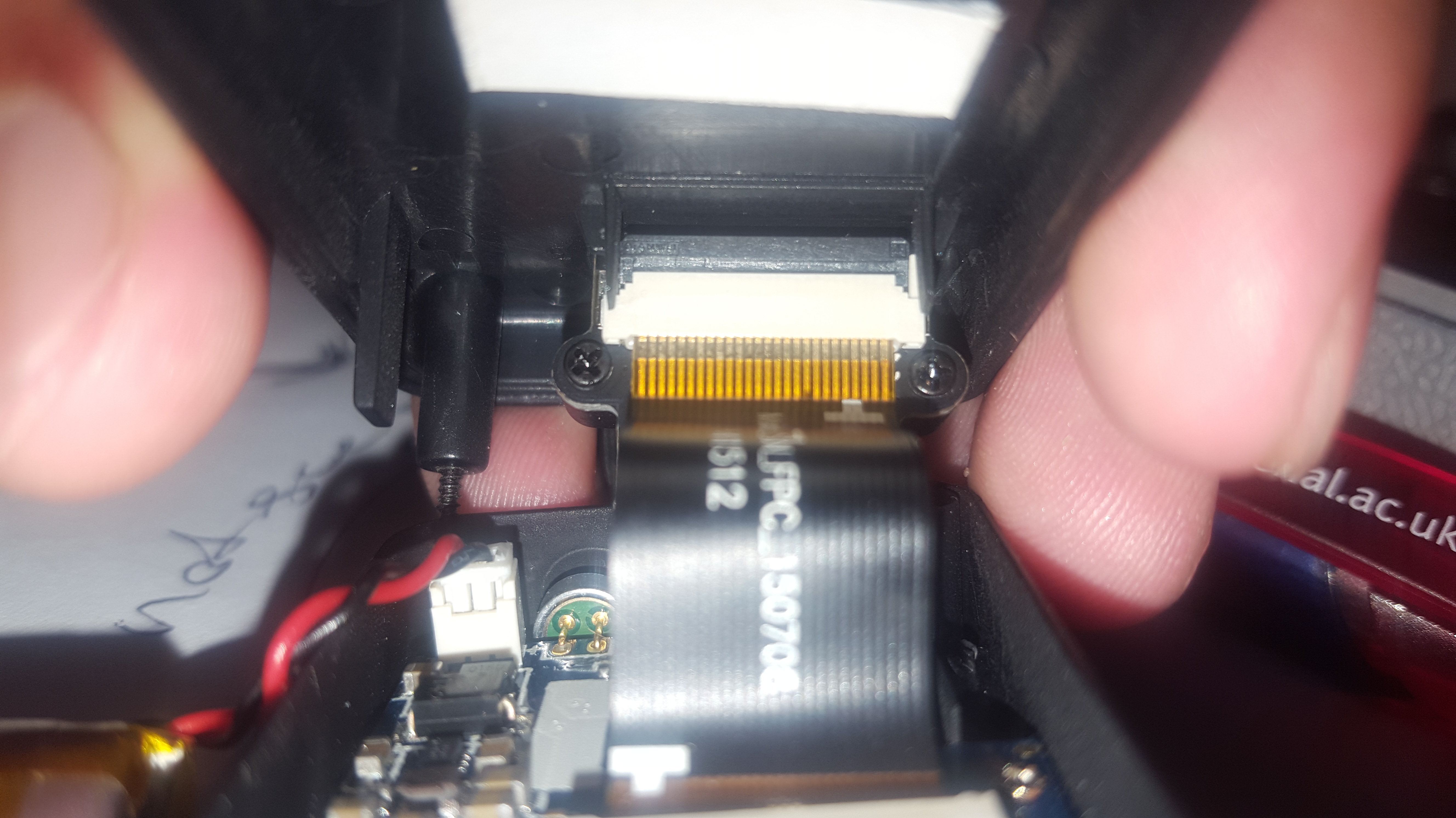

In the meantime try this: Open the camera and carefully remove and then reinstall the ribbon cable on the lens module making certain that it is fully seated in the ribbon connector slot. Then see if anything changes with your problem.
See the Mobius support page if you need help understanding how to remove and reinstalled the lens module.
@Dashmellow Alright, I will order a new battery from banggood. To see if it is the case- can I remove the battery, and plug in the USB. Will it turn on that way?
Also, find pictures of the camera ribbon cable on the top and bottom. They look seated fine as the camera was never opened. I have done a gentle push to make sure they are in place.
As the battery will come from china I will probably have to post back once it arrives. Is there anything else we can also try in the meanwhile?
Above, I specifically said, "Open the camera and carefully remove and then reinstall the ribbon cable on the lens module making certain that it is fully seated in the ribbon connector slot." "Pushing" won't do anything by itself.
Flip up the black ribbon locking mechanism. Remove the lens module and inspect the ribbon and module for any possible damage or deformation, especially to the pins. Then carefully insert the ribbon fully and re-lock the mechanism. Even if there is no visible problem you may simply need to make sure all the pins are making good contact. Be careful not to kink or otherwise damage the ribbon cable. Your battery seems to be working so you can still test the camera afterwards.
Alright, shall I disconnect the one on the motherboard, as there is also one connected onto the camera itself.
@Dashmellow @jokiin Hello guys. The battery arrived today, and I fitted it and it made no difference. The yellow light remains on when recieving external power. So now can rule out the battery and memory card. Next steps?
