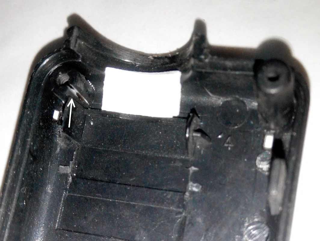

I don't know the spec of the screw. It is important to use the correct size screwdriver. I find a Phillips #00 size works well for the Mobius cases, and other camera cases too (Viofo, GitUp)
I did have one Maxi that was delivered with over-tightened screws - the heads were partially stripped. I was unable to undo them, so ended up breaking open the case and using a new one.
I think it came overtighten as well. So I broke it off and screwing one side only now; like the original mobius.
The original mobius case seems to have a flaw, one side of screw holder(what do you call that?) on the case seems to split easily.
The mobius maxi case is well made.

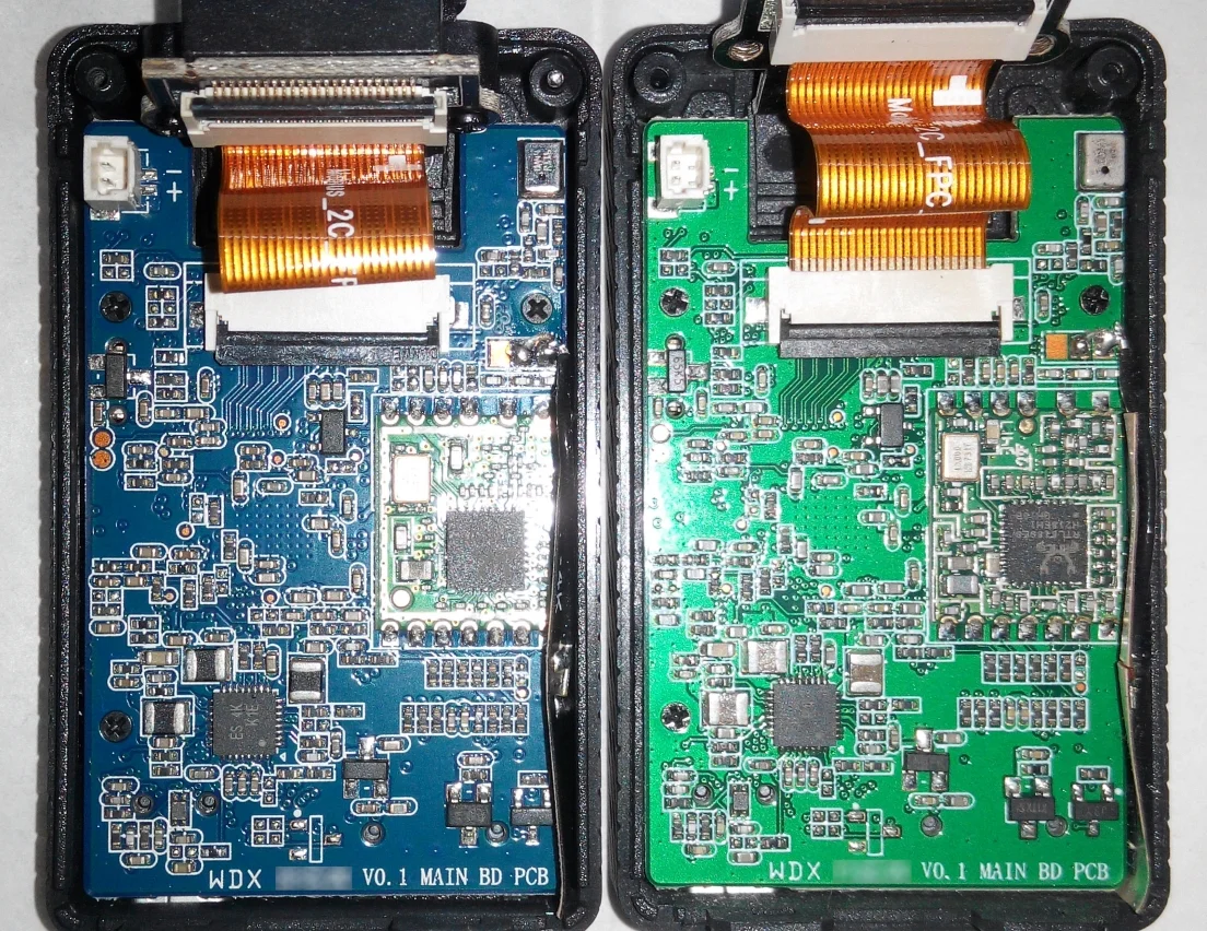

Are they starting to cut corners?
I don't know, hope it is an improvement.

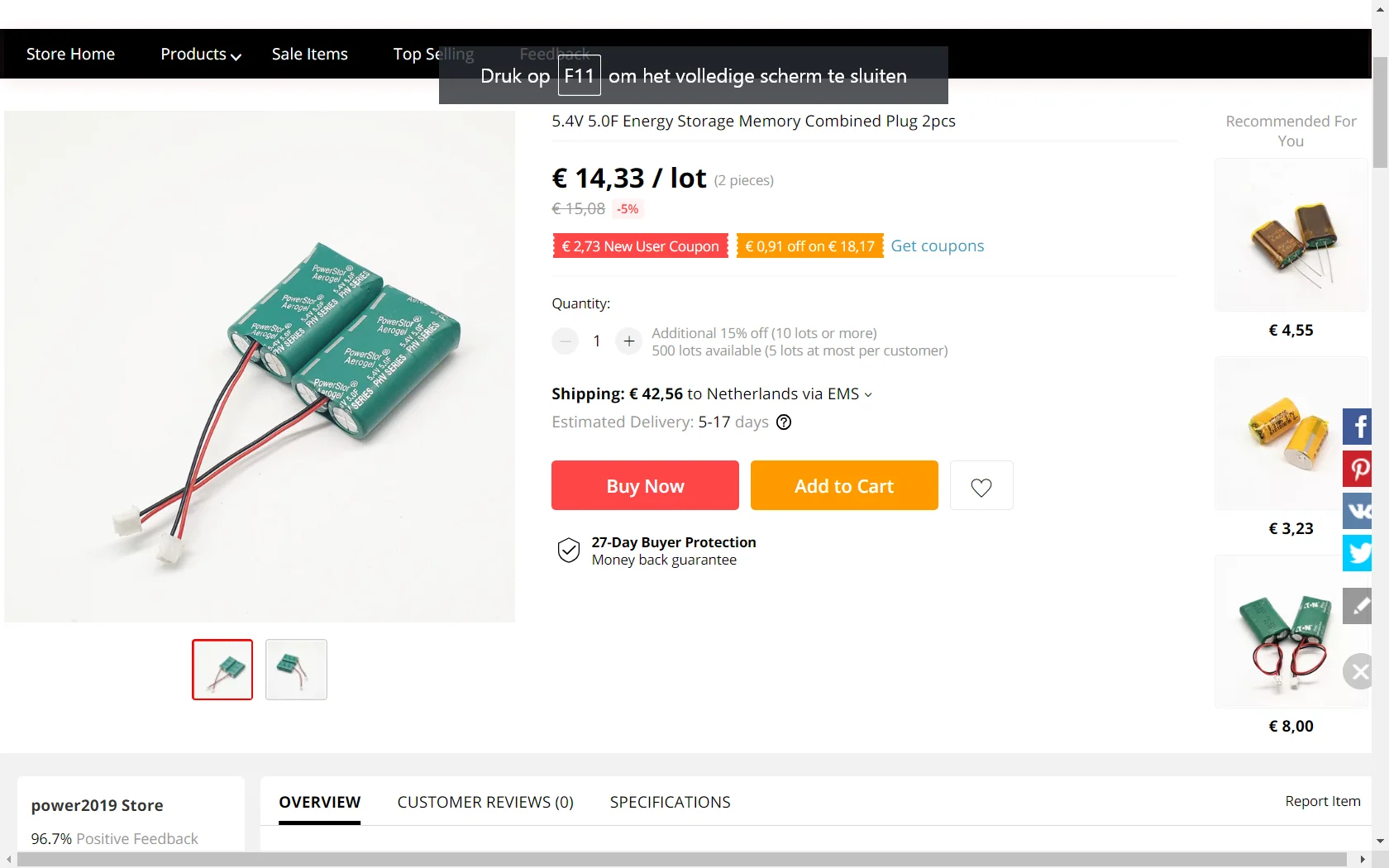

@dirkzelf Although Mobius do not list capacitors in their eletoponline365 online shop, they have advised me that you can send them an email to purchase a capacitor. I'm sure the cost will be a lot less than $42!!!
$42 that's because EMS shipping is selected, otherwise FREE SHIPPING (of course, longer delivery time)
yeah obviously, but when ordering I don't get the choice, it's EMS only....
Well, that was the same object (not sure the same vendor) but I HAD the choice to choose free shipping.
That's for 4 sets.... 20 bucs, then I get "free" shipping - sorry man, that's just an annoying pushy selling technique.... I don't like that at all...
Of course that's not your fault, but I can't find any free shipping for 1 pce.
