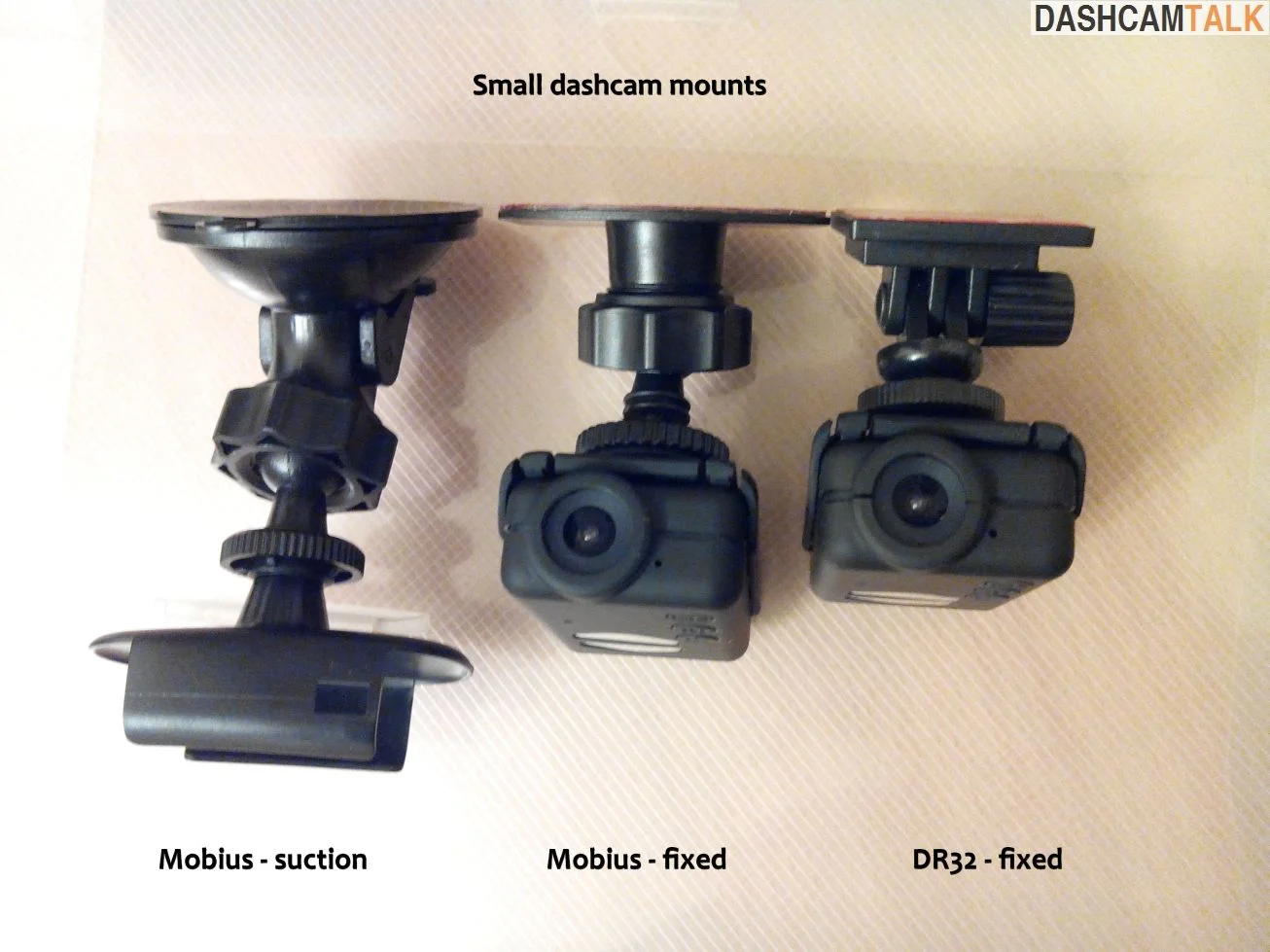

The last mount ( left one ) DR32, 808, I think is most practical.
I tried Mobius other two on some cars with more vertical wind-shield and could not adjust angle write, because ball-joint does not give that much space.
For busses, trucks, etc. , with almost vertical ( closer to 90 degree ) wind-shield angle, DR32 bracket would fit best.
The lack of angle adjustment put me off of the ball-joint attachment also..

The mount from right from my previous pictures (DR32) have quick-release.
You can put the screws part in any position because there is a square, not a rectangle.
Small dashcam mount.jpg Smallest dashcam mount.jpg Smallest dashcam mount with quick release.jpg
I don't know how good is the 3M tape to resist for many unmounts. But also the Mobius have an quick release. But to be "quick" the two bumps must to be adjusted by cutting.

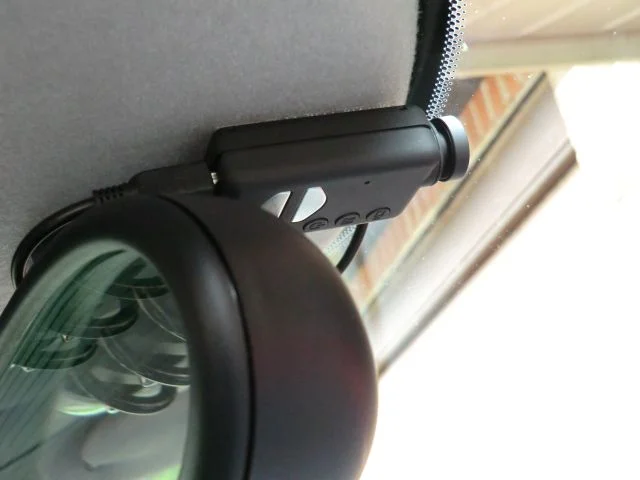

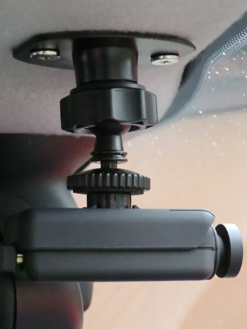

I initially fixed my Mobius to the headlining using 3M Dual Lock Reclosable Tape SJ4570. The inability to aim the camera optimally, & the weakness of the bond with the headlining material made this location impractical.
I moved it to the top of the rear view mirror. Again, the inability to aim the camera optimally made this location impractical.
Now I've mounted it as shown below. I would have preferred to attach the mount to the back of the rear view mirror, however, insufficient articulation in the ball & socket joint made this impossible.
The mount is supplied with 3M VHB tape attached. I doubted that it would stay fixed to the headling long-term, so I used two self-tapping screws as well. Seems firmly affixed.
If anyone wants the same mount, I bought it from E-Prance. Paid US $3.20 delivered (minimum order 2) = $6.40 total Weight 29 grams each. From China to UK took 13 days.
I like more your first picture mount if the windshield wipers are cleaning that top most area. In that position using the radar detector mount idea could be better.
I will never sacrifice the best position of a dashcam just to use a ball mount.
If still want a screw type mount you can search for the DR32 type which was presented on the first page of this topic.

I like the DR32 type mount, however, it lacks the articulation I wanted. Fine for setting the 'angle of dangle', but basically adjustable in only one plane ... if that's the correct terminology.
My current mount isn't necessarily the final solution. Still thinking about possible alternatives. One thing I won't do is attach it to the windscreen ... I have an aversion to things stuck to the windscreen.
