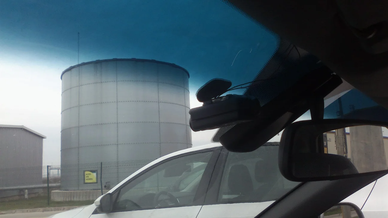

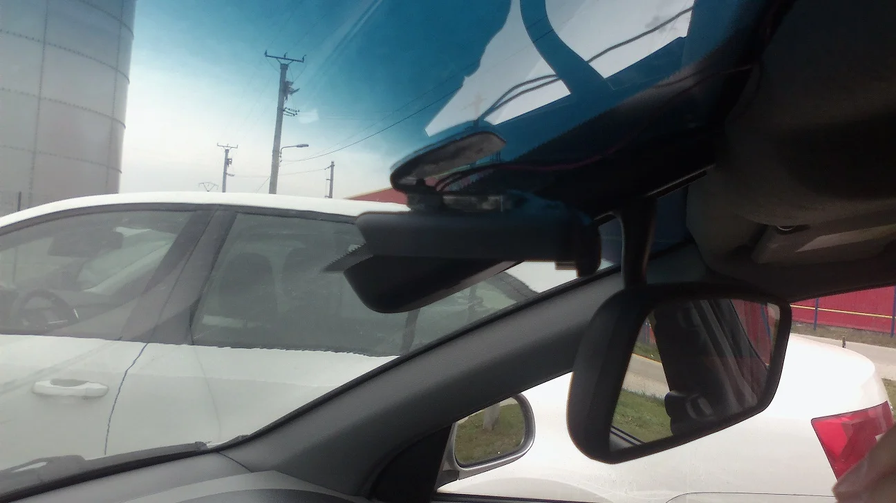

Mine is pretty well hidden under the mirror, so I never unmounted it yet, but I have it only for 2 weeks. However, I'm planning to use the extenstion cable for a more stealthy mount. FW updates or changes in configuration will be pretty rare, so I'll do them in the car with the laptop. If I need a file, I'll take it either by connecting the Mobius to the phone, either by taking the card out.

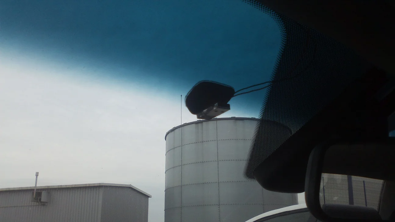

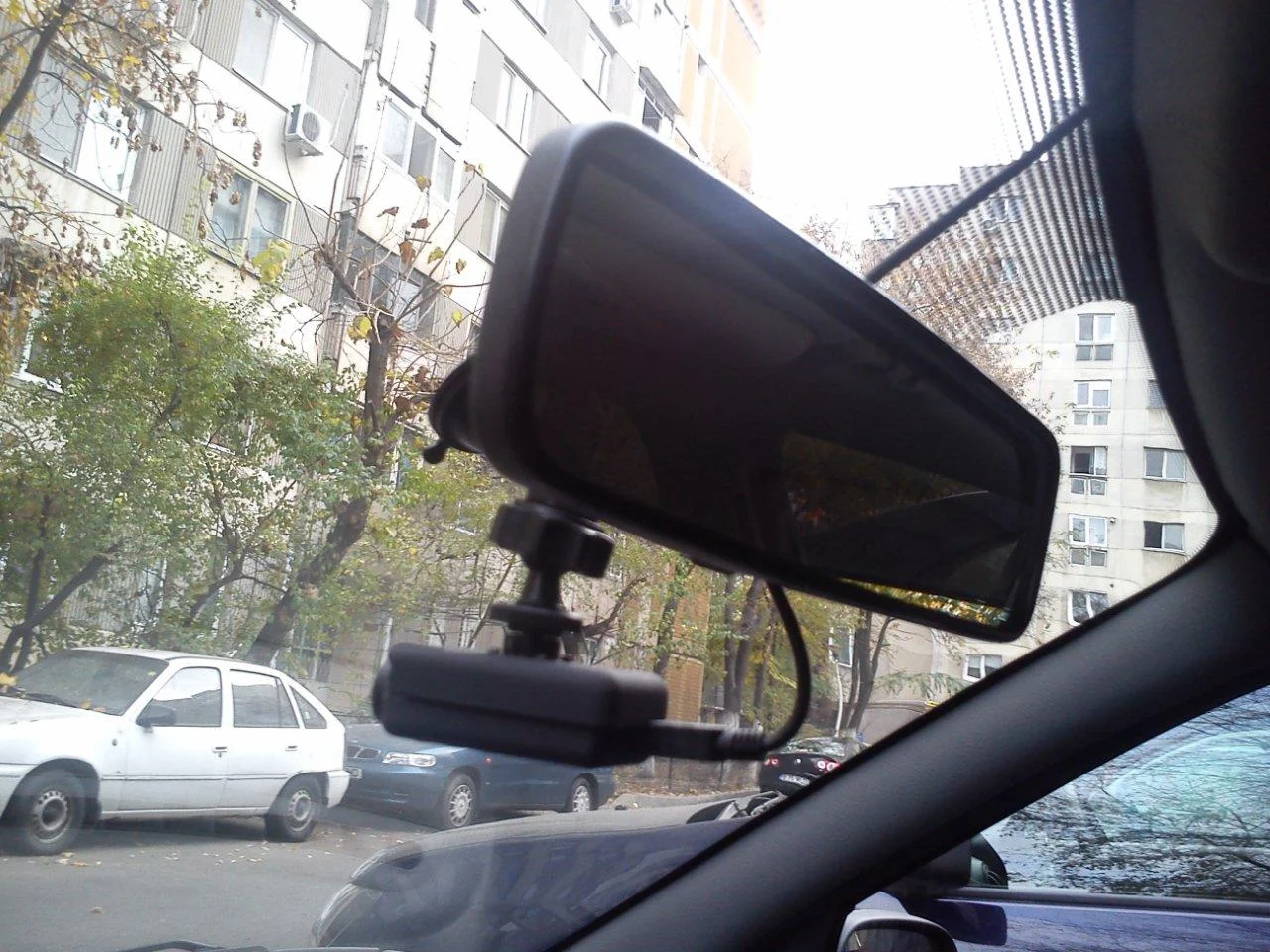

As a mounting solution, as long as I cannot leave the camera mounted permanently, at least I managed to have the 3m power cable placed in the car + the suction cup.
Not that happy with the fact that I have to screw the camera everytime ...but at least I don't risk that much.

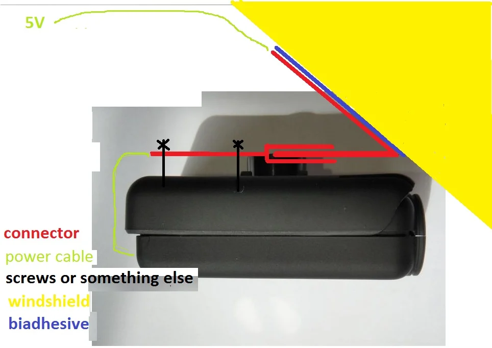

Will post step by step pictures like i did earlier then you see solution. In words it hard to explain.
Can you post at least a drawing about your idea?

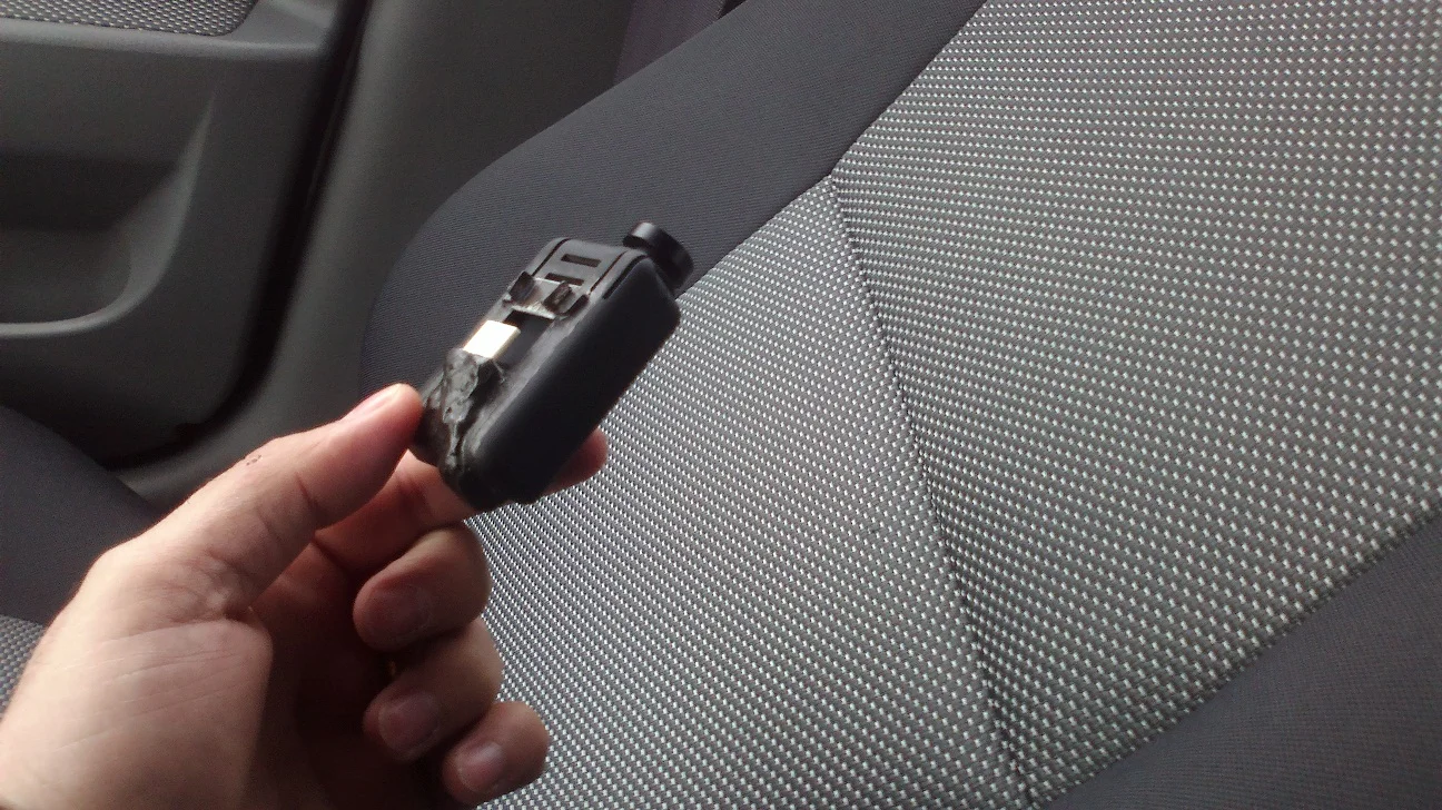

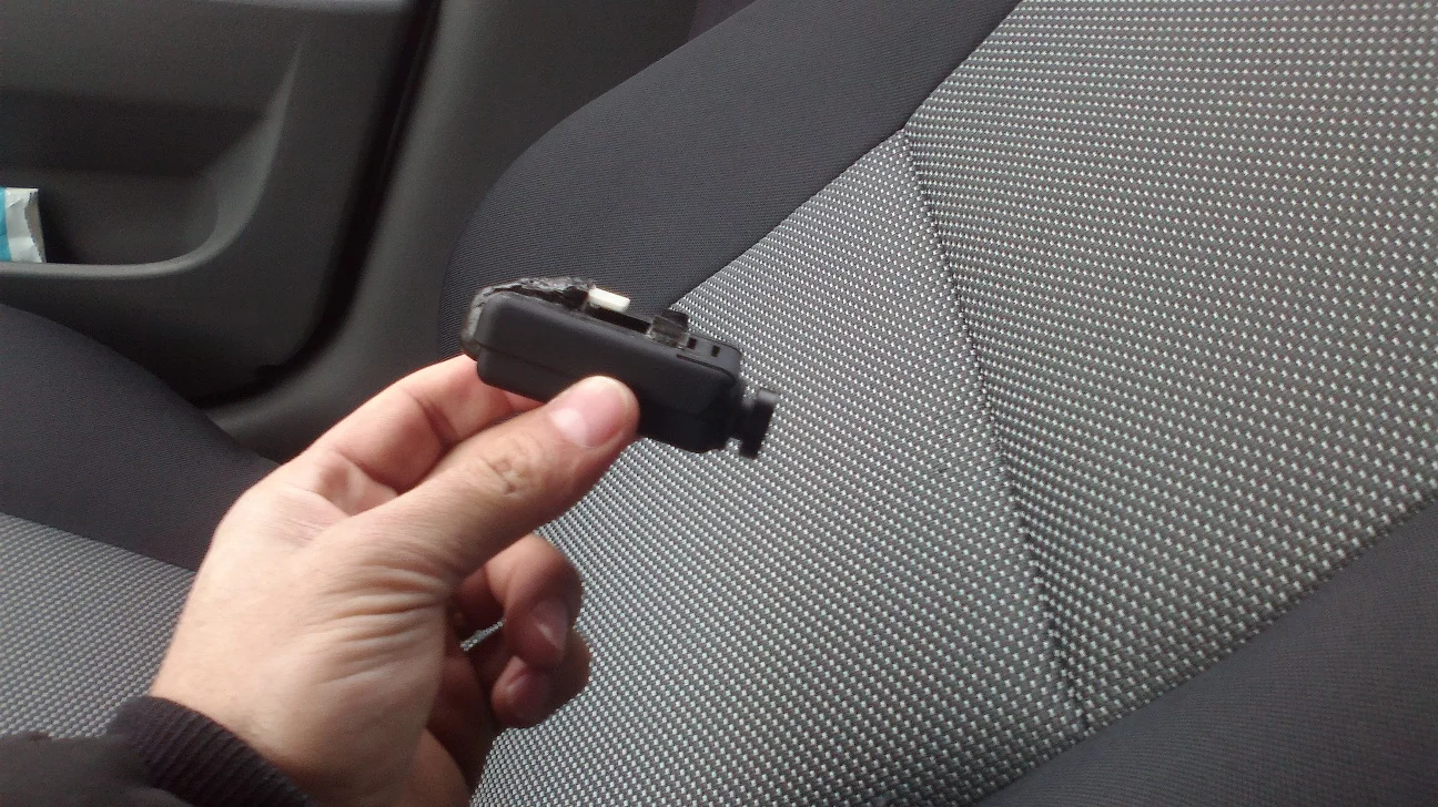

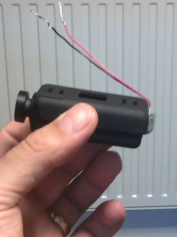

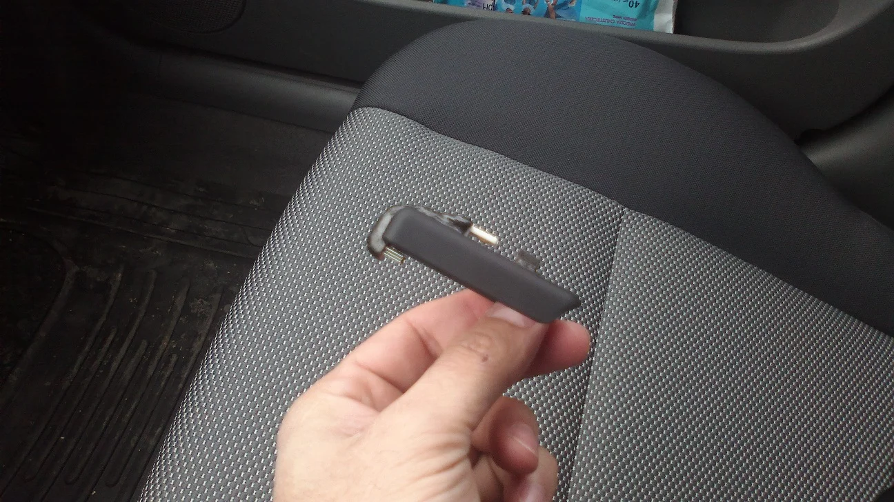

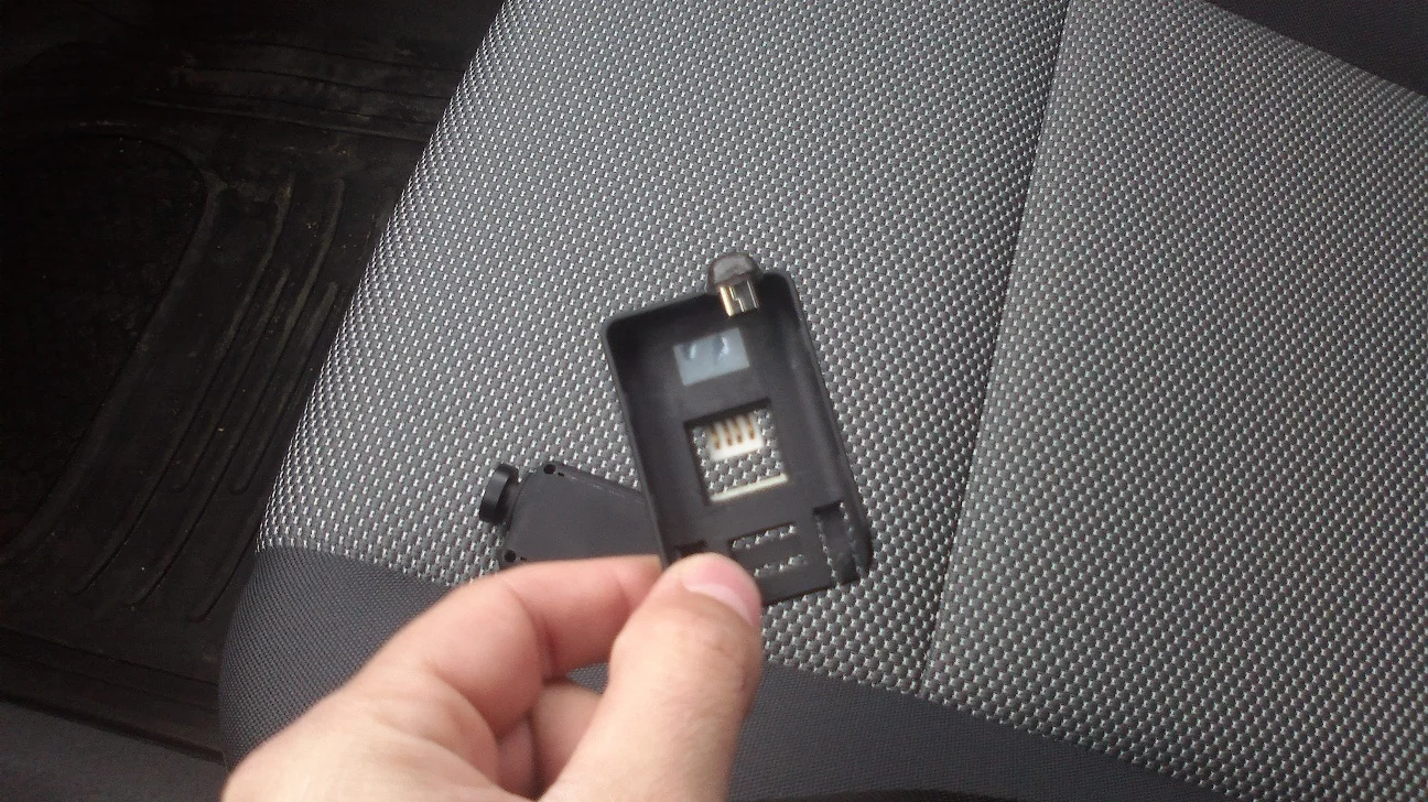

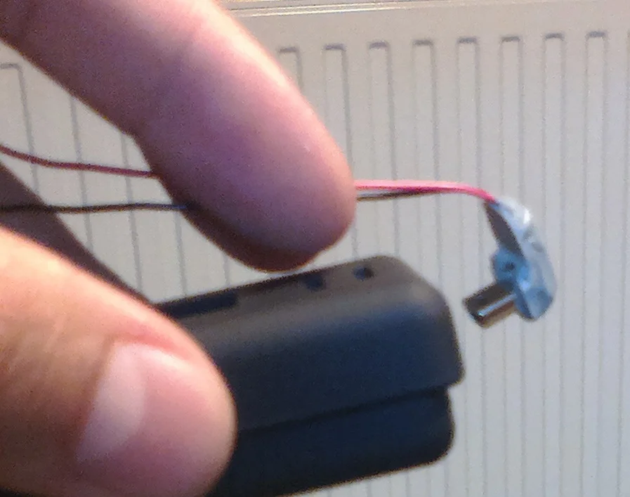

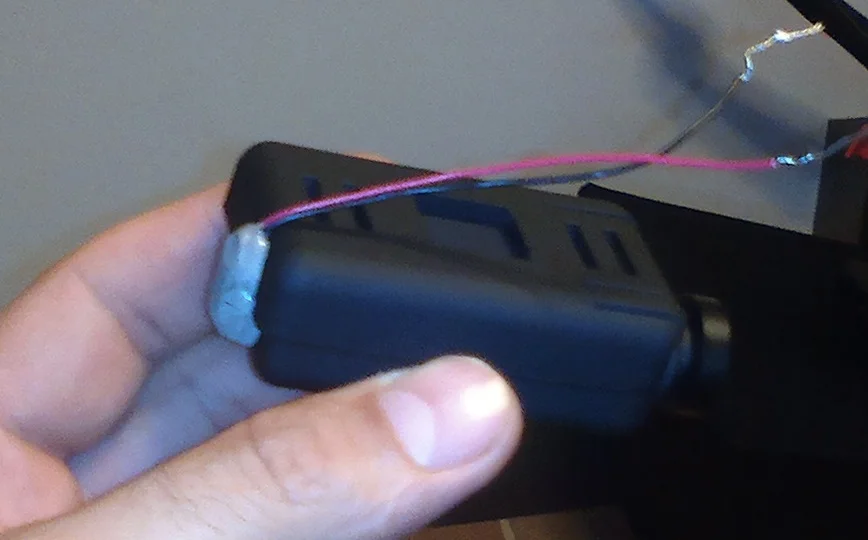

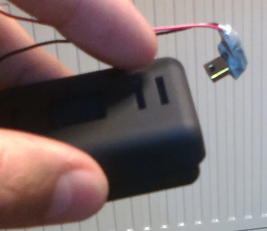

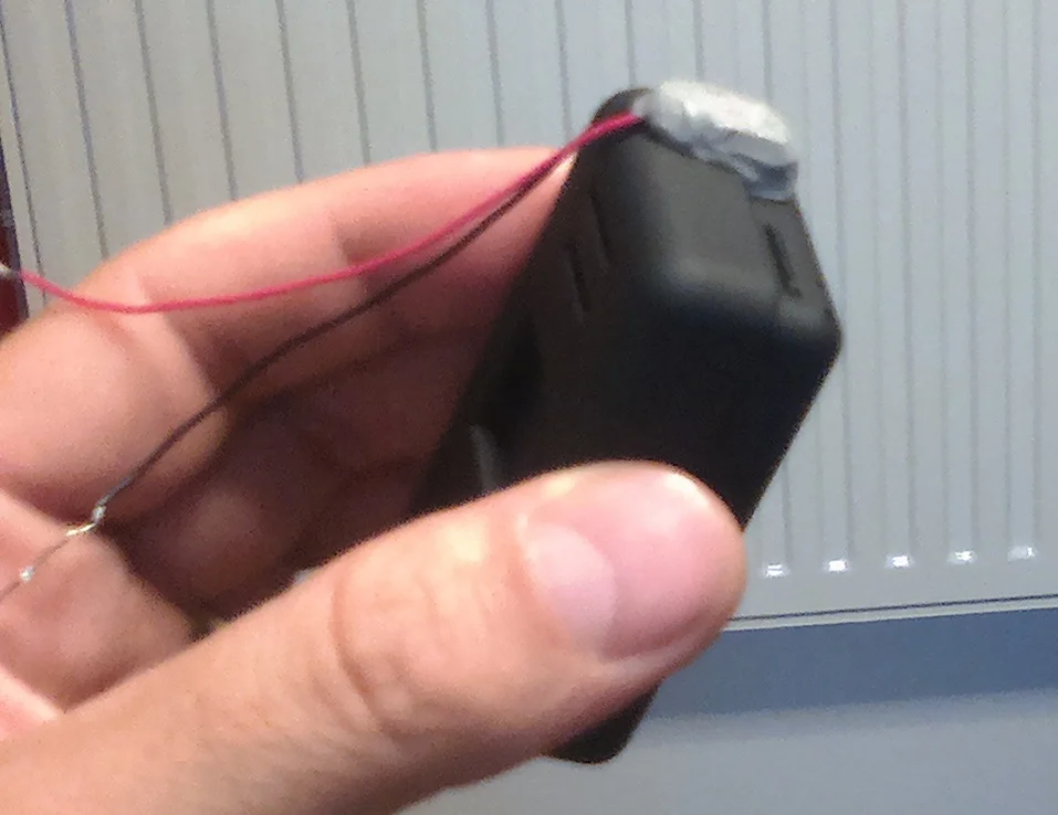

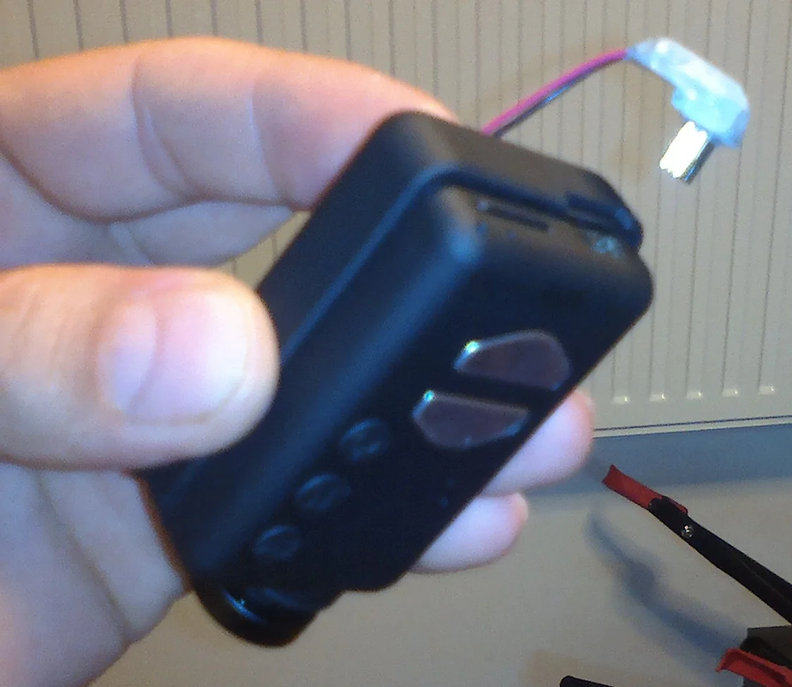

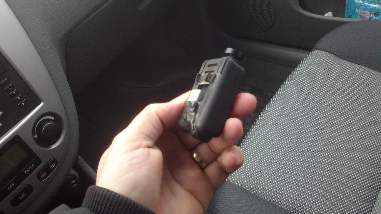

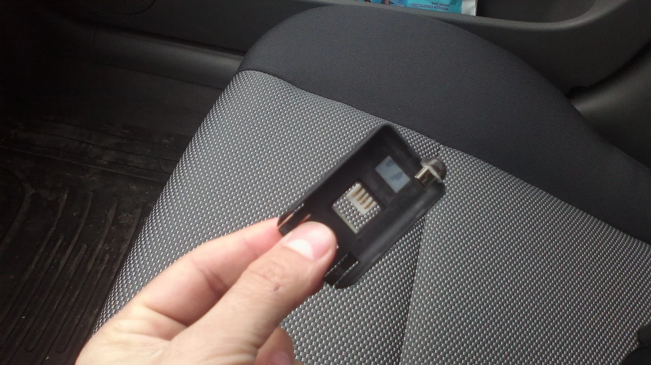

I got my camera this week and now I try to make the mounting system. Here is what I did so far(mini-USB with power cable):
Connector.webpConnector1.webpConnector2.webpConnector3.webpConnector4.webpConnector5.webpConnector6.webp
Originally, I wanted to connect the wires directly into the camera, but then I changed my mind. So I will not touch the camera. Plan was to use a connector like in here:
But I do not know what connector to use. Any ideas? I was thinking about USB, but I think that it is not so strong connection.
@niko -> what type of connector are you thinking about?
  • Like
Reactions: Adi

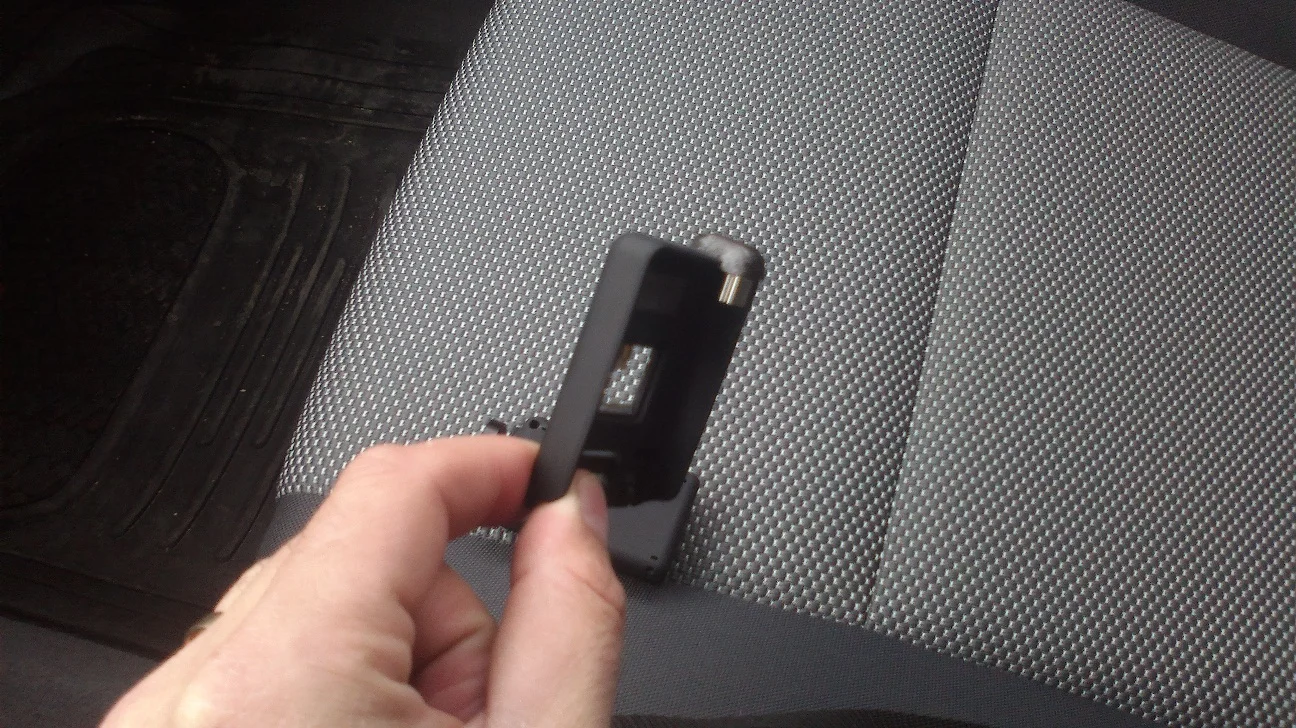

...and the "one-move" mounting system is ready. The finishing does not look so nice; I was focusing more on the mounting way.
Power is connected to interior lights -> the charger is hidden in between textile material and metal.

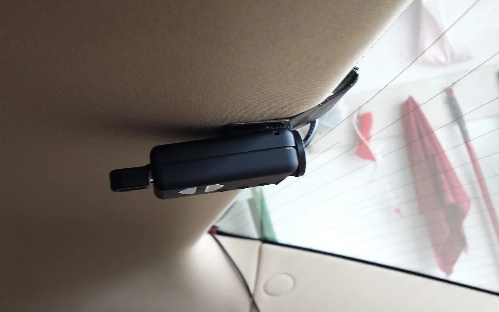

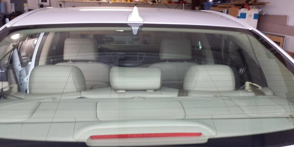

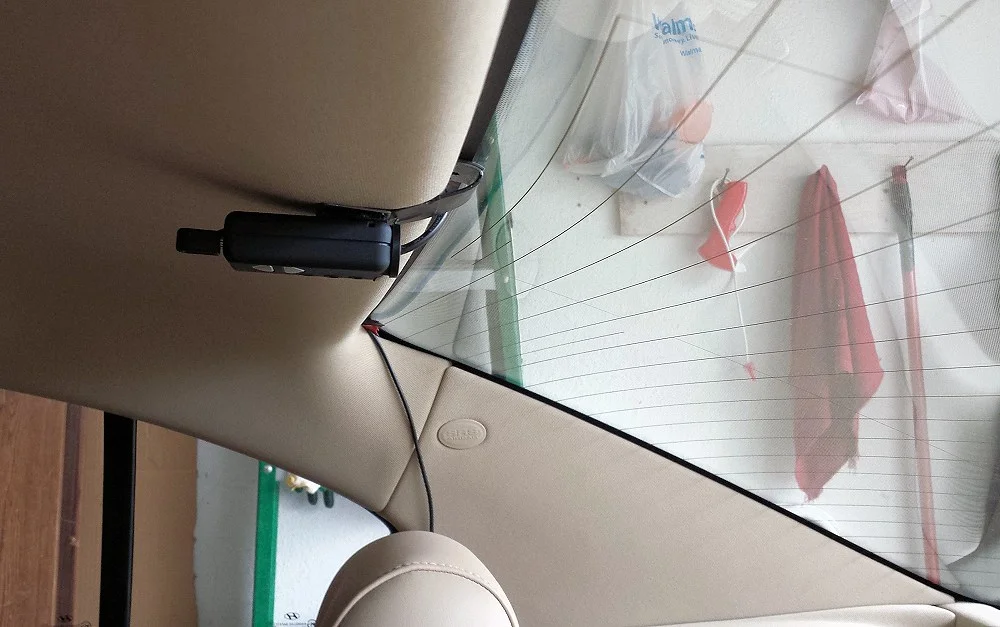

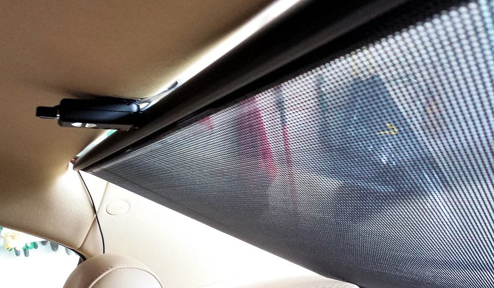

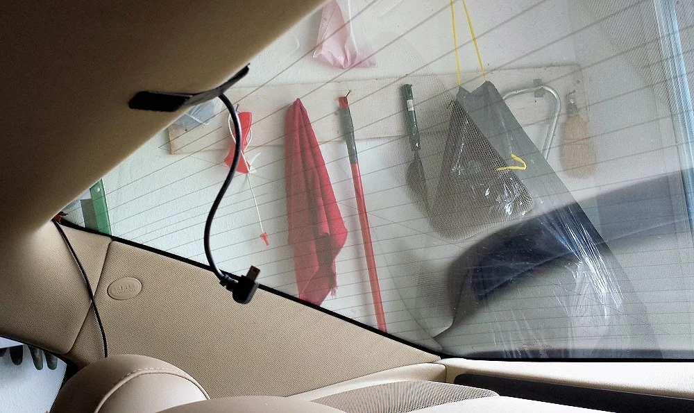

Here is my mounting solution for the rear windshield.
@MozartMan -> any problems with vibrations affecting the video?
No. That mounting bracket that slides between windshield and headlining is actually attached to the windshield with the stripe of double-sided 3M tape, so it holds very sturdy. And I used Velcro that came with the cam to attached it to the bracket.
Nice job. How long is the USB wire you used and where is it connected to? Thanks in advance πŸ™‚

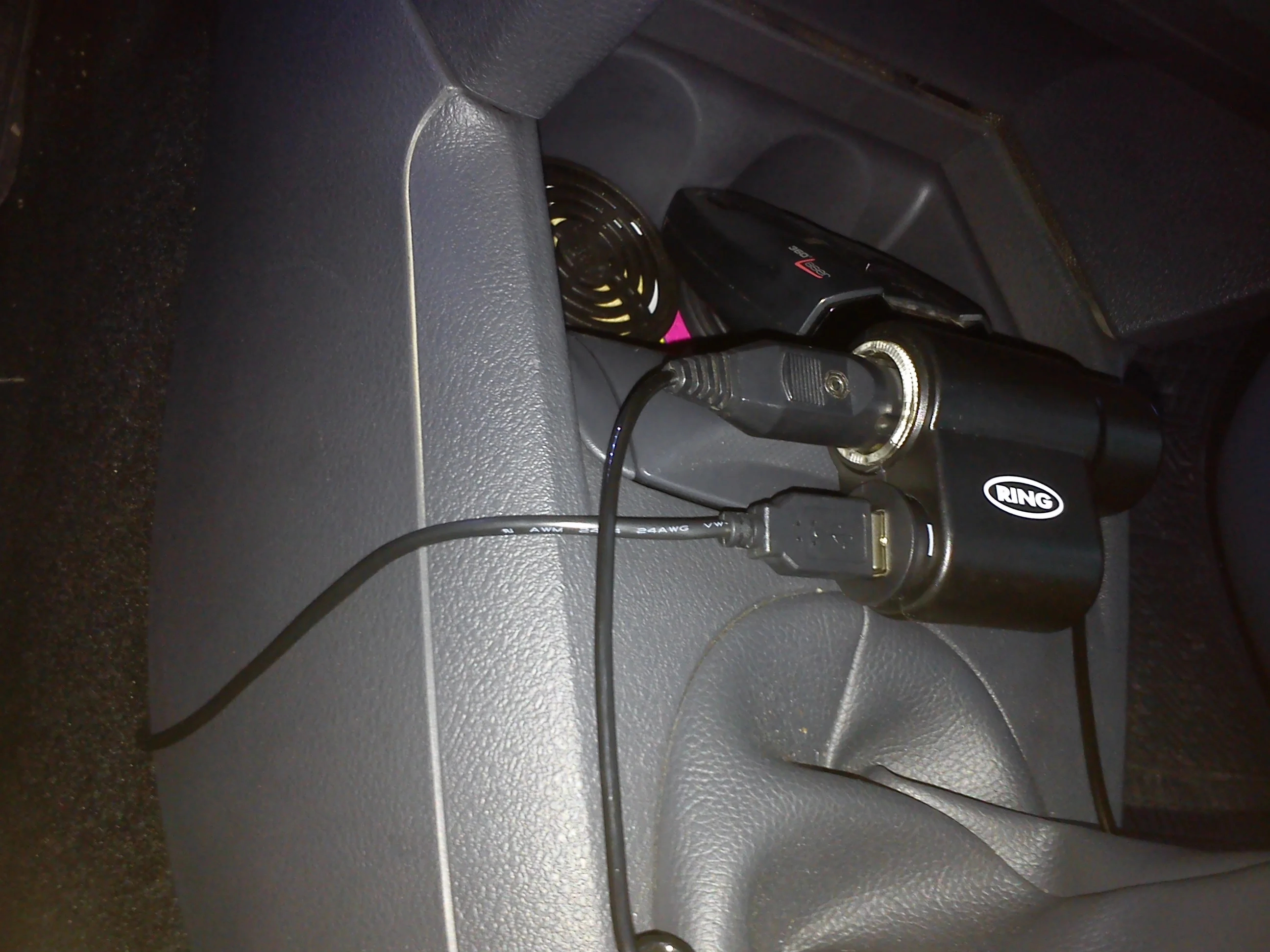

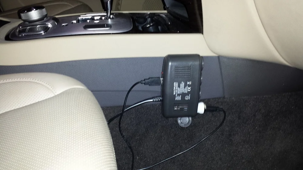

USB cable is pretty long, goes all the way to the front passenger legs area and plugged into 12v power hub via USB-to-12v adapter. Power hub is mounted on the side of the center console with double-sided 3M tape. Front Mobius cam plugged into USB port of the power hub.
