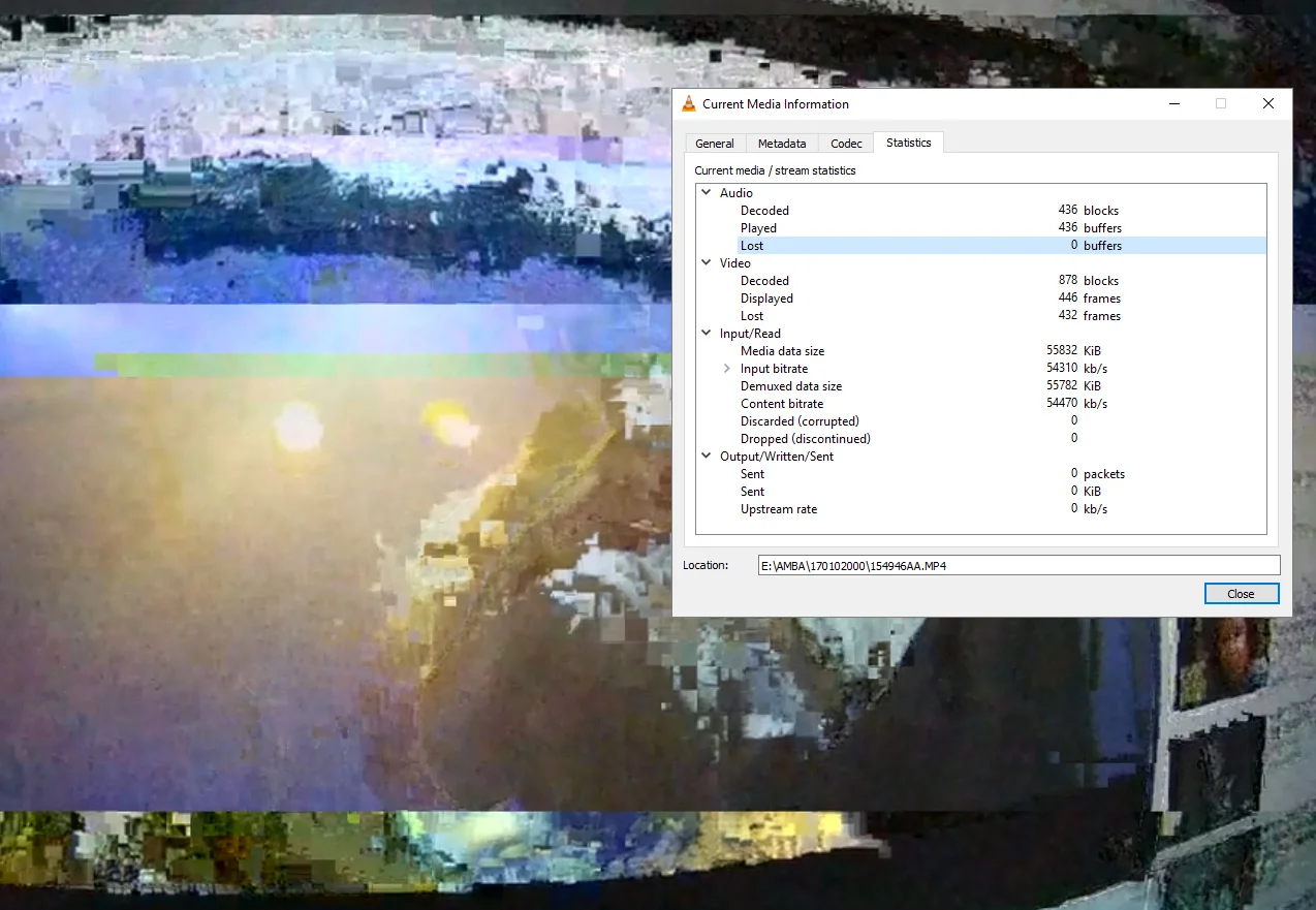

But my files are completely corrupted on high fps modes, and on 100fps choppy. The first picture is a screenshot of a video shot at 240fps.
BTW. Which of these modified firmwares has only the higher bitrates? As i tested one, and it has really weird color cast.
I use firmware under number 13. 4k looks good and it has 70 mbits, but it still has strange artifacts at 100% zoom. There are a variety of color profiles, there is also a flat profile.
