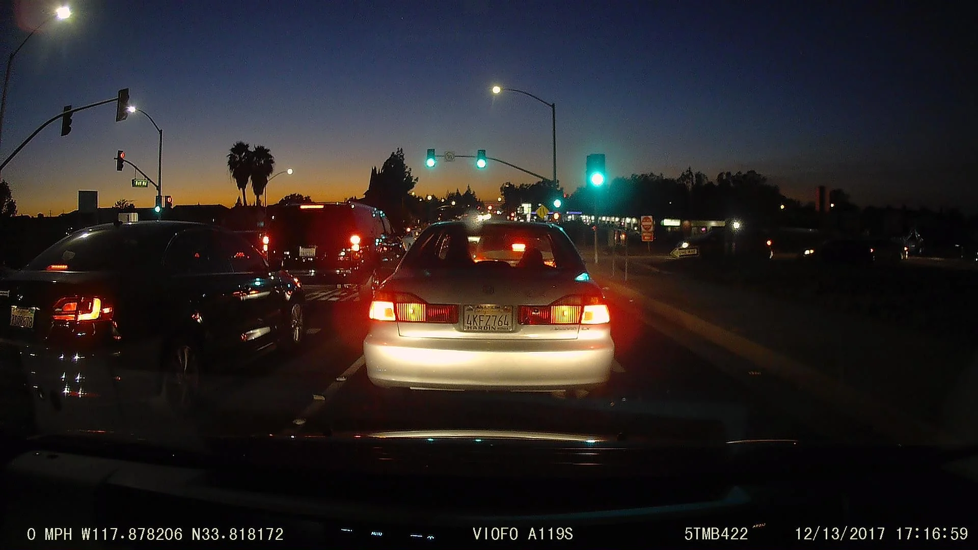

After cleaning. The Halos are still there! I think that I have the exposure too high...
Can you try that image again but without the CPL and make sure the lens is clean?
In that image, your halos are offset from the lights as though they are being caused by the curved lens rather than the windshield, or maybe a reflection on the lens from the CPL, not what we normally see.
I think the exposure is OK, the red traffic lights are still red, they would turn yellow if over exposed.

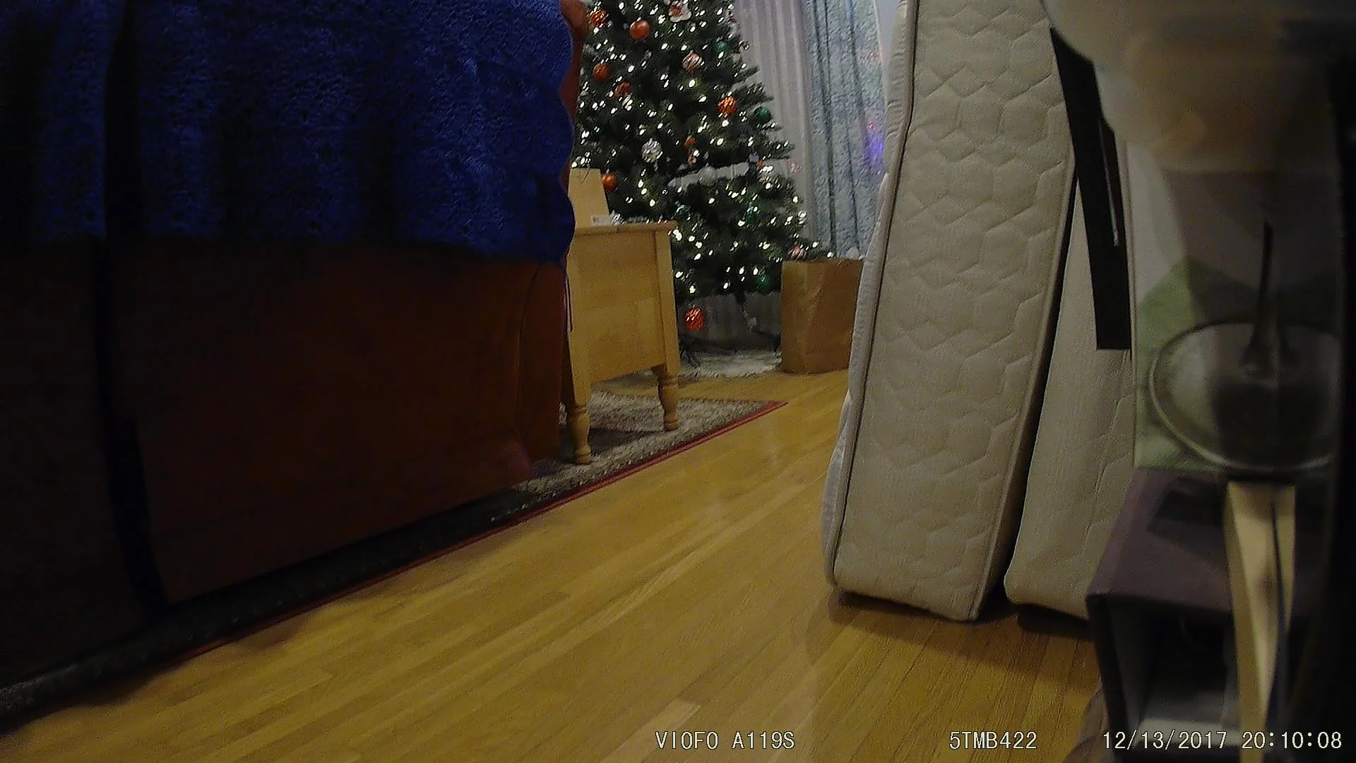

Ok, I will try that tonite (it is 2:36 pm here) and post the results. I won't be able to clean the lens, but I will take a pic of it and post it in a few minutes.
Lens w/o CPL.
CPL. The white dot to the right of center is on the CPL. I cleaned it with dish soap, warm water (from reverse osmosis water filter) and 3 q-tips.

Christmas tree looks much better before you cleaned the lens 😀
Looks like the lens was cleaned with something that left a residue.

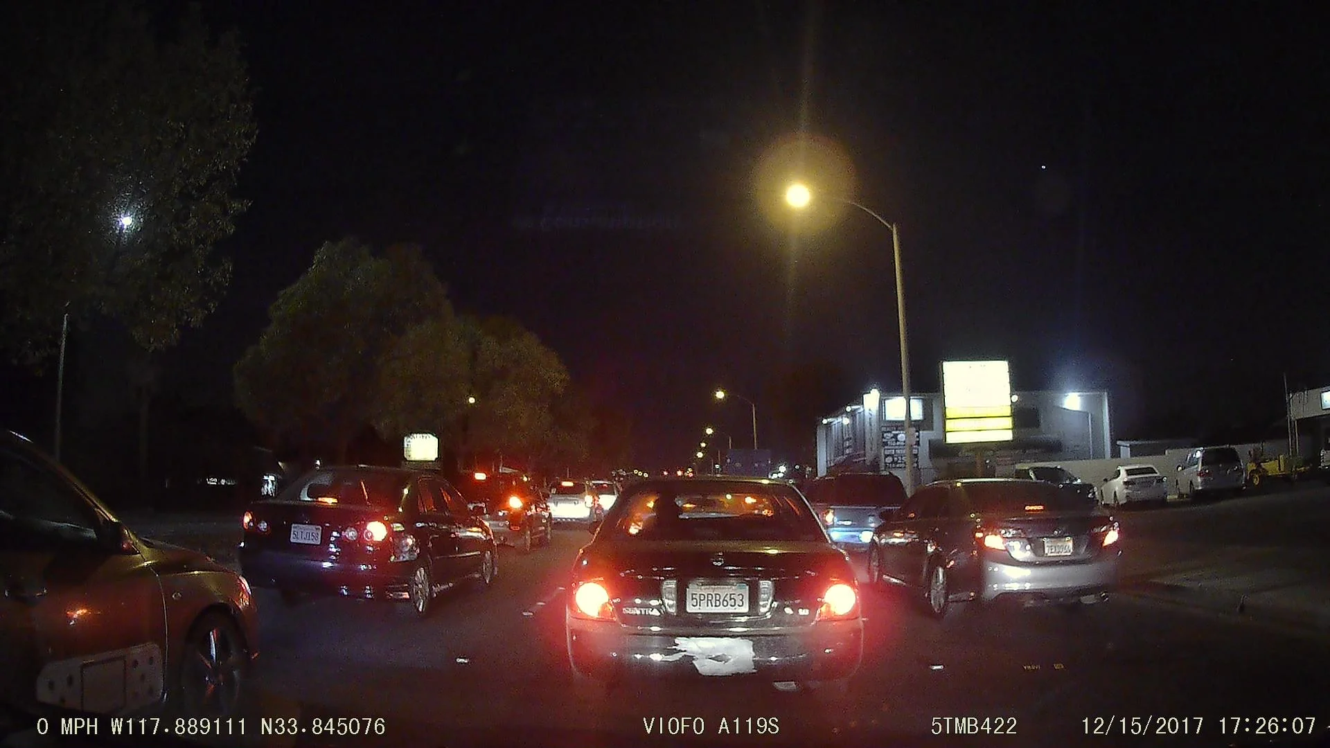

Meanwhile, here is the promised pic after I cleaned the lens and CPL thoroughly:
Even the taillights have halos, but very slight. I can live with that. The halo on the street light, however, is something else. I may also try different resolutions, but I don't think that is the problem. My understanding about the CPL was that it was supposed to prevent this kind of thing. Could the CPL be bad???
