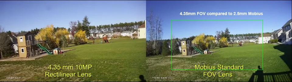

Found this on Vimeo, can't vouch for it beyond saying it's a good demonstration of wide angle vs rectolinear corrected (as it's allegedly a Mobius comparison, I thought Dashmallow might find it of particular interest). It might actually prove me wrong by saying high quality lenses are usually expensive! It's best viewed full screen on Vimeo by clicking the logo and then the expand icon:

That video you are referring to is not a valid comparison in that the two lenses being compared are of vastly different focal lengths. He compares a 4.35mm lens with the Mobius "A" lens which is 2.5mm, so of course you'll have less barrel distortion in a longer lens. Tom Franks of all people should know better.
The Mobius developer goes to great lengths in selecting lenses for his cameras. Many, many lenses are tested before they end up in their cameras and they are generally sourced in Japan rather than China. Even with that the developer is not satisfied and seeks to continue offering improvements even three years after the introduction of the original M1. You'll be happy to know that all the new lenses of all focal lengths even the wide one shipping with the Mobius 2 are better corrected for barrel distortion than the originals.

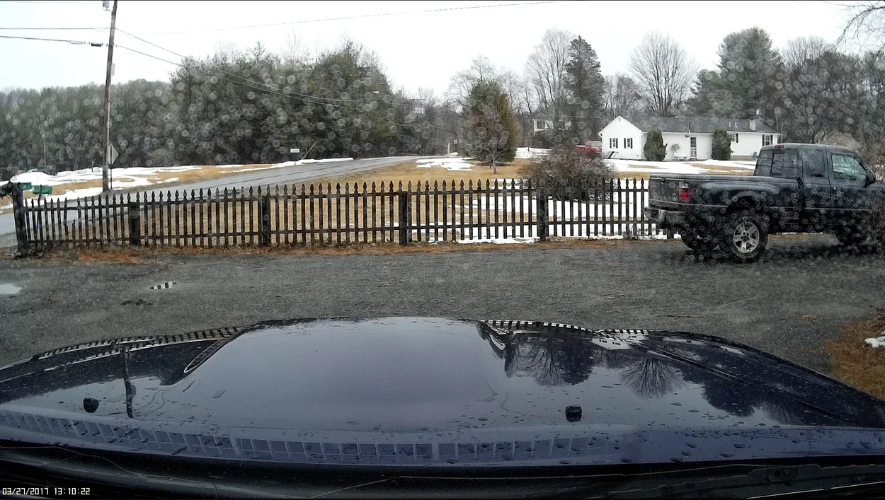

You may be happy to know that the old "A" lens that used to ship with the Mobius camera has now been superseded by the A2 lens which is more highly corrected for barrel distortion. (that telephone pole is not perfectly straight in real life btw.)

You cannot realistically compare barrel distortion between a 2.5mm M12 lens and a 4.3mm lens. One is a modest wide angle and the other is a short telephoto.
These are NOT "very impressive results". Instead, this is a BOGUS lens comparison that only a misinformed person would tout. What alternative reality do you live in?? (and Tom Frank, for that matter?)

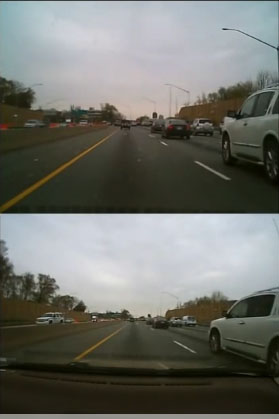

Even with a corrected linear lens, the wider you go, the smaller the objects appear (because they're in a bigger landscape), and so the harder it becomes to retrieve detail.
This video shows you get a perfectly good view with only 70 degrees, although I would go a little wider:
2 still frames captured from the video, 70 degrees top, 120 degrees bottom (captured from different time points as the guy doesn't appear to have aligned his video properly - I've tried to go off the road markings straight in front whilst allowing for 1 cam being mounted higher than the other).
Looking at the car to the right, if he were to leave his lane, 120 degrees offers little benefit prior to a collision with that vehicle (you not really capture anything else - an extra 30cm (1 foot) of car)), and there's a clearer less distorted picture from 70 degrees. The view in front is also clearer on the 70 degree despite not suffering distortion from being at the edge of the lens - the benefit of objects being captured larger in a smaller picture.
Unfortunately, if that white car were to move left, the narrow view wouldn't show if he was heading into empty space, or straight into your vehicle. Tilting it down to get the hood in view would help.
Also that view wouldn't show if the white car had overtaken suddenly before cutting in. That would be the difference between a small error of judgement on his part - which you would be expected to compensate for - and him driving like a lunatic which pins the blame squarely on him.
Detail is nice, especially getting number plates, but the primary purpose of a dash cam is to show what happened.
