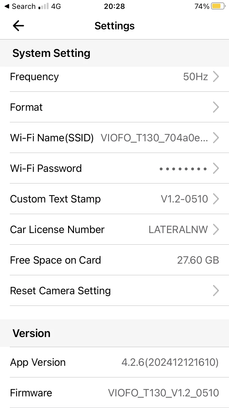

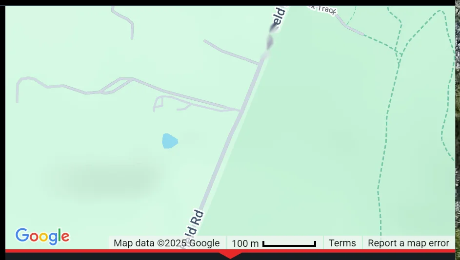

I have version V1.2_0510 and tested some files in the New Viofo Player and they worked fine including the GPS information.
The speed and compass is shown under the video.
Is that what you are referring to?

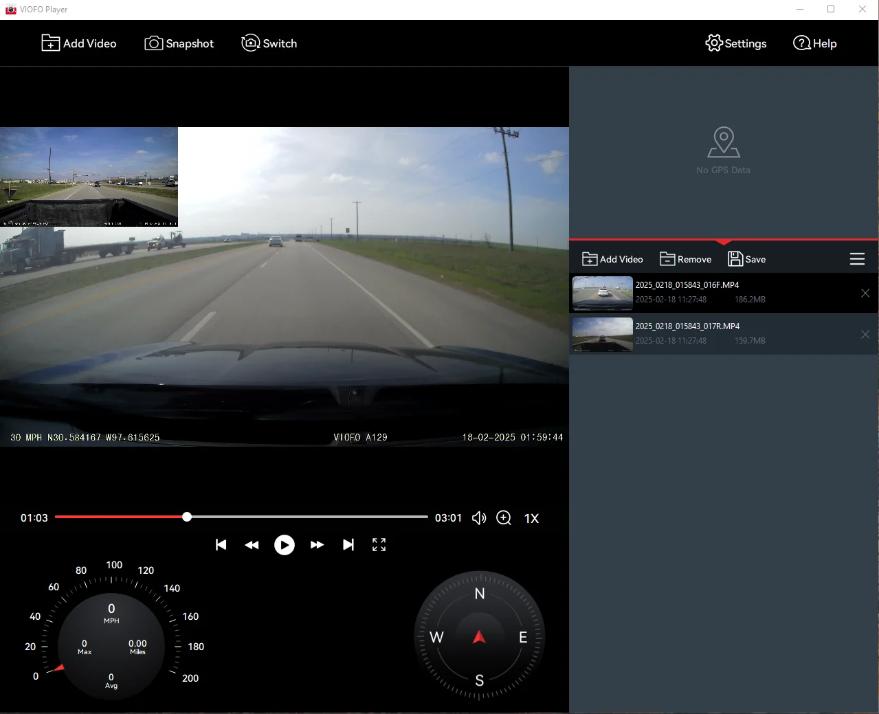

Doesn't look like my GPS coordinates from the videos I sent. The picture you sent doesn't show the camera view or the GPS/Maps on the right side of the screen. Mine still doesn't work, I've deinstalled/reinstalled the VIOFO PC app, but I still can't get the GPS/Maps to display on the side of the video. I also don't see any speedometer or compass readings. The video can be seen, but nothing else.

So we know what you are seeing post a screen shot here.
That is a very bright image for 2AM 🤔
@rander
Looks like you have found a glitch in the matrix lol
I ran up some old A129 Duo video and it didn't load the gps information.
I used the T130 which through me off the scent.
