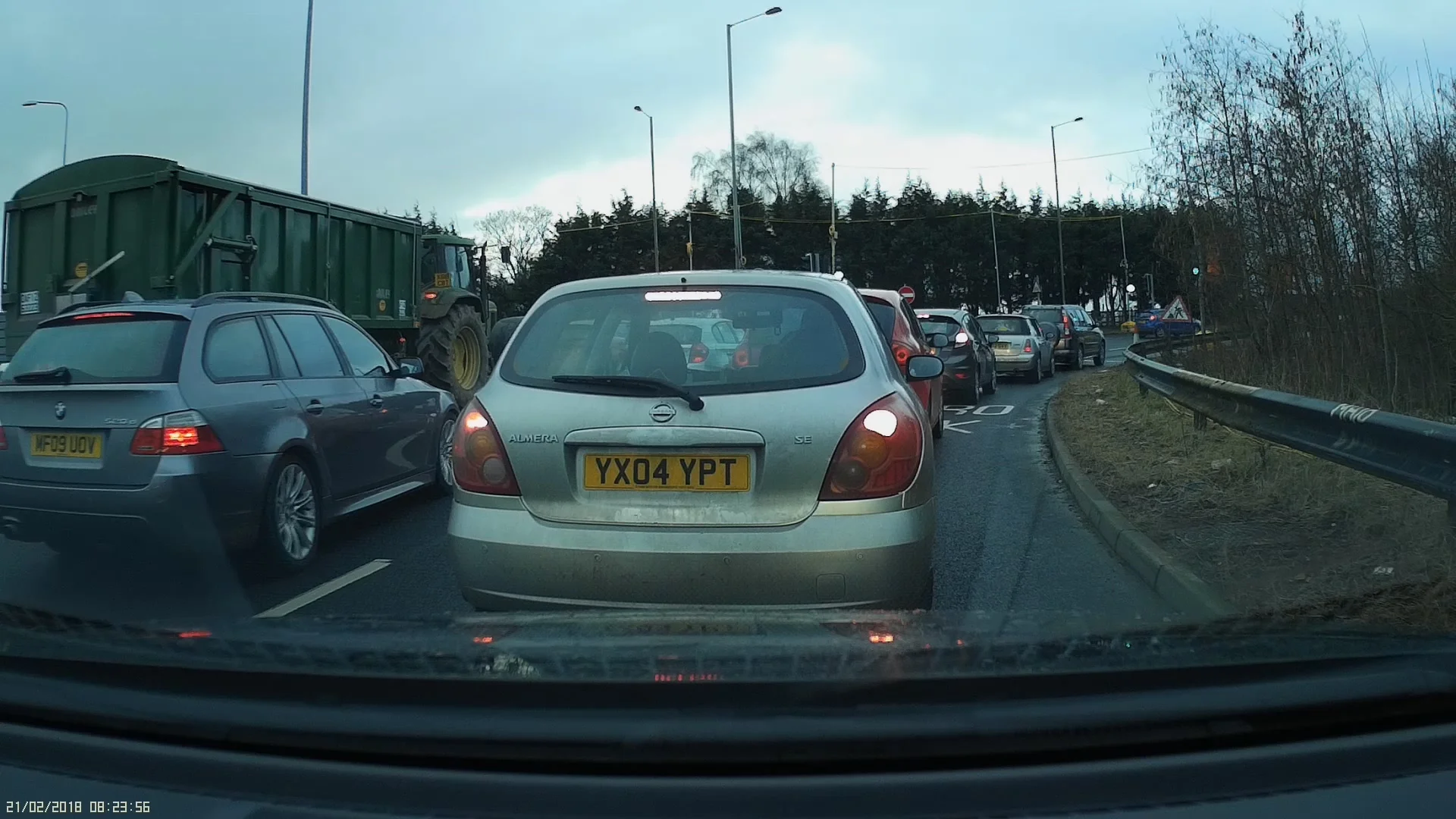

At low speeds, there's not much to choose between these two 4mm lenses
F1.2
F1.5
F1.2
F1.5

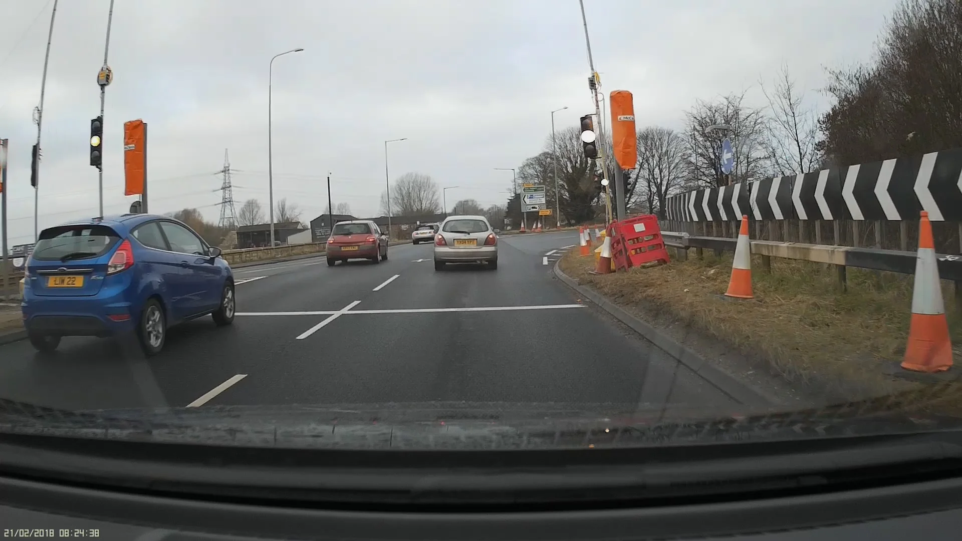

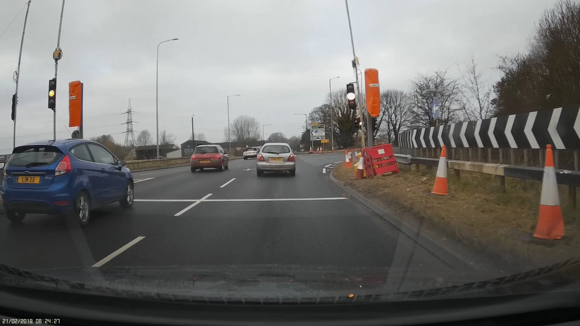

At higher speeds in overcast conditions, the F1.2 has a slight edge over the F1.5. Both lenses outperform my A119 at 1080p60fps (F1.8 lens) for number plate capture.
F1.2
F1.5
A119
F1.2
F1.5
A119

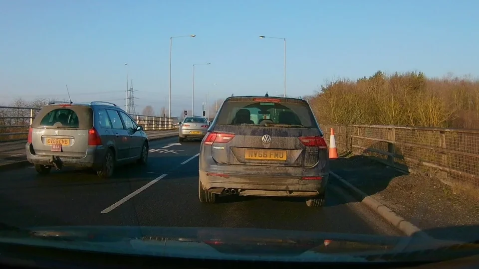

Both cameras are now set to lens profile 'B', and are producing much more realistic colours than with profile 'A'.
This morning we had bright low sun on my drive to work.
As before, there is not a lot between them, but my preference is still the F1.2 lens. The F1.5 seems to have a bit less contrast and sharpness.
Both suffer contrast loss due to glare to about the same degree, despite the F1.2 lens having a much larger front element.
F1.2
F1.5
F1.2
F1.5
To illustrate how both of these Mobius 1 & 4mm lens combinations are lacking overall contrast and saturation, these two frames (cropped to similar FOV and resized) were recorded at the same time from a different camera.
