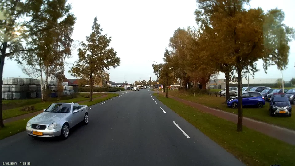

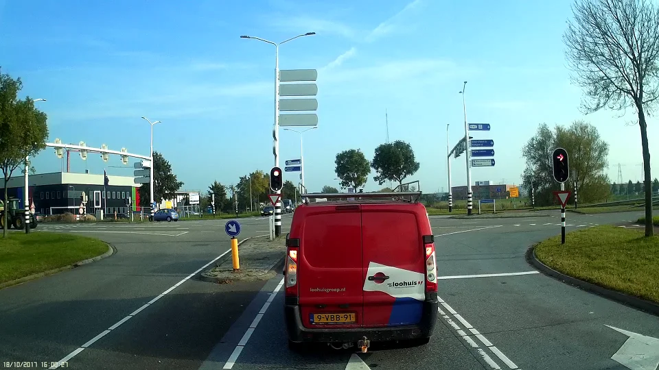

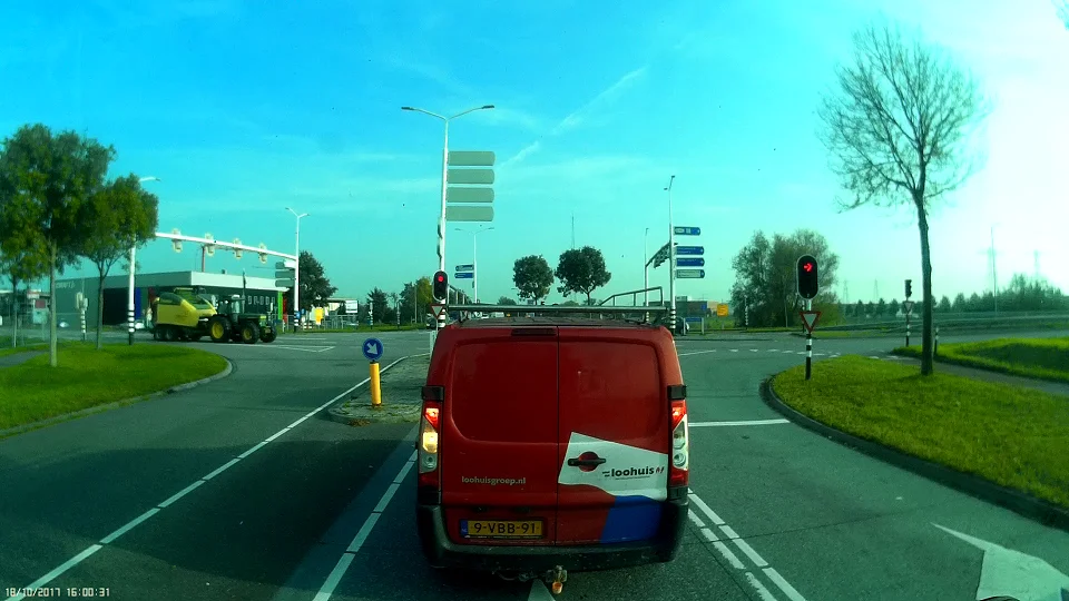

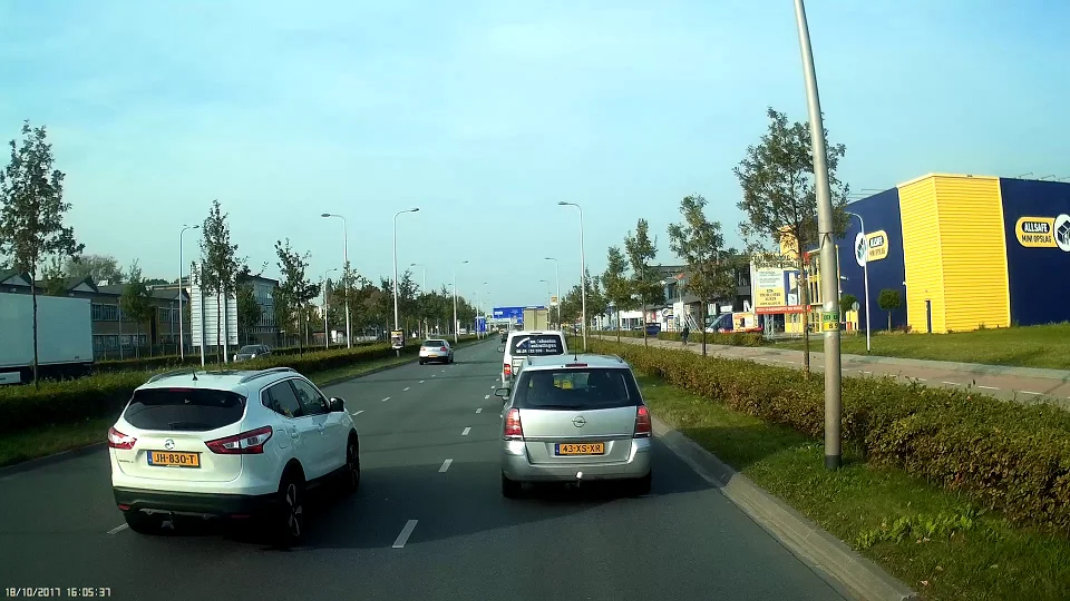

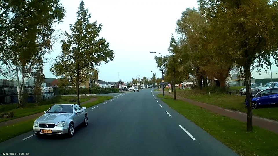

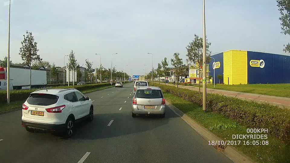

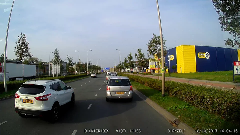

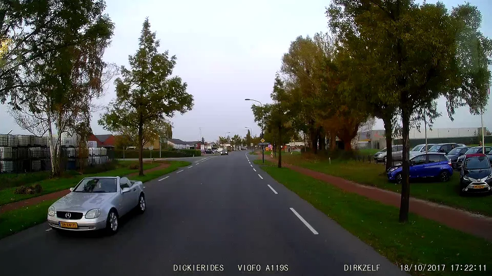

OK, I promised you guys to do another comparison with changed settings, however I haven't been very successfull due to very unclean inside windscreen so I will show some differences in daylight, night time is way to confusing due to the greasy smears on the inside windscreen, I don't know what my collegue driver was thinking, but he must have tried to "clean" the windscreen with some WD40 or I don't know what he was doing.....
MOBIUS with the Runcam Swift Gopro quality 120 degree lens:
SHARPNESS +20 / CONTRAST +20 / EXPOSURE 0 / SATURATION +20
F1.2:
SHARPNESS +20 / CONTRAST +20 / EXPOSURE -20 / SATURATION +20
A119S:
EV -0.3
JooVuu:
I don''t know.....
All in the above mentioned order:
Did you focus the A119? The focus is looking good in those images.
EV settings also look good, but need testing in different conditions like night time to decide if they are the best.
The first Mobius looks out of focus, but I think it is all motion blur!
A119S: No lens fiddling, just EV -0.3
First Mobius: definitely motion blurr, the lens is incapable, I focussed this lens eactly the same way as the F1.2 lens, static objects in daylight would appear to be equally sharp.....
But I'm going to re-fit the C2 lens, which imho is the best fit one from the standard Mobius lenses all together (A/A2/B/C/C2/D) (yes I still have a working B lens.....)
So next will be comparing the C2 next to the F1.2, and I'm taking F1.2 a little down further to EV -30.

There's more to a lens than just the size of the aperture. A fast F1.2 lens can normally be expected to exhibit more distortion, chromatic aberration, flare or uneven sharpness across the frame than a slower F2.8 lens at the same price. However in this case it looks like you have found a fast M12 lens that performs very well at a reasonable price. Looking forward to receiving mine. I just hope it's from the same batch and has similar performance....

That looks more like loss of focus around the edges than motion blur with the Runcam lens. If it was motion blur, it would be sharper in the vertical direction.
The second set of images confirms this, as there's definitely no motion blur when the camera is stationary at a red light!
