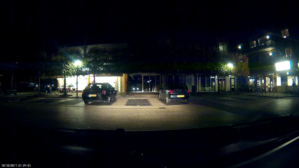

Original Mobius night recording with 4mm ~ F1.2 lens (!)

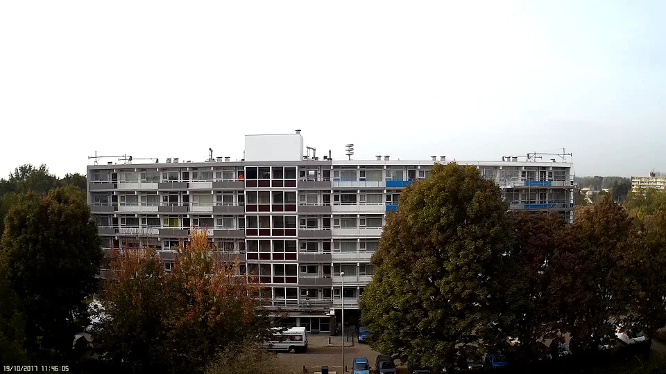

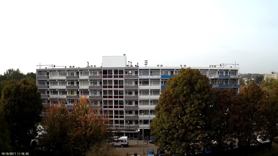

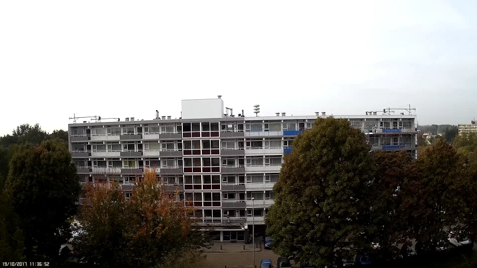

Ive been doing A-B and C settings test with the F1.2 lens:
A:
B:
C:

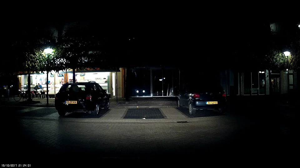

F1.2 lens exp -/-30 (too dark for my taste, going back to -20):
I'm getting confused here. Is exp -20 brighter than -30?
OK, so I got confused here too and deleted my last post so I could think this through again.
So, yes, -20 is brighter than -30 but unlike what I said previously all the minus values are "north" of the normal position in mSetup which can feel a little counter intuitive. You could conceivably go all the way to -128 to make the image pure black if you had any reason to.
Thanks @Dashmellow. I'm thinking the other way too. From memory I thought settings below "normal" is -. Above is +.
C2 lens exp 0:
At night there's a trade off between preserving highlight and shadow information, due to the limited dynamic range of the sensor. You can read number plates easier when the exposure is turned down, but you do lose shadow detail.
as the saying goes, you can't have your cake and eat it too
