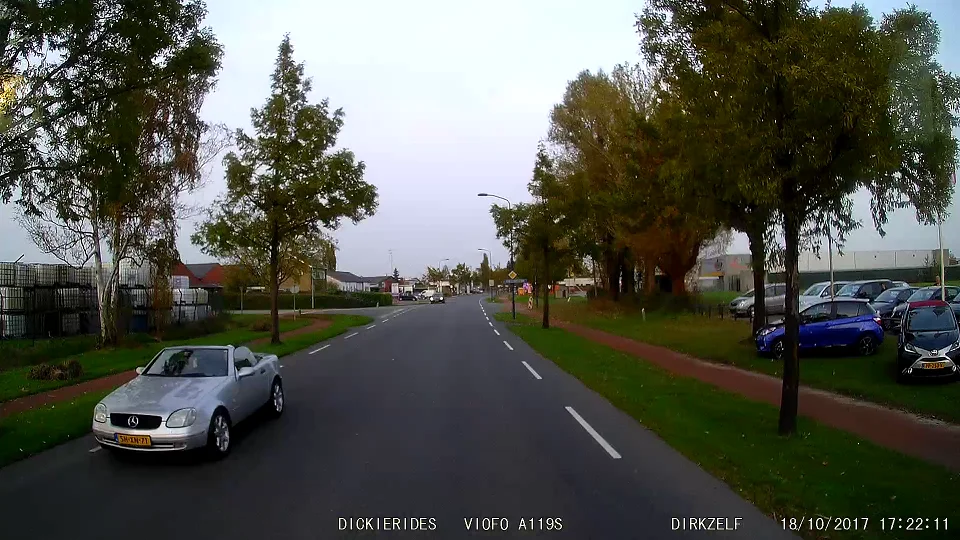

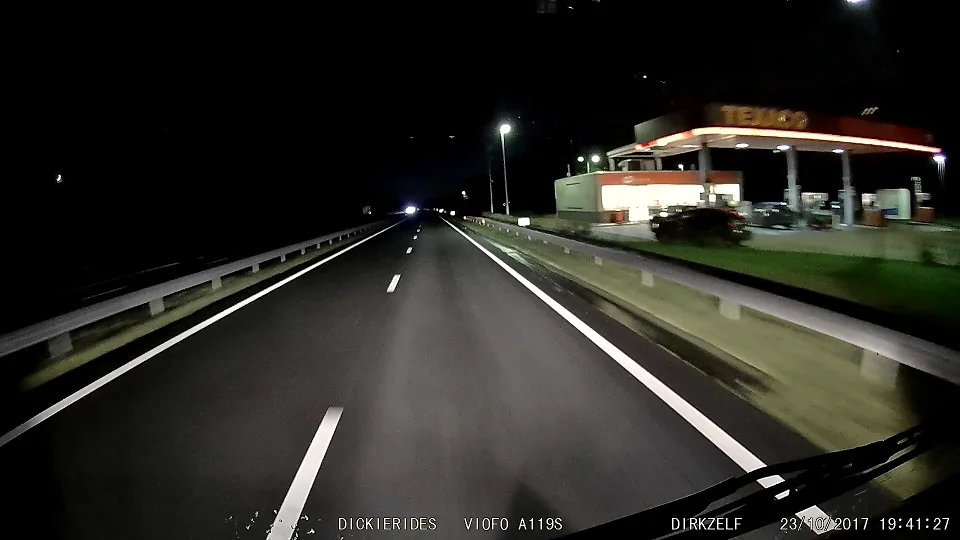

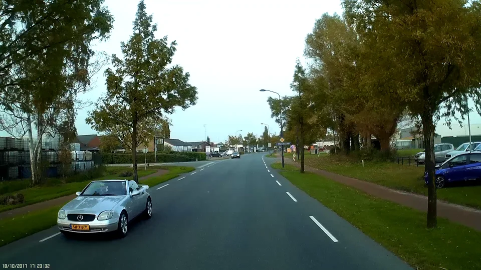

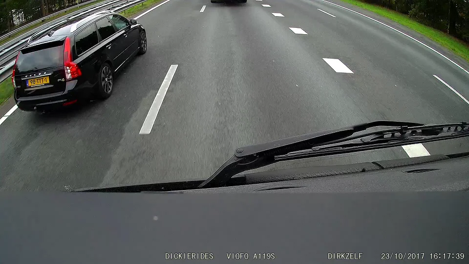

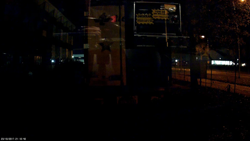

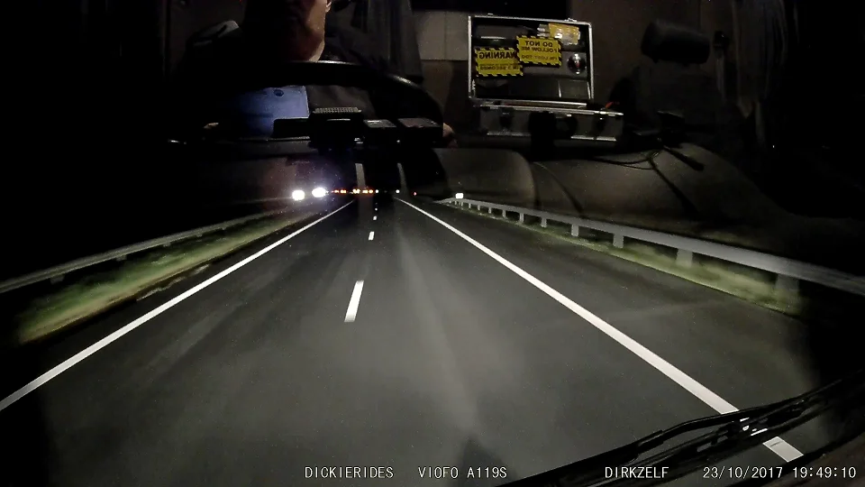

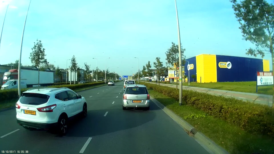

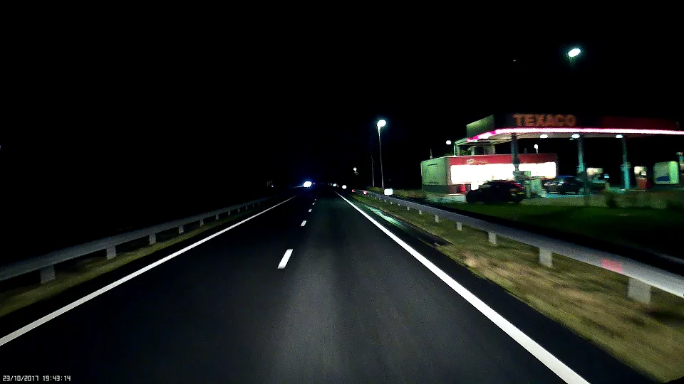

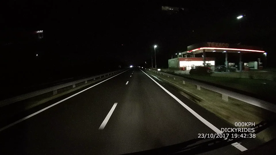

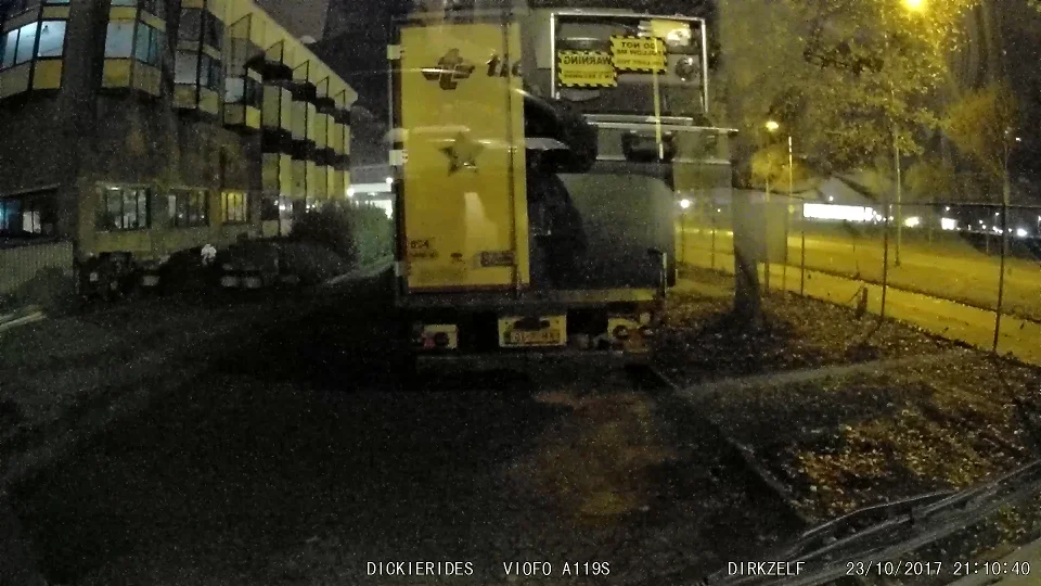

OK, I promised you guys to do another comparison with changed settings, however I haven't been very successfull due to very unclean inside windscreen so I will show some differences in daylight, night time is way to confusing due to the greasy smears on the inside windscreen, I don't know what my collegue driver was thinking, but he must have tried to "clean" the windscreen with some WD40 or I don't know what he was doing.....
MOBIUS with the Runcam Swift Gopro quality 120 degree lens:
SHARPNESS +20 / CONTRAST +20 / EXPOSURE 0 / SATURATION +20
F1.2:
SHARPNESS +20 / CONTRAST +20 / EXPOSURE -20 / SATURATION +20
A119S:
EV -0.3
JooVuu:
I don''t know.....
All in the above mentioned order:
View attachment 33968 View attachment 33971
View attachment 33973View attachment 33974
I think the Mobius has a 1/3" sensor. This lens is 12mm on a 1/2.5" sensor. The focal length will appear to be longer than 12mm on the Mobius since its sensor will effectively crop out the middle 1/3" of the 1/2.5" image circle.
This was a good (and close) comparison (really liked it). One thing that I used to determine sharpness is the yellow building corner on the right (lines in the blocks) and the white blocks of whatever on the left side of the road. You can treat them ( sorta) as Lines Per Inch (LPI) scale for a fairly good estimate of the resolution, try it, it works!
However even though there is a winner, it's amazing how close they all are, just looking at picture quality. It just might pay big returns if the Mobius was worked with more as Dashmellow suggested a couple pages back, even though the newer cameras might have newer (and higher rated) camera sensors it's still doing great and I believe further to go.
As for that first picture with the 120* Runcam and Mobius it doesn't make a lot of sense the image quality on the license plates looks good but the yellow building corner is a complete blur (no definition), that would suggest a loss in lens quality as it nears the edges, personally I would sell the lens. Just my personal opinions!
The Mobius with this lens is really amazing, I agree completely, as do many others here. I'm happy to have tried it, the F1.2 is a keeper. I bought another one, maybe I'll try it with the JooVuu X. But that one is to be phased out here I'm afraid. It's too unstable, and although quality has always been great, it has been outperformed by this A119S, and now even by a 4 year old Mobius with a new lens mind you...... where does it end...
