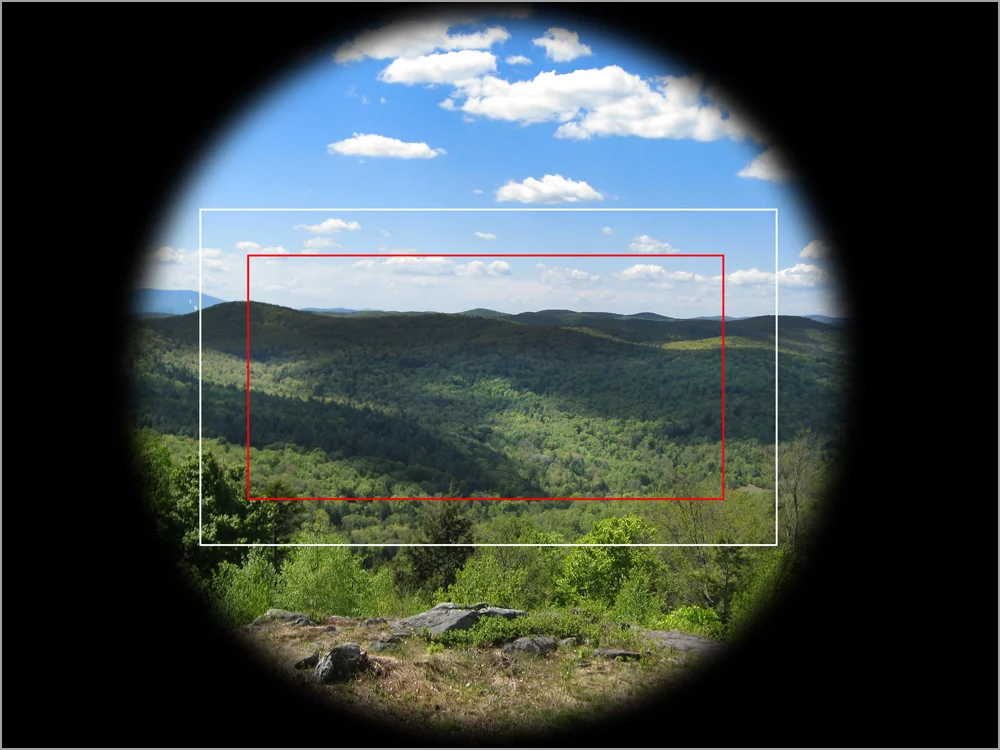

Here's a demonstration image I made:
Imagine that you are looking at the circle of coverage from a lens designed specifically for a 1/2" sensor. (seen in
white)
If you install this same lens on a camera with a 1/3" sensor (seen in
red) it will only record a smaller section of the available circle of coverage onto the smaller sensor, thus providing an image that has more of a telephoto effect.
So, if you were to buy an 8mm focal length lens that is designed for a 1/2" sensor it will act "perhaps" more like a 12mm focal length lens if installed on a camera with a 1/3" sensor. (I'm only guessing at the increased magnification, of course, but it's probably somewhere in the ballpark.)
The telephoto effect demonstrated above can be a very good thing for our purposes because the center portion of a lens's circle of coverage always provides better optical performance than towards the outer edges of the circle. You'll get a sharper, brighter, more optically corrected image with less barrel distortion than it otherwise might have.
