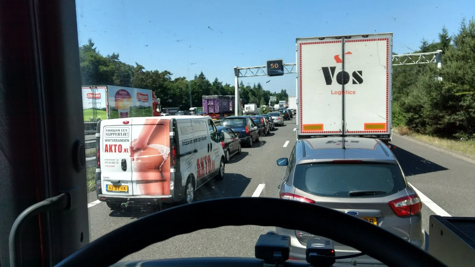

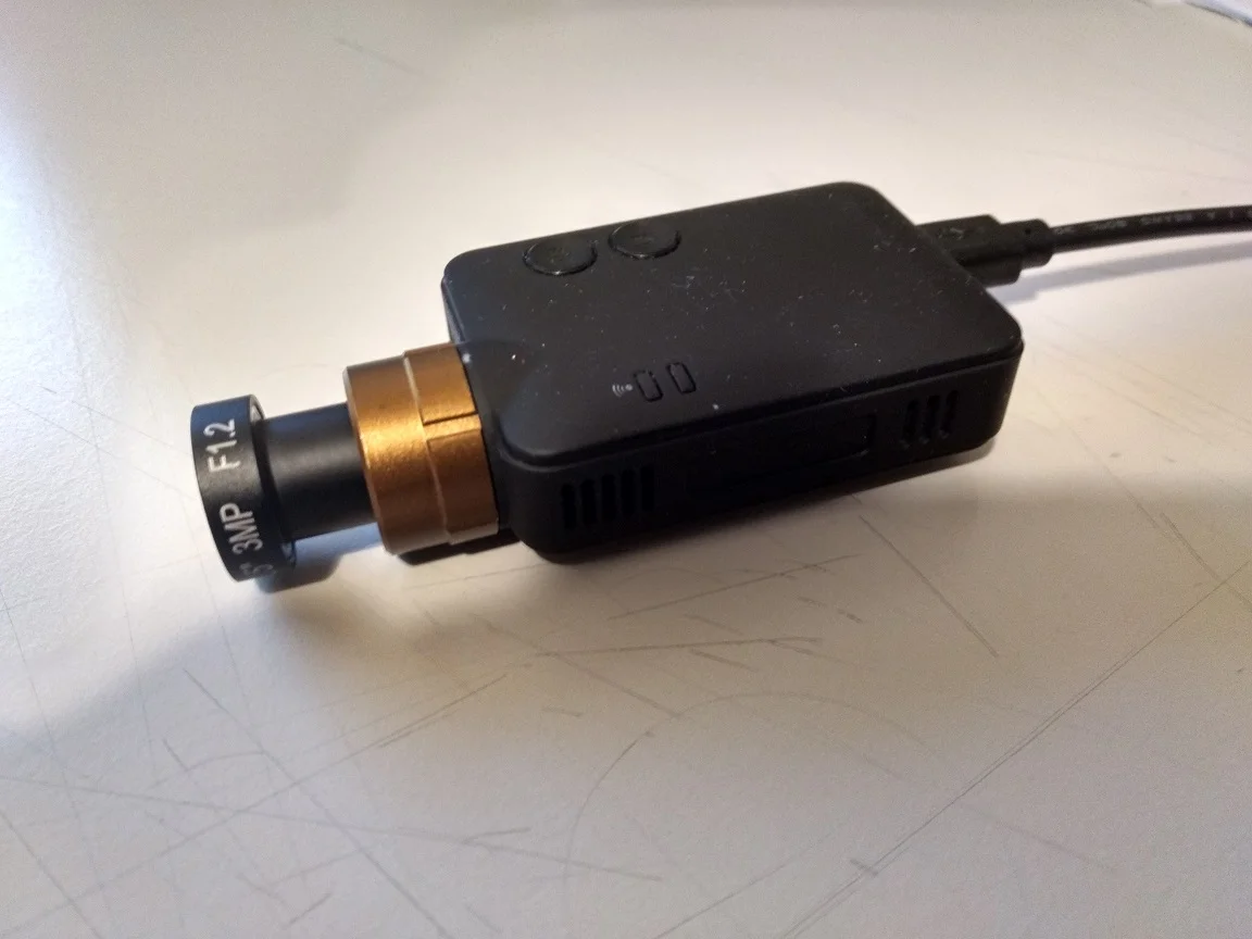

Original Mobius night recording with 4mm ~ F1.2 lens (!)
Thanks for thinking about what I am looking for but there are to many if's about the Ebay lens, one of the main ones being it has a 1/3" format (6.00mm Diameter). The Mobius also has a 1/3 " Sensor (6.00mm diameter), so they would have to align perfectly or there would be vignetting , the chance of that happening is very great. Since tolerances are somewhat loose on M12 type lenses it is best to go up at least one lens format size, that would be 1/2.7" format (6.72mm Diameter). According to the experts you can go up to 1/2" lens format (8mm) without any problems.

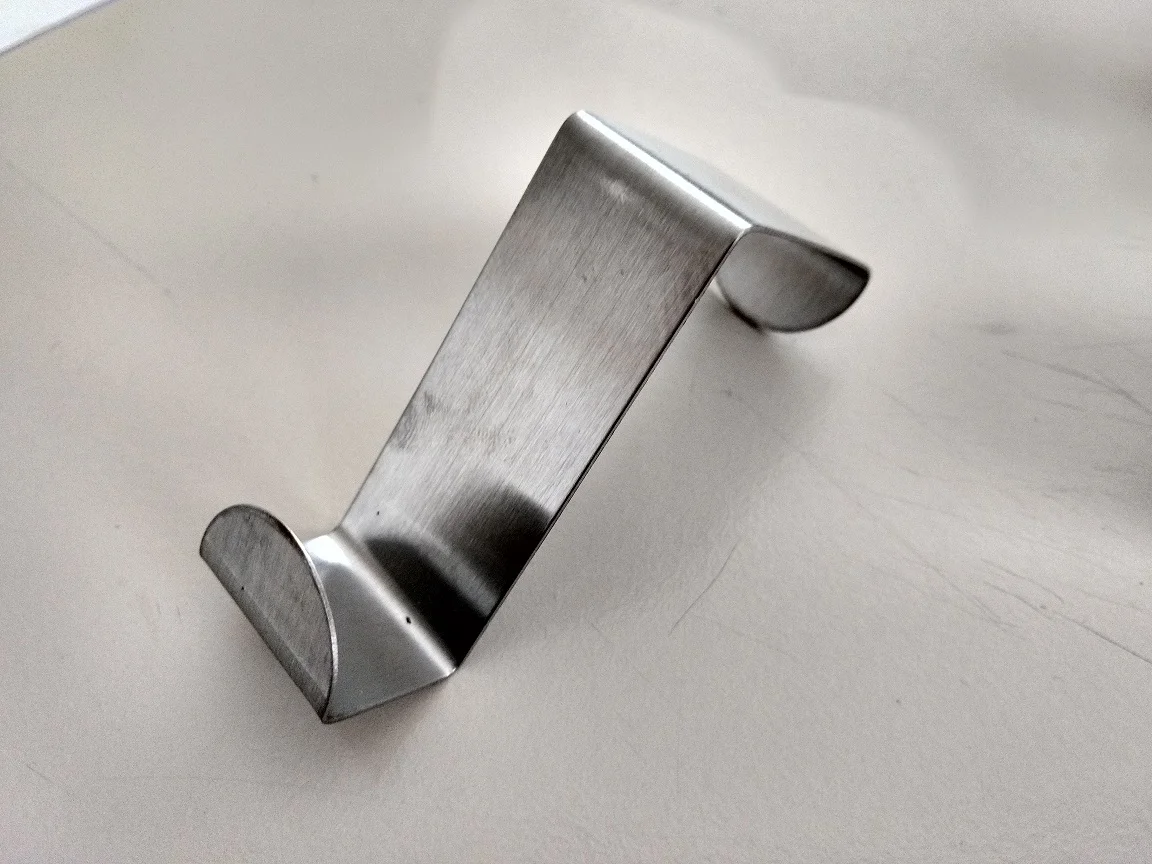

The mounts start out like this:
Yes, generic steel door hanger, bought from .... don't remember, some chinese shop, virtually for grabs....
Then take a hammer and an anvil of some sort, reshape to this:
I need this shape due to the trucks dashboard shape, they mount right in front of me where I sit, behind the steering wheel (picture further down), where there is a ledge I can stick these mounts on.
Under the round black rubber there is a round, flat magnet which sits in foam rubber which I cut out from protective, self adhesive pads that go under your chair-legs.
Rubber for stability, and to prevent the camera from inadvertently turning away from the windscreen.... I can't fiddle around when driving.
Stick a metal plate on the camera's bottoms
and then it looks like this with camera on (single use)

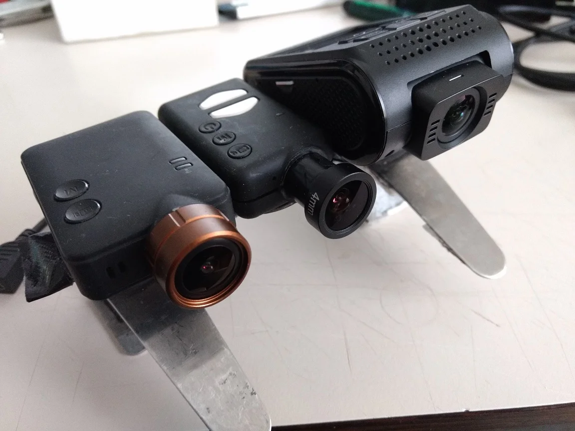

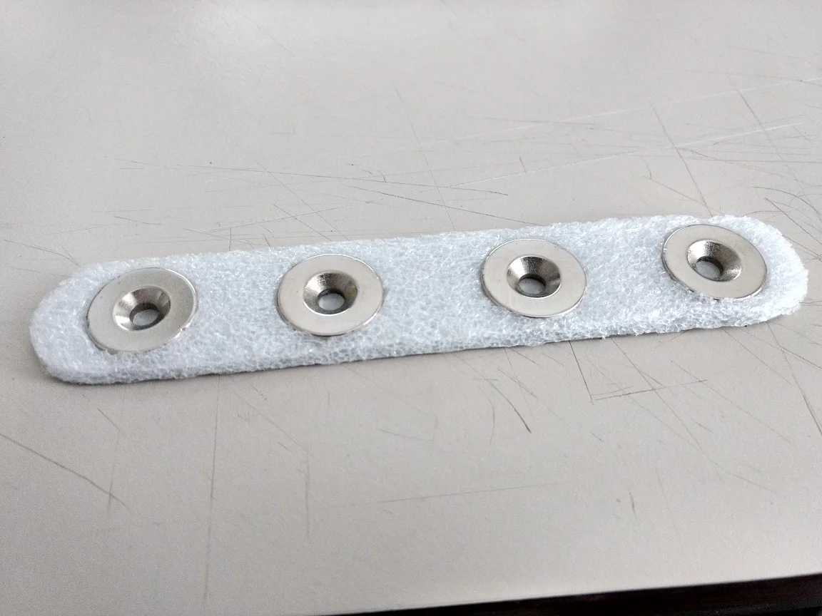

If I want to do some comparison, I use 2 of these mounts and a little bridge, made from the same door hangers, stick some magnets on, and cover with foam and rubber again (I used a damaged innertube for this one....)
Contraption with camera's on:
As you probably see, I use some foam or rubber pads to protect the dash from scratches.
Hope you like it, and maybe can put you in a direction to solve something similar.

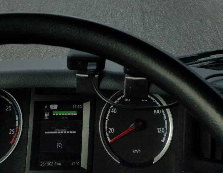

Here's a picture, let's say I made it ONLY to show you the mounts behind the steering wheel..... πŸ™„
Better view here:
Piece.
