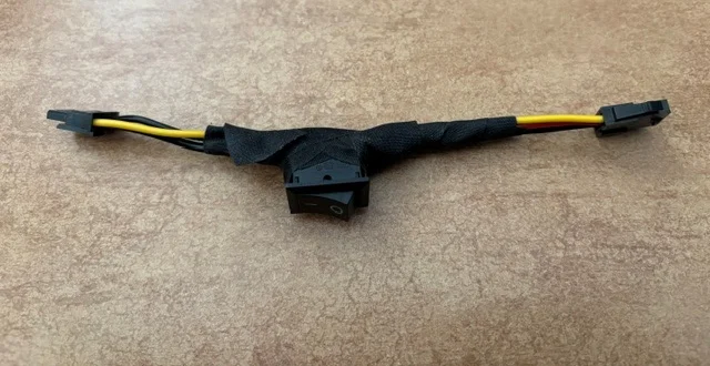

I use a short cable with a toggle switch in the dash camera ACC power wire to perform parking mode tests. I don't have a need for an illuminated switch, but I understand how that would be helpful to know when the dash camera ACC power signal is "on" or "off".
The cable you want would be sourcing the dash camera constant power and the power sent to the switch from the battery packs constant power pin.

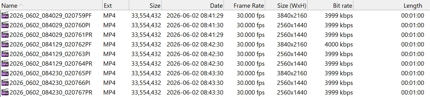

You could select the A329S low bitrate parking mode which records at 30 fps, but a lower video bitrate to save space on the memory card. That way you could leave the wiring as it is now, but still get a 30 fps parking mode video files [with a reduced bitrate, but with audio].
Thank you. That looks like the switch that I would need. It appears by your post that you have wrapped your mind around what I am looking for.
