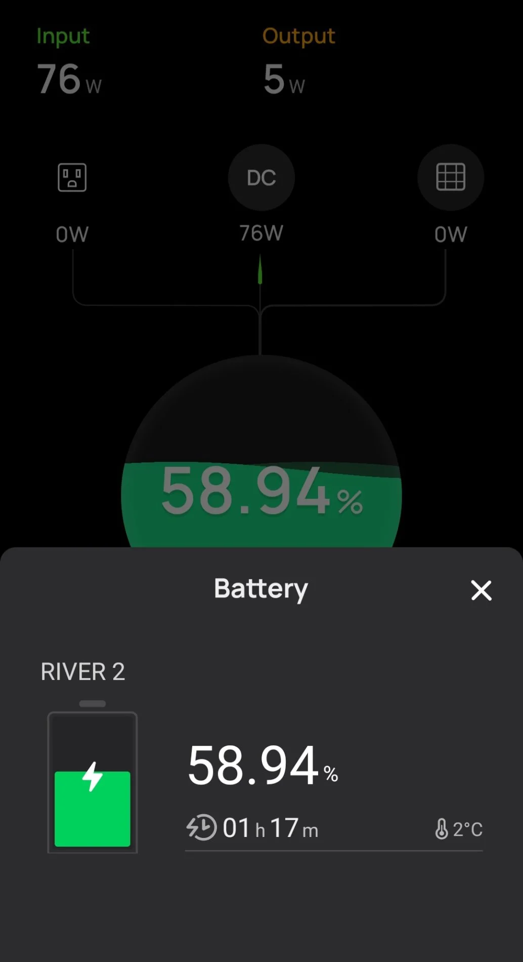

It would be good to know @forcefed if the Ecoflow indication is any better, and how Ecoflow performs in cold weather conditions in general.

So the temp here is around -10c and the ecoflow obviously doesn't charge at that temp, it starts to charge once the internal temp is +2c.
In my morning 15 minute drive it doesn't charge but in my afternoon one it does start to charge near the end of my drive. I have the rear seats down and rear heating set to max to increase the temp in the trunk. If I take a few longer drives it does charge back up to full so I haven't had to take it inside to recharge yet

And yes, definitely better indication of battery status, and it is great to have an app.
We just need to see how it will do in hot summer days and we can declare it as the best power bank/station for dash cam.

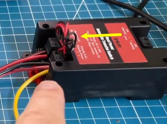

I'll have to play around a little with the wiring configuration and see how I can incorporate a relay. I just haven't sat down to draw it out yet. The EcoFlow units automatically turn on the 5v USB ports when they receive a 12v charging input, but the 12v output ports need to be enabled manually or with the app each time the unit turns on. It won't remember this setting and it doesn't go to sleep by itself when the 12v output is turned on. I have an iPad for the app, but don't have an iPhone and since I don't always have my iPad in the car, I'm most likely to do all of the wiring from the 5v USB ports that turn on and off automatically.
@GPak, what's going on with the red and black wire loops on the input side of your relay in your third video above? I'm referring to the wires that loop up above the relay that don't appear to be direct 12 inputs. I marked them with the yellow arrow. Are they connected to anything, or did you just loop them with a zip tie to keep them out of the way?
