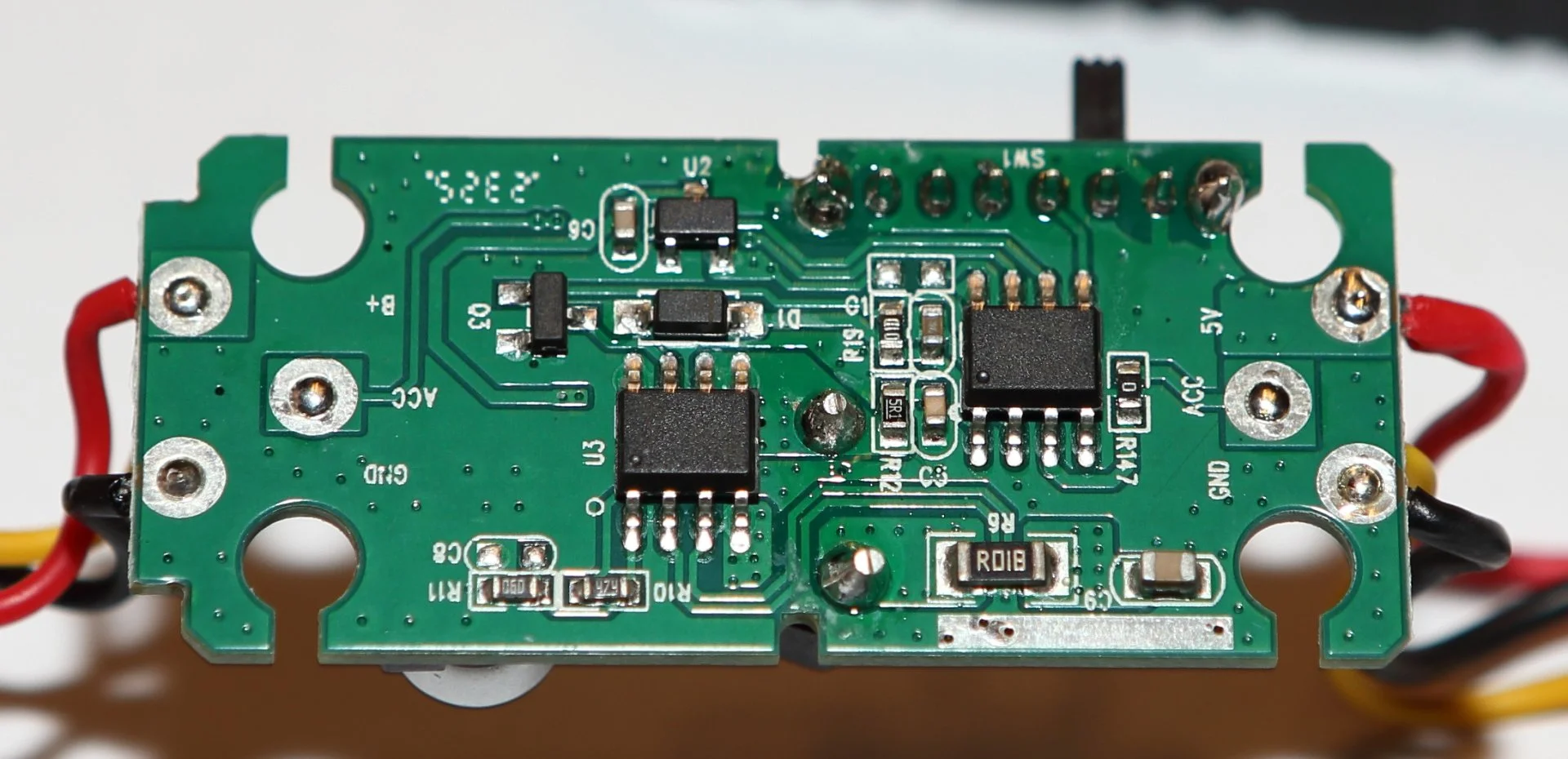

There are four screws that hold it together, located under the corners of the silver sticker. It's exceptionally difficult to photograph the IC labels, but I was able to make some notes to share.
Here are the guts of the HK3-C hardwire kit from Viofo (ver CE0018_w_v1.3). The top side of the circuit board contains ordinary stuff like resistors, capacitors, an inductor (used by U3 on backside of the board), and the voltage select switch. The two black devices on the left hand side are just diodes. They appear to be intended to prevent damage resulting from accidental reverse voltage hookup. The larger diode is for supplying current to the camera from the B+ line, smaller diode is for the ACC trigger line. Nothing particularly special or interesting going on here. Left side is voltage input and the right side is voltage output.
It gets more interesting on the bottom side, though. Left side of image is voltage input and the right side is voltage output.
The 8-pin IC on right hand side of the image (voltage output side of board) is a Chipsea 32P10-S0. The second line of lettering on this device is "2315S1C" - it is a 12-bit analog to digital converter. The 32P10 is tied to the input voltage selector switch, so it is likely the encoder for the various input voltage levels used for battery protection. I presume it converts the input voltage into discrete digital signals that control U3 and/or U2. The only datasheet that I can find (not an exact match) appears to be in in Chinese(?), so I can't read it:
https://www.alldatasheet.com/datasheet-pdf/pdf/1149566/CHIPSEA/CSU32P10.html
U3 is the 8-pin IC in the center of the board and is the actual DC-DC Converter and is marked NDP1335KC. This performs the 12v to 5v conversion for the camera. The output voltage is adjustable via external resistors also mounted to the board. It features a slow-start turn on characteristic and has short circuit output protection. The datasheet is here (and attached below):
https://www.lcsc.com/product-detail/DC-DC-Converters_NDP-NDP1335KC_C7420573.html
Q3 is the left-most device on the input side of the board and is an A2SHB 20v N-Channel current flow regulator Mosfet in a SOT-23 package. This likely limits the current draw of the camera to 2A to protect the overall circuit. The data sheet is here (and attached below): https://www.datasheetcafe.com/a2shb-datasheet-transistor/
U2 (top most device on the board) is a three-legged device and its only marking is "OUHzK." I can't find any data sheets or descriptions for it, so it's exact purpose is unknown to me. Given that it is a 3-legged device (likely more complex than a simple transistor given its "U2" marking on the PCB) and seems most closely tied to the ACC input signal (after passing through the smaller diode on the top side), it likely controls the power flow to the rest of the circuit, turning on the ADC and the DC-DC converter after the car is started and 12v appears on the yellow input line..
