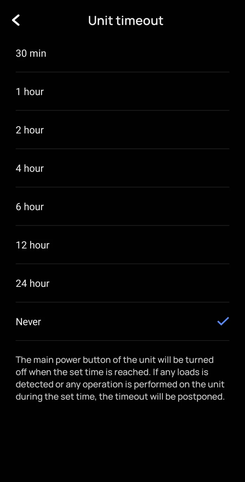

You can set the timeout for the ecoflow to 1/2/4/6/12/24 hours or never, i figured i'd leave it constantly on but i forgot that it turn's on when i turn the car on to charge so i'll play around with the timeout feature when i turn my camera off.
That looks like Bluetty except for much wider time range.
Please check if that time-out is for no load only, or even if load is present
Here's what it says, seems it's after the load finishes, I'll test it tomorrow.

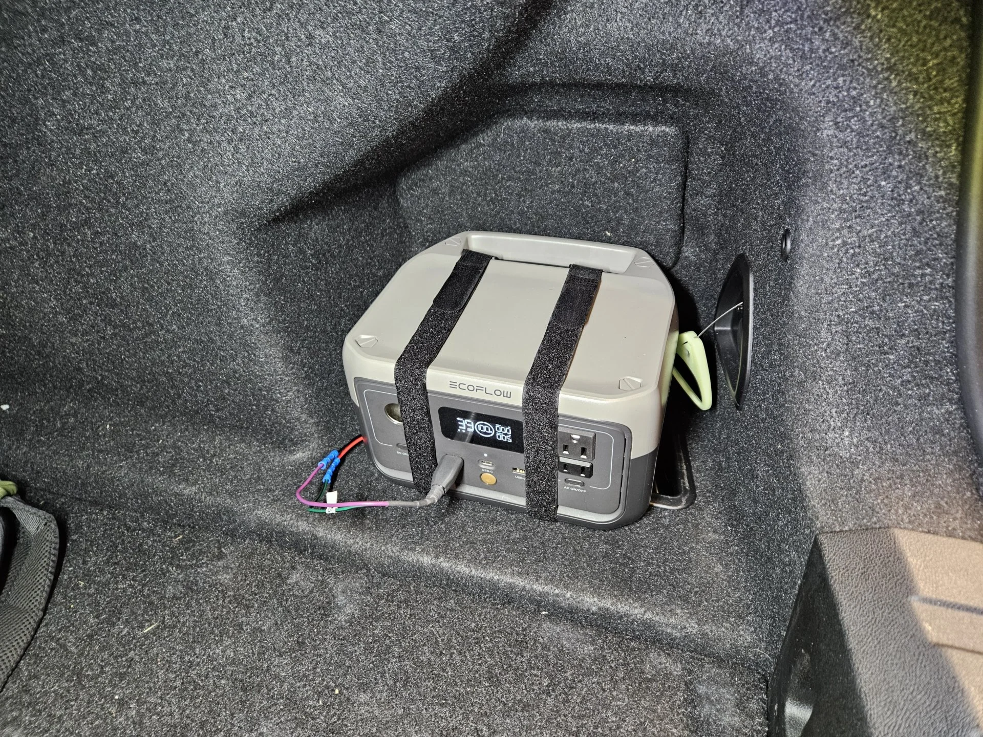

Here's my almost finished setup, just waiting for the left angle usb connector and wire loom to tidy up the wiring a bit.
