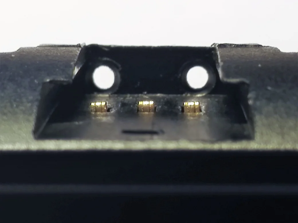

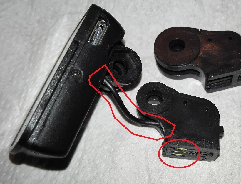

...I have exacty the same problem with the mini0905 dashcam. parking mode works only when the USB power cable is connected to the cam directly. Unfortunately the GPS function is lost in this case - it works only for some time (I guess there is a battery in the GPS mount). There is no power supply from the camera to the GPS mount.
It looks like the GPS mount doesn't transfer the parking mode signal to the camera and the camera doesn't supply the GPS mount with power.
Ideas:
- connect the missing cable (parking mode support cable) fromt the GPS mount to the camera
- remove the power supply from the GPS mount to the camera and put an additional ACC power cable to the mount
- just connect two power cables - one hardwire to the camera and one normal power cable to the GPS mount ( I worry something get's damaged with 2 power sources for the camera)
- is there another GPS mount which supports the parking mode?
Did someone try anything of this?
Ideas?
must plug to the camera body to active the Parking Guard function
the power connection works from GPS or camera body, for Parking Guard it must be on camera body.
This is main rule to have working Parking Guard mode.
Please check wire between GPS module and cam holder. It's very thin and could be damaged and not have contacts.
Some of users (and me) splitting GPS module from the cam (50-60cm) due it's interference. But it's another topics...
So you think the GPS mount should get power from the camera? I read in another forum there is no power supply from the camera to the GPS mount - only from the GPS mount to the camera.
In my case - GPS and camera works when the USB power cable is connected to the GPS mount (just the parking mode does not work).
Parking mode and camera works when the USB power cable is connected to the camera directly (just GPS is not working any more).
the GPS mount can get power from camera body; the camera body can get power from GPS mount also, they are connected.
GPS and camera works when the USB power cable is connected to the GPS mount (just the parking mode does not work). ----- that is correct
Parking mode and camera works when the USB power cable is connected to the camera directly (just GPS is not working any more). ----- unreasonable
.... Parking mode and camera works when the USB power cable is connected to the camera directly (just GPS is not working any more). ----- unreasonable
