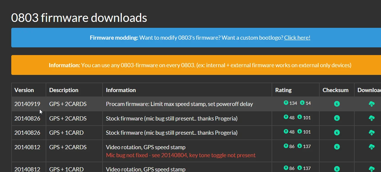

Thanks for the guidance on using the card reader; done that, but the file that I downloaded (from Tobi@s' repository!!) is a .bin file not a zip file and when I double click the file name, Windows says it doesn't know how to open the file and invites me to search the web for a program that will open it.
Did I download the wrong file from the repository?? I've taken a screen shot of what I downloaded.

That was my mistake I thought it was in a zip. He has them hosted as unzipped bins. take the file you downloaded and ignore the unzip part in my instructions.
Sorry about the confusion.
Take the file your downloaded rename it firmware and then continue as written.

I've done as you directed but still have a couple of questions.
The rename of the file to "firmware.bin" was OK, the update went ok as you described above, but:
a) is this official firmware as the camera no longer powers up to the screen showing the Corvette, but with some Russian(?) characters above a logo that reads "ProCam CX4"
b) when I long press the up arrow to go to the menu to check/make my settings, the menu is in Russian (or similar language) and not English did I download the wrong language version of the file from Tobi@s repository? I downloaded the file as shown in the attached screenshot.
This should be the official firmware for the Russian Version of the Mini 0803. It is called the ProCam CX4 in Russia.
No you just have to change it to English.
The Russian word for Language should be язык (Used Google Translate) if you go into your menu and click up the menus in reverse sort of it should be around 5 clicks up to change it.
