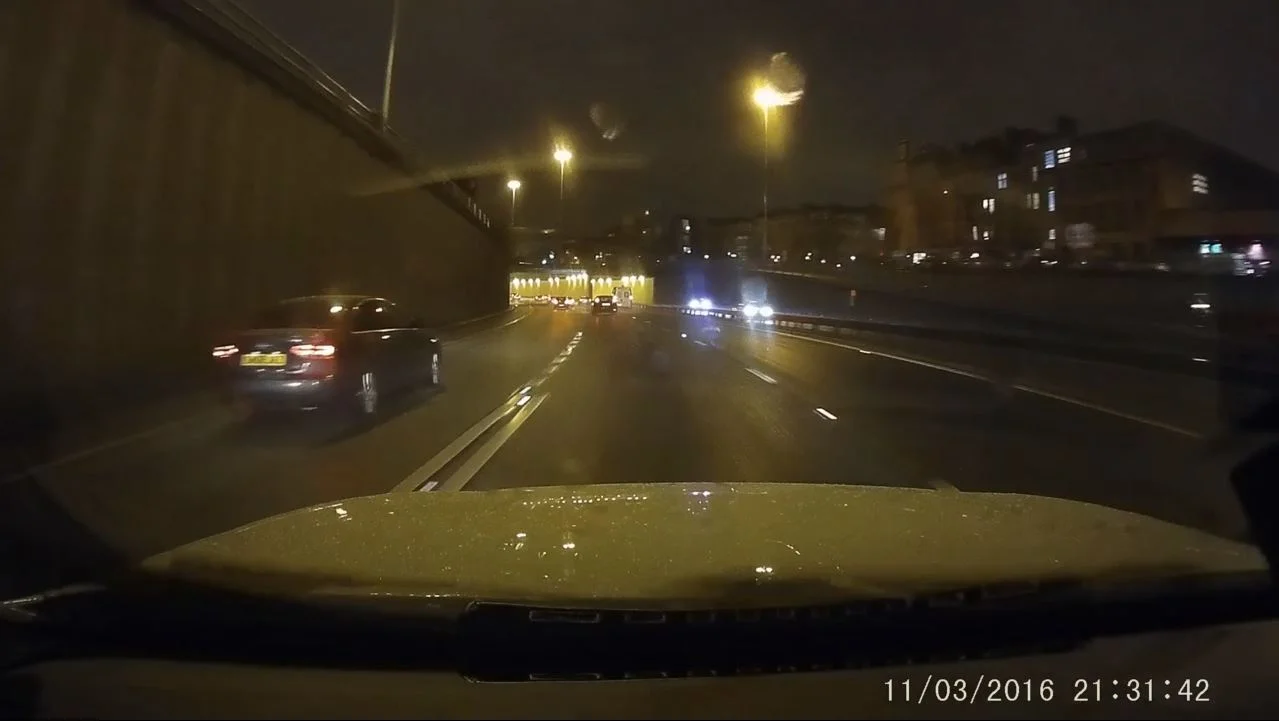

Here's a couple of screen grabs at night, the first I'm doing around 50mph and the other car is passing me slowly, perhaps doing 55mph and the ambient light isn't great but not too bad. His plate isn't that far off from being legible and I reckon it probably wouldn't take much of an increase in shutter speed to make it readable.

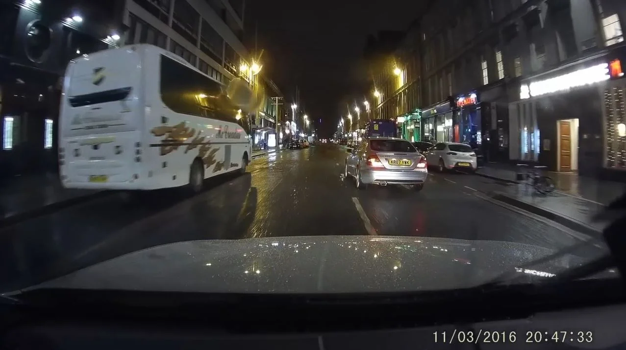

In the second photo I'm only doing about 15mph and the ambient light is much better. The car in front doing the roughly the same speed is very clear so it is probably using a higher shutter speed but the bus is completely burred, although it is stationary so that's going to have a big impact. I reckon it would take a fair increase in shutter speed to make that bus plate legible.
I think being able to read stationary plates at night at the moment is probably too big an ask, but it would be cool if you could have more manual control over things to suit your own desires or requirements or even for experimenting!

Just a thought, but motion blur - at least in such short time periods - is very linear. Is there sharpening software available that deals with such blurring. I'd be amazed if there wasn't.
It will never be as effective as fast shutter speeds, but I'm sure the results would be impressive. Especially as you know there is dark lettering on a pretty uniform bright background.
I bet there is a plug in for PhotoShop to do it, or maybe the latest version even has it built in.
Adobe Premiere has sharpening tools and there's various sharpening tools in Photoshop also but to be honest I doubt either will help much at this level of blur. I could give it a shot though, no harm in it!
