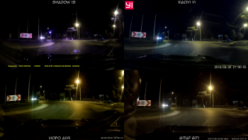

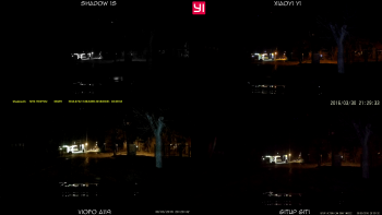

On the right are the XiaoYi and Gitup. Look at dark zones and you will see black, not black with blue tint in all images from all 4 cameras. I donyt see that brightness differences from screenhots uploaded by -Pyzdys- which were done to prove that XiaoYi is better than A3 in low light conditions. Of course XiaoYi can be better than A3 and any other dashcam but without any cheat is needed for this.
Original files will be available in YouYube description.
The following screenshots were taken from original videos without any reencode of any of them and the snapshots were saved is PNG format to preserve original quality.
My comparison is 100% fair without any trick or any cheat from any camera. As I wrote in YouTube description, the XiaoYi recording was done at 60FPS (I forgot to set 30fps) so maybe there is an advantage for XiaoYi regardin details.
enjoy,
Mtz
The Yi definitely has less motion blur but that's to be expected with twice the shutter speed. It looks great considering it's getting half the amount of light as the others. The Git1 looks to have the best resolution.
...the XiaoYi recording was done at 60FPS (I forgot to set 30fps)
not fair...
but even that 60FPS show something....
cameras that run at 60fps generally either drop to 30fps or start frame doubling in low light, did you check if either of these situations occurred ?
The framerate remains at 60FPS but when is not enough light the frames are doubled.

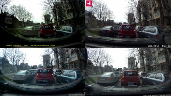

Yes, you are right but in the same day I made also daylight tests and the settings were the same. I prepared first the night comparisons because these are the most wanted. Some internet bandwidth problems are delaying the second comparison and two original files from first test to be uploaded on mega.
enjoy,
Mtz
We will see in next comparison during day after uploading the video on YouTube.
But I think XiaoMi Yi have focus problems because of heat. Just think I was at south-east Europe at about 45th parallel and I already have focus problems on XiaoYi dashcam on spring time March 30 when recordings were done. Look at the other 3 dashcams snapshots for focus problems if there are any. What will happen in the middle of the summer with the XiaoYi dashcam and its focus?
enjoy,
Mtz

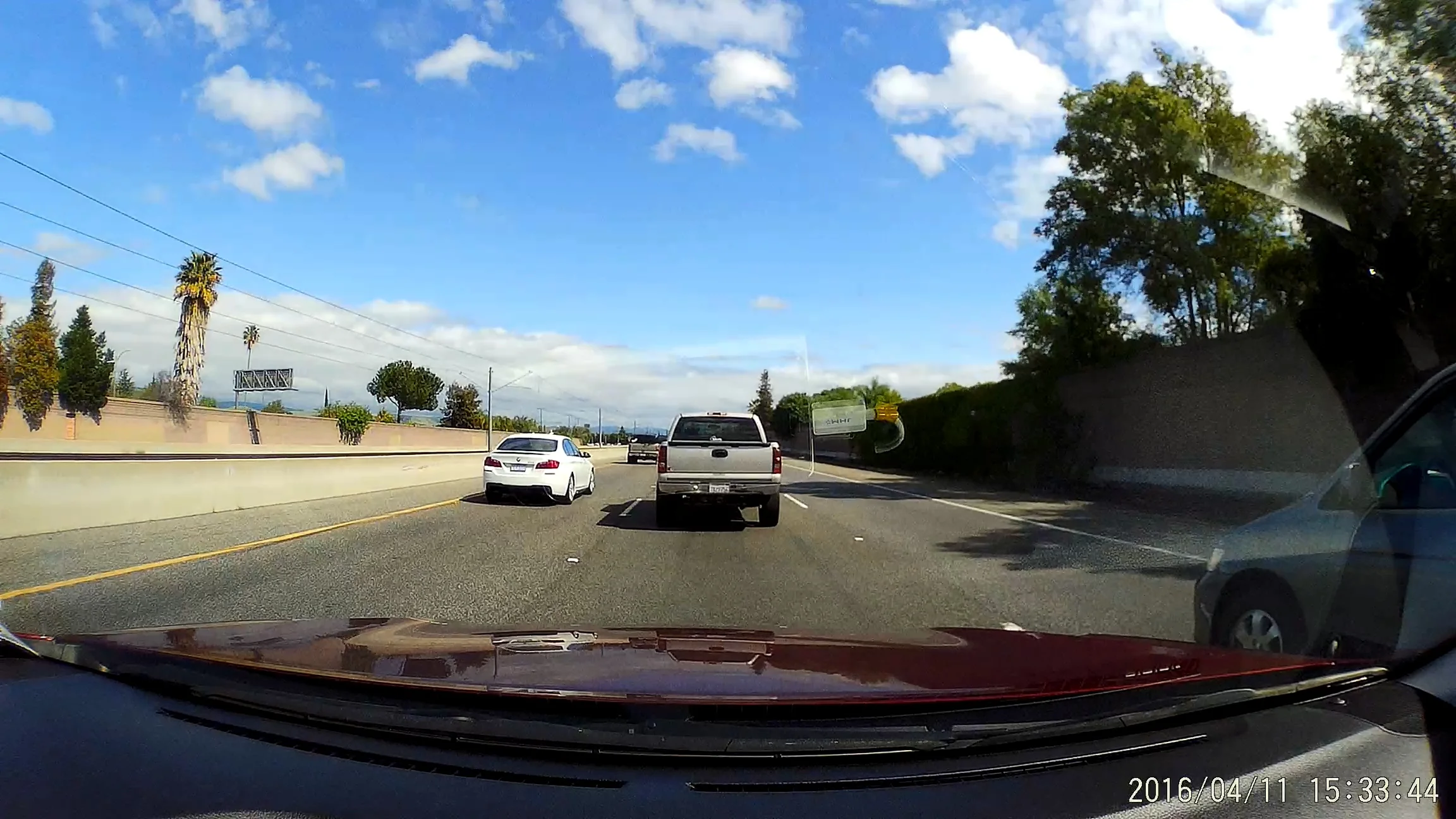

Does Xiaomi Yi have its own license plate reading software or are you guys using a secondary software to read plates (tia)?
hi,
I can't read lic plates from my YI
Do you have better quality?
