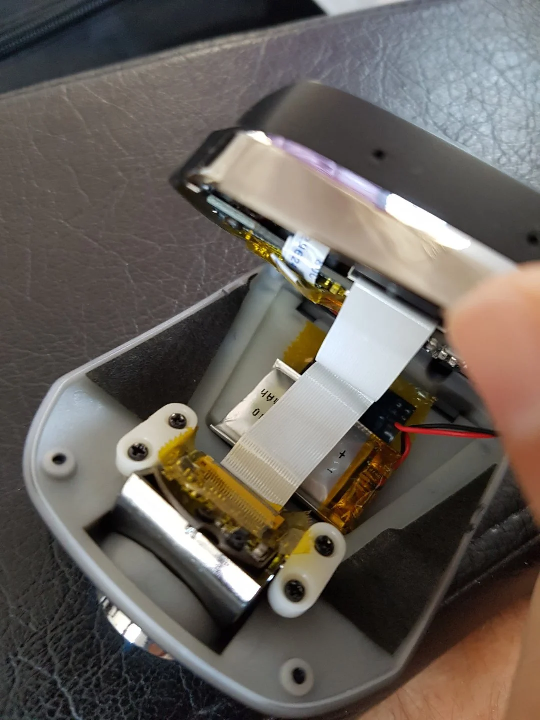

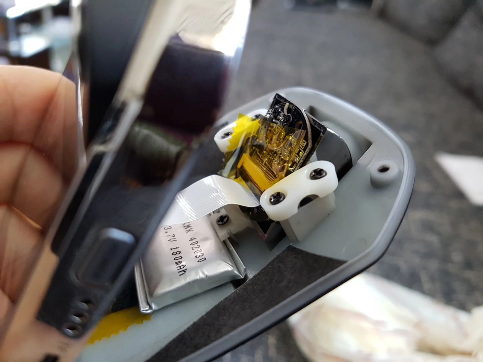

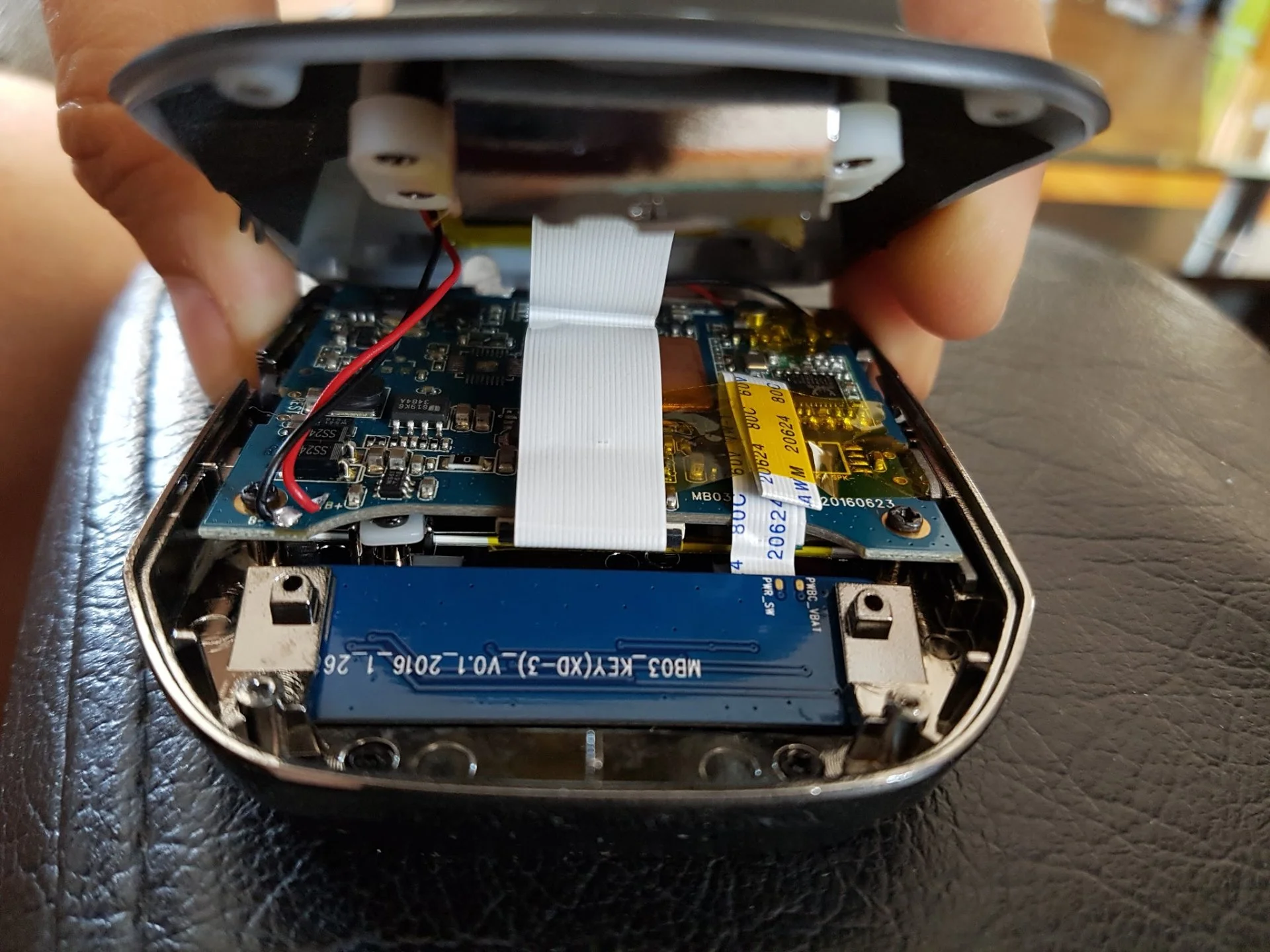

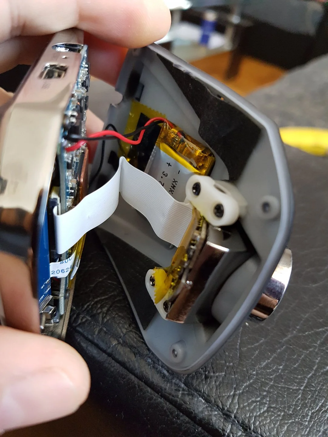

Could be, I have started taking it out when temperatures are over 30C degrees, but still no issues have been observed at all. The only time it was when there was a sunshade put to reflect the sun and while starting the dascham screen was all white (shade was reflecting sun to the screen), but quickly got back to normal.battery looks like it is swelling
yep definitely a swollen battery, have seen that before with some phones i've had with the internal batteries. better to run it in a cooler environment, or as you have done invest in a design with a capacitor.Could be, I have started taking it out when temperatures are over 30C degrees, but still no issues have been observed at all. The only time it was when there was a sunshade put to reflect the sun and while starting the dascham screen was all white (shade was reflecting sun to the screen), but quickly got back to normal.
Still have decided to replace it with the Aukey DR-02 due to the super-capacitor design for the safety.
not good that they swell that easily :/Battery can swell regardless of outside temperature. They heat themselves.
I have small drones that use similar batteries and they swell with few uses, even if I'm flying them in freezing cold.
