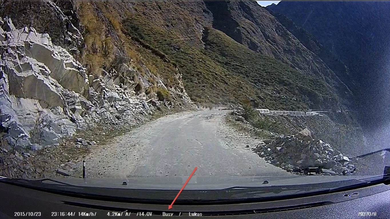

Last version of firmware did not allow for ex-fat format, the viewer is still FAT format only.
I'll try that dashcam ex-format with old 64GB sandisk card.
Another thing which i've noticed that when video mentions 'Busy'(instead of 'Always'), perhaps its busy writing the data and dropping the frames.

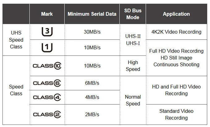

If i use a MicroSD with up to 48mb/s transfer speed.
EVO 64GB Class 10 Micro SDXC Card
Can this work well with the camera?
What is needed is that minimum writing speed must be more than 14 mb/sec. Class 10 means its minimum writing speed is 10mb/sec. UHS-3 with ex-FAT format is optimum for dashcams with twin HD cameras.
Another important characteristic is that the card should be MLC. You can check it on manufacturer's website if not mentioned on the packaging of card.
The SLC (Single Level Cell) type records 1 bit of data into a single cell. The MLC (Multi Level Cell) type records 2 bits of data into a single cell. TLC (3 level) is inferior to MLC.
So a MLC, class-10 card marked U-3 will be an insert and forget sdxc - 64gb or more.
It does not matter whether its micro or standard size.
