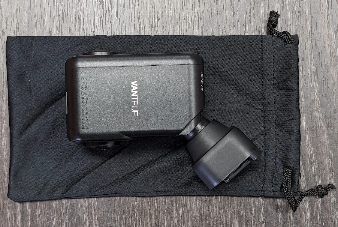

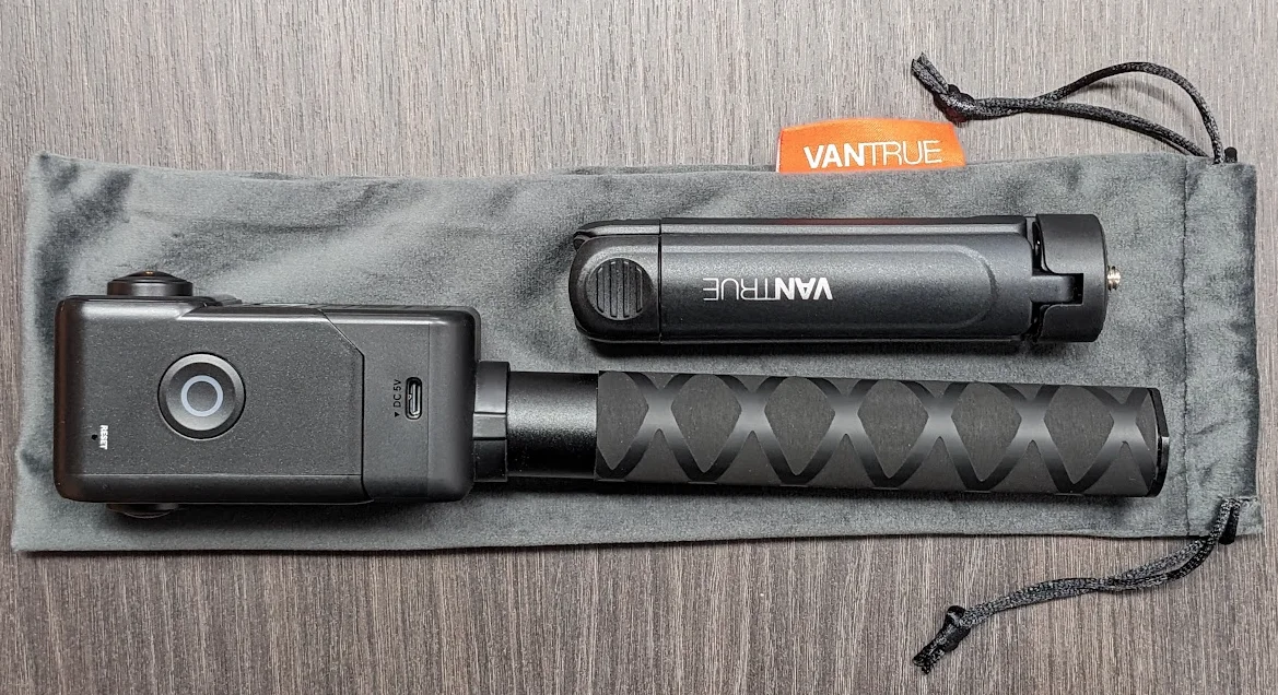

Vantrue include a very good soft bag with the Ace bundle for transporting the E360, the handheld mount and the mini tripod.
However, there is nothing provided to protect the E360 camera whenever it is not mounted in the car. Since it has a pair of ultra-wide lenses on opposite sides of the body, I am concerned that they are at risk of being scratched or otherwise damaged accidentally.
I have recommended to @Jeff_Vantrue that a small bag is included with the E360 for this purpose.
I am using a microfibre bag that originally came with a pair of sunglasses.
I remember dropping my brand new Ricoh Theta (360 camera) the day I got it. That was not fun.
Microfibre bag seems a good solution. A hard case would be expensive to get custom made, and lens caps are fiddly.

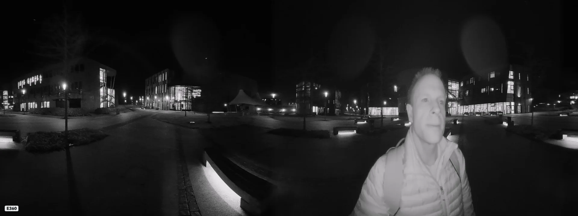

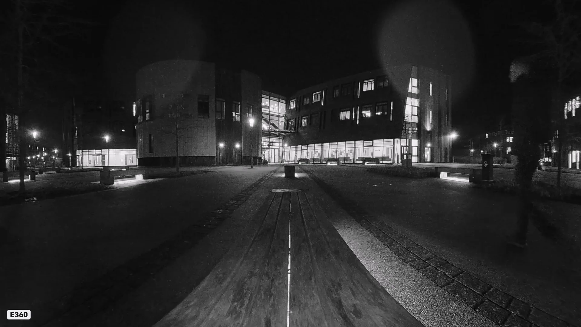

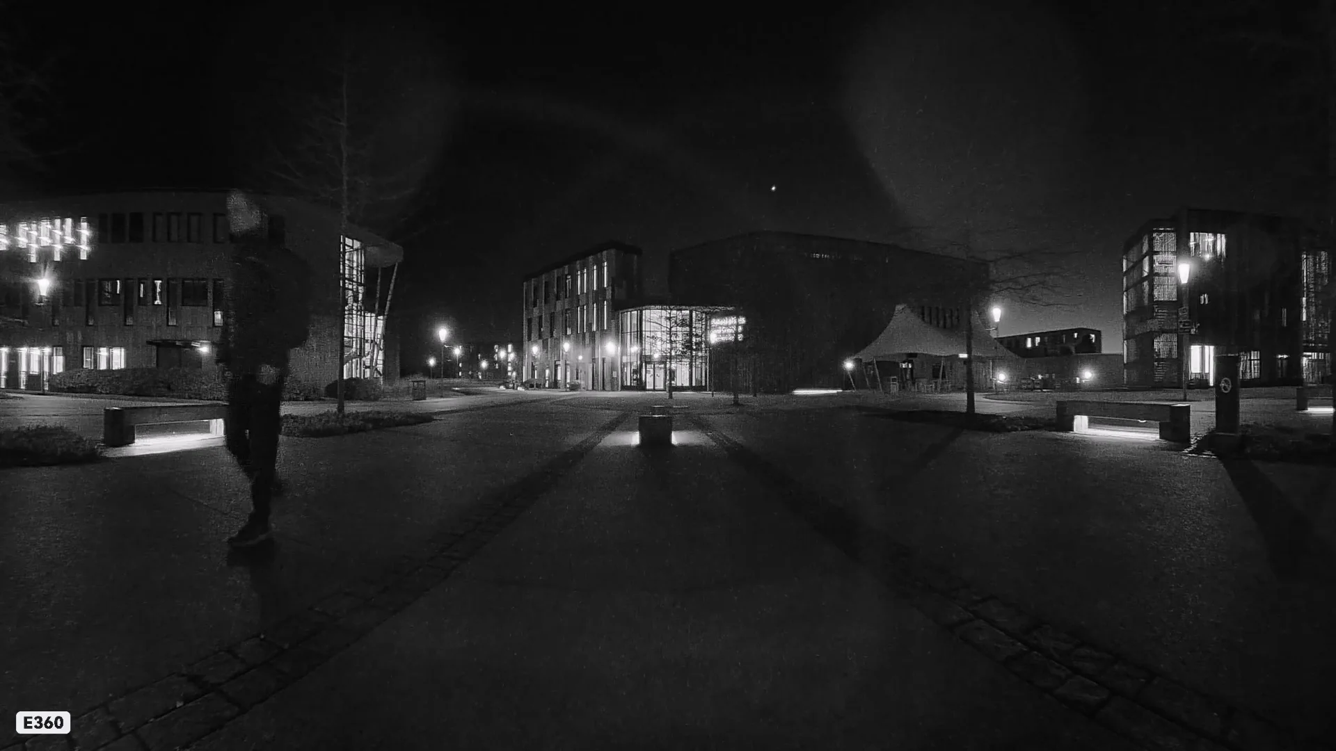

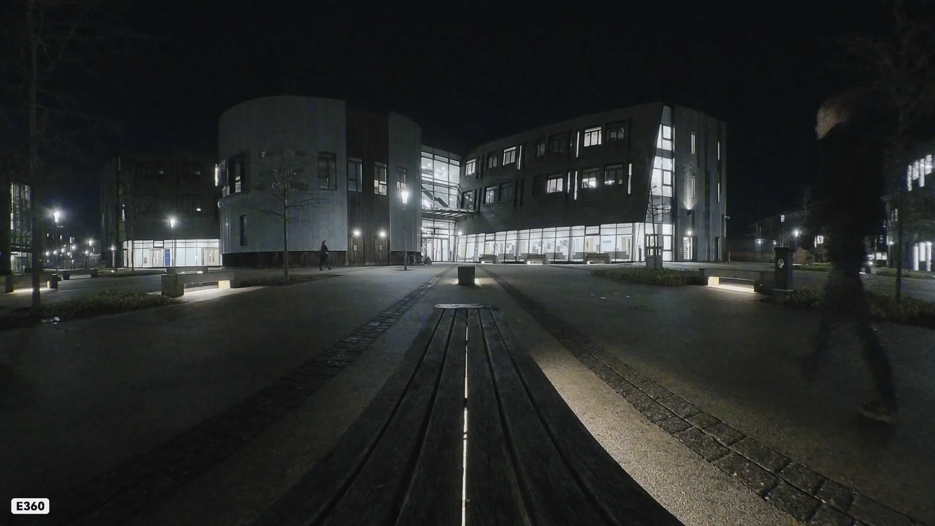

IR LED Glare / Reflection
The E360 has 4No IR LEDs for both its front and rear-facing cameras. The default settings are that the front LEDs are off when driving, and the cabin LEDs are automatic based on the ambient light level. In handheld mode, the LEDs can be set to on or off at night.
Reviewing some outdoor night test footage I noticed that both front and rear cameras have a 4-way pattern when the LEDs are turned on, which disappears in colour mode without the LEDs. Two of the bright spots are more noticeable than the other pair, but I think there are 4.
The same pattern can be seen twice on the merged panorama with IR LEDs turned on:
When I saw these artefacts in the dashcam videos I initially dismissed them as reflections within the car, however if they are present outside of the car then they must be caused by something else. They are most noticeable in the upper portion of handheld videos, and the lower portion of dashcam videos, which makes sense as the camera is 'upright' when handheld and 'hanging upside down' when mounted in the car.
I don't mind a bit of glare or reflection in parking mode videos. There's plenty of other reflections across the frame. But it could be an issue if I want to do some night time vlogging or timelapse with the IR LEDs turned on.
Each lens sits a few mm proud of the panel that contains the IR LEDs. Is it possible that the ultra-wide fisheye lenses are so wide that they pick up glare or have internal reflections from the LEDs behind them? I'll try to do some testing by shielding one or more LED emitters in a dark room.

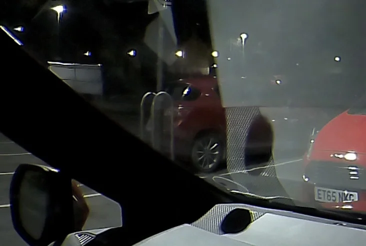

@TonyM Great review!
I just received the E360 Ace, and during my preliminary night tests in Panorama mode, I noticed a drop in image quality. Interestingly, you didn't seem to encounter that issue—any tips?

Looking at the night video I have recorded, I do see a drop in quality compared to more conventional dashcams. This camera is not good at detail like number plates.

Not Tony, but I experienced the same thing.
At night the performance could be better.
Plate capture is not possible if further away than about 5m and moving away or approaching at higher speeds than 5-15kmh.
I did swap the E360 between cars to see if the headlights would make a difference.
At night the E360 could be compared to the A229 Duo.

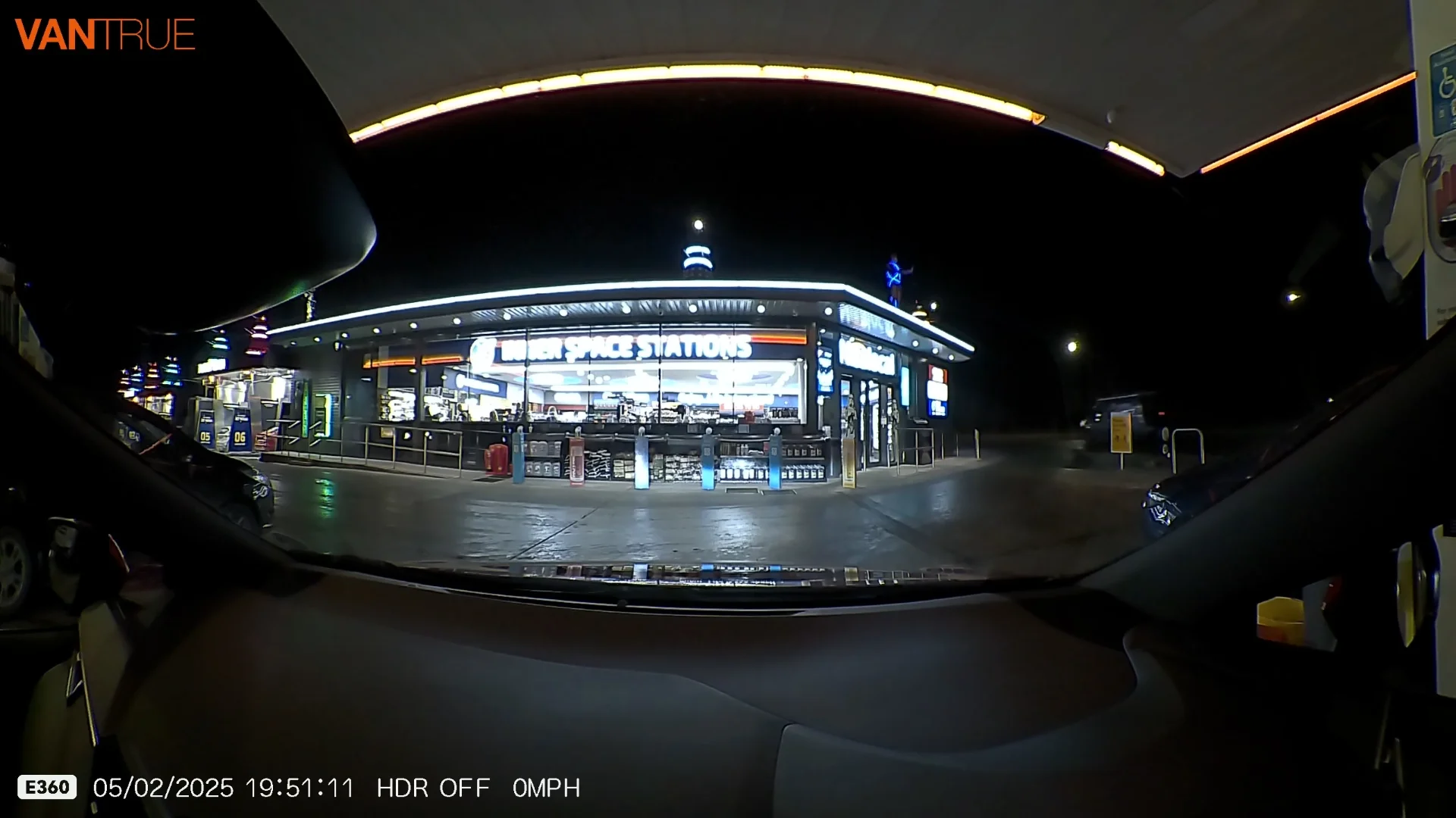

E360 Parked at Night - HDR ON/OFF - Example 1
I finally had some spare time on a rare winter evening with dry roads, so I washed the car and recorded some driving and parked footage, including a few HDR On / Off comparisons.
Here's a couple of screenshots with HDR On and Off, followed by an animated GIF.
The videos were recorded at 1440P30.
Looking at part of the image at 100% we can see more detail in the HDR image. With HDR turned off it looks as though some edge and texture detail are lost to noise reduction.

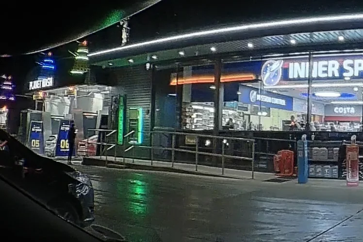

E360 Parked at Night - HDR ON/OFF - Example 2
A second example of HDR On and Off, recorded at 1440P30 when parked.
Again, we can see more detail with HDR On, even in the low-contrast shadow areas
