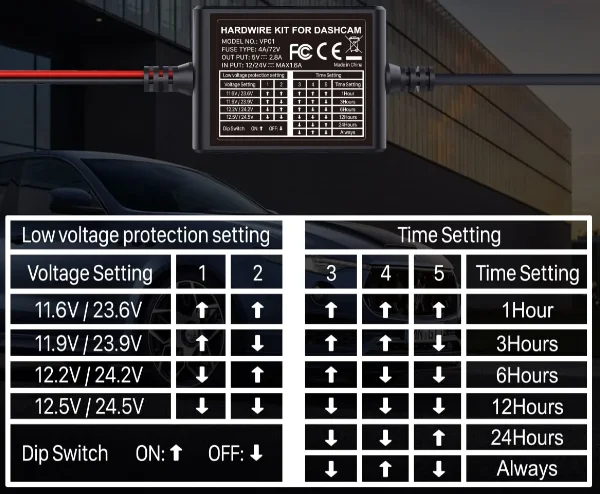

There are two different hardwire kits that you can use to connect the E360 (or any Vantrue camera, really) to your car's battery: the VP03 and the VP05. Each has settings for protecting your car's battery so you don't walk out to a dead battery.
The VP05 has three different voltage settings for protecting your car's battery: 12.4v, 12.0v and 11.6v.
The VP03 has two voltage settings to protect your car's battery: 12.0v and 11.6v
You forgot the VP01, which has four voltage cutoff levels (11.6V, 11.9V, 12.2V & 12.5V) and 6No parking mode timer settings (1hr, 2hrs, 4hrs, 6hrs, 12hrs & 24hrs)
Ah, that's right. I don't have one of those. This one is probably the most flexible/useful because it has more settings for voltage AND the timer function. It might be interesting to build the parking timer functions from the hardwire kit into the dashcam itself. @Jeff_Vantrue
