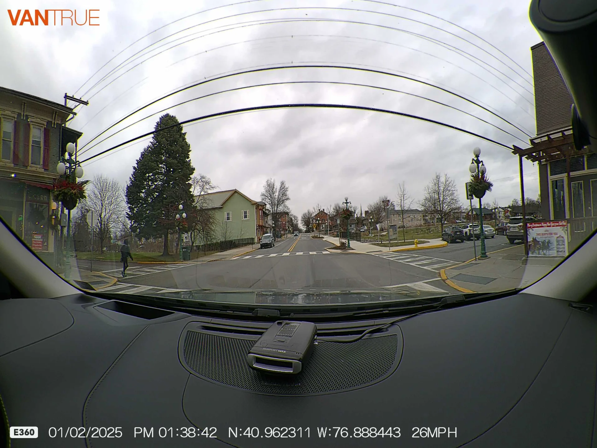

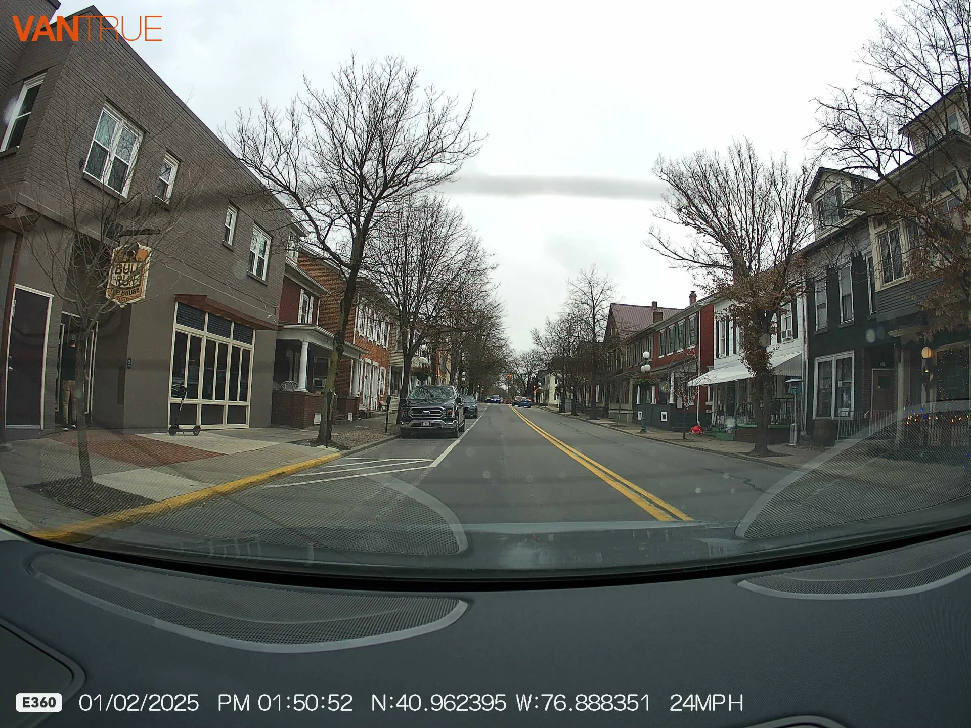

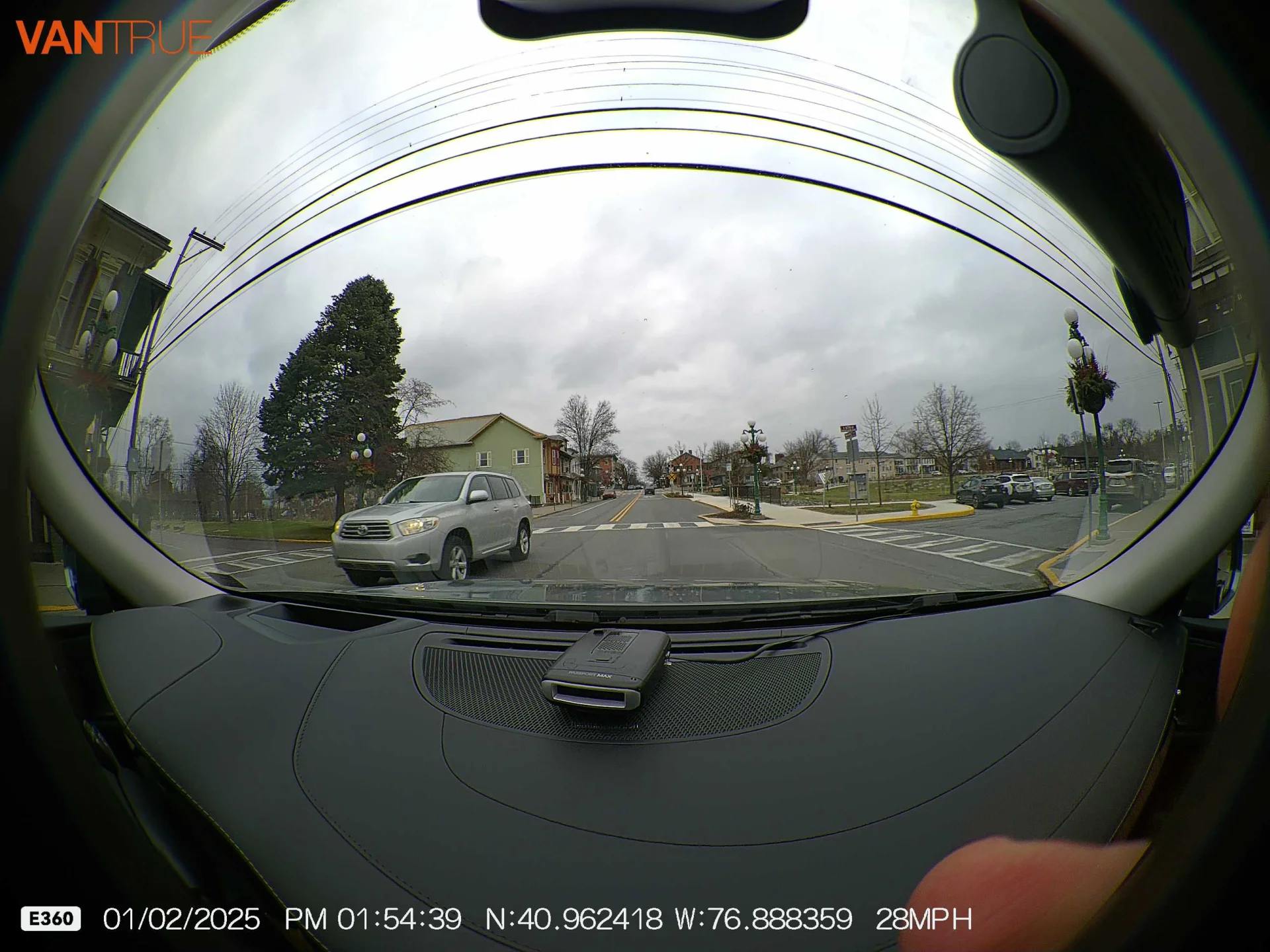

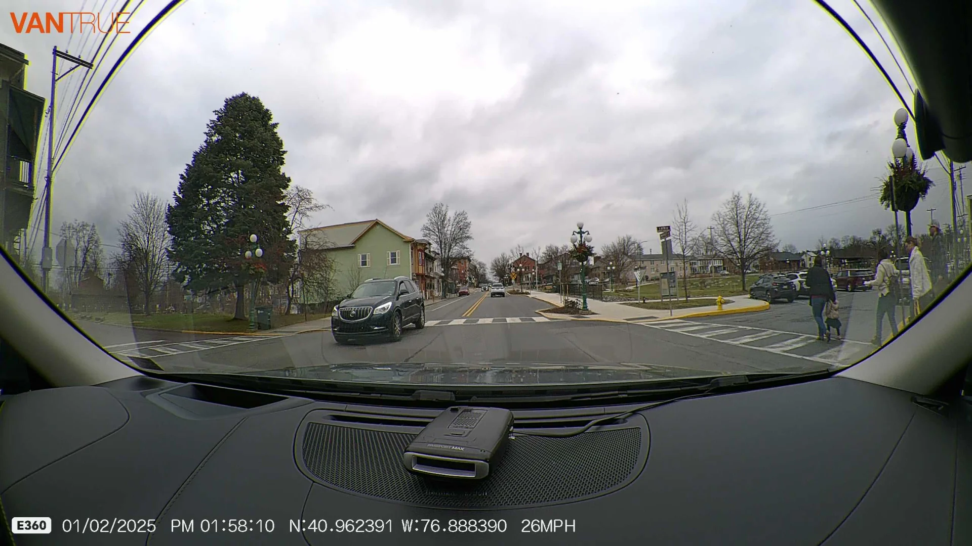

For drive mode, I think I prefer the "standard" (non-fisheye) 2560x1440 or 1944x1440 resolutions the best. There are so many different combinations of cameras and resolutions to set, it is difficult to make systematic images and movies from each setting and not miss a setting somewhere. While these resolutions are not the highest available, these settings (to me) seem to provide the best level of detail for normal driving situations. When coupled with the wide angle view of the E360 camera (210 degrees) is really impressive coverage for all-around protection! Higher vertical resolutions seem to include more sky and more of my dash, neither of which add very much to the protection of your car under ordinary situations.
For parking mode, I think I would likely select the panoramic view. The stitching between cameras is really impressive. Depending on the setting and the lighting, sometimes you can see where the images were stitched together, other times not, but this isn't an issue for me, it's still really impressive technology.

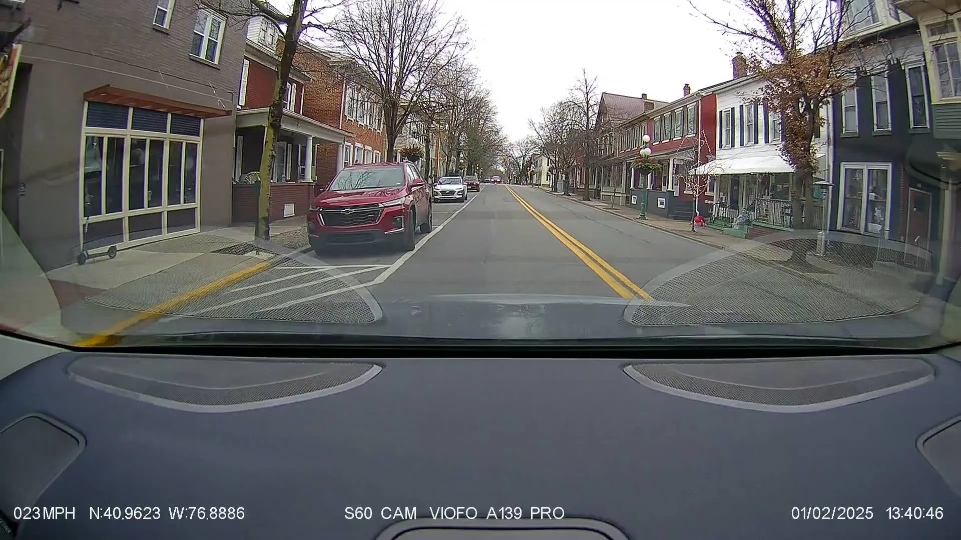

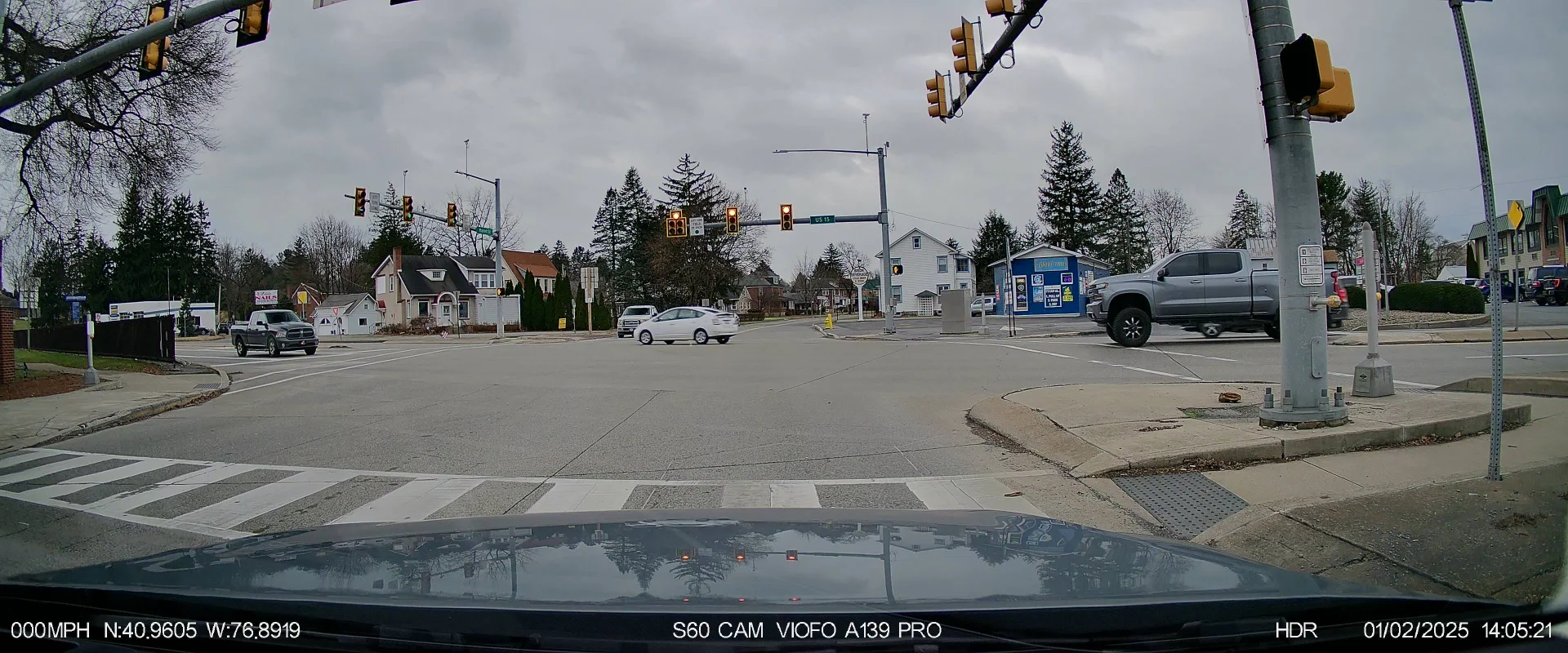

To see what this tradeoff is, I made two images from the exact same vantage point at the same time (I was stopped at a traffic light) with the Vantrue E360 and my Viofo A139Pro, each at their highest resolution setting.
Here is the Viofo A139Pro Front Camera, 837kb, 3840x1600 resolution, 6,144,000 pixels, 140 degree field of view:

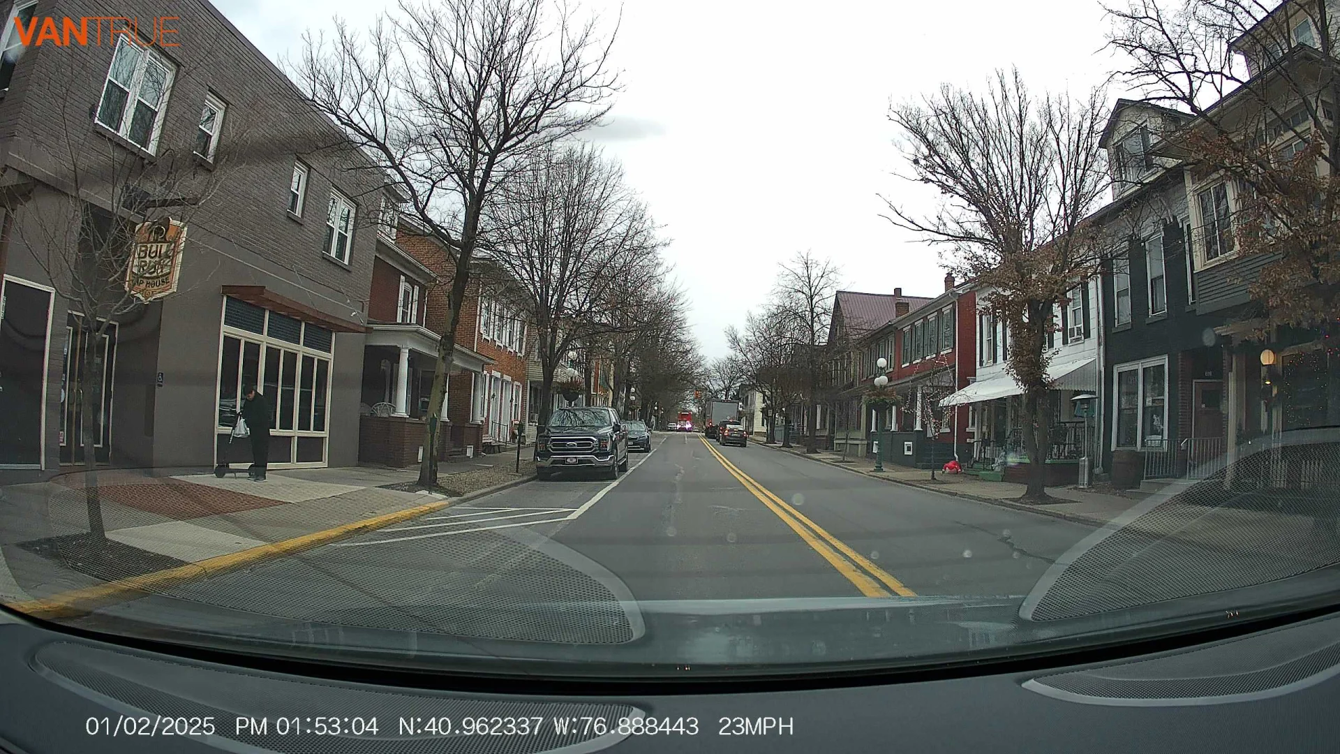

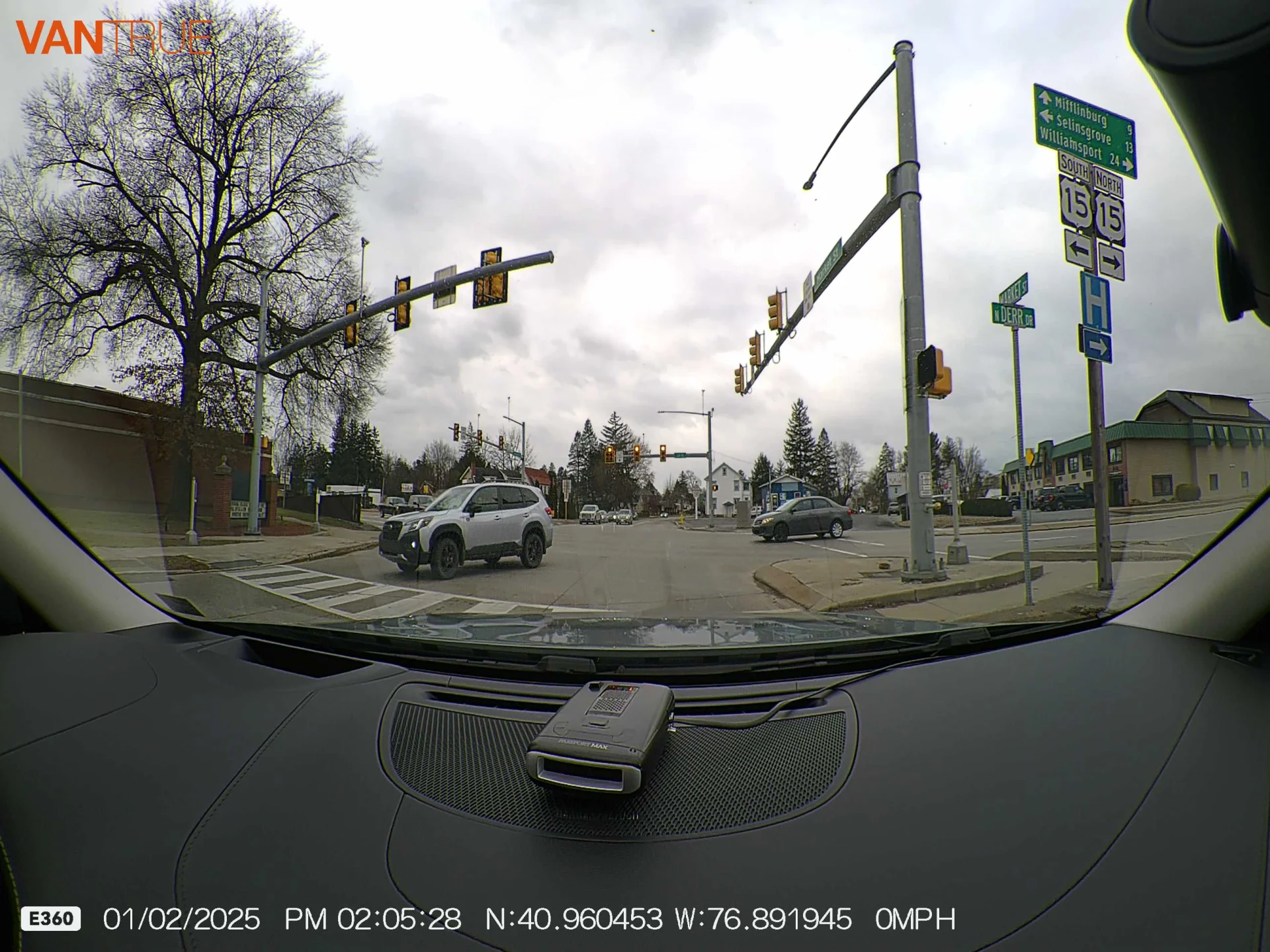

Here is the image from the Vantrue E360 Front Camera 391kb, 2592x1944 resolution, 4,976,640 pixels, 210 degree field of view, made a few seconds later from exactly the same spot:
Given the greater vertical angle of coverage of the Vanture camera, it is difficult to make precise filesize comparisons for the above images because the Vantrue camera includes more sky and more dash (which are more uniform in color/texture and thus will compress more easily when a JPG image is created).

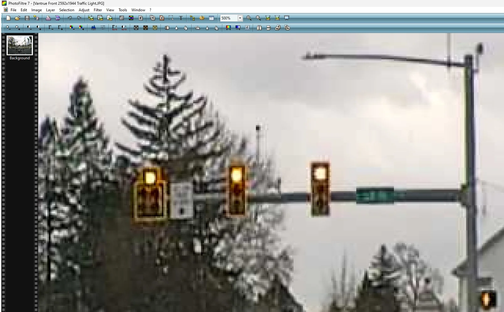

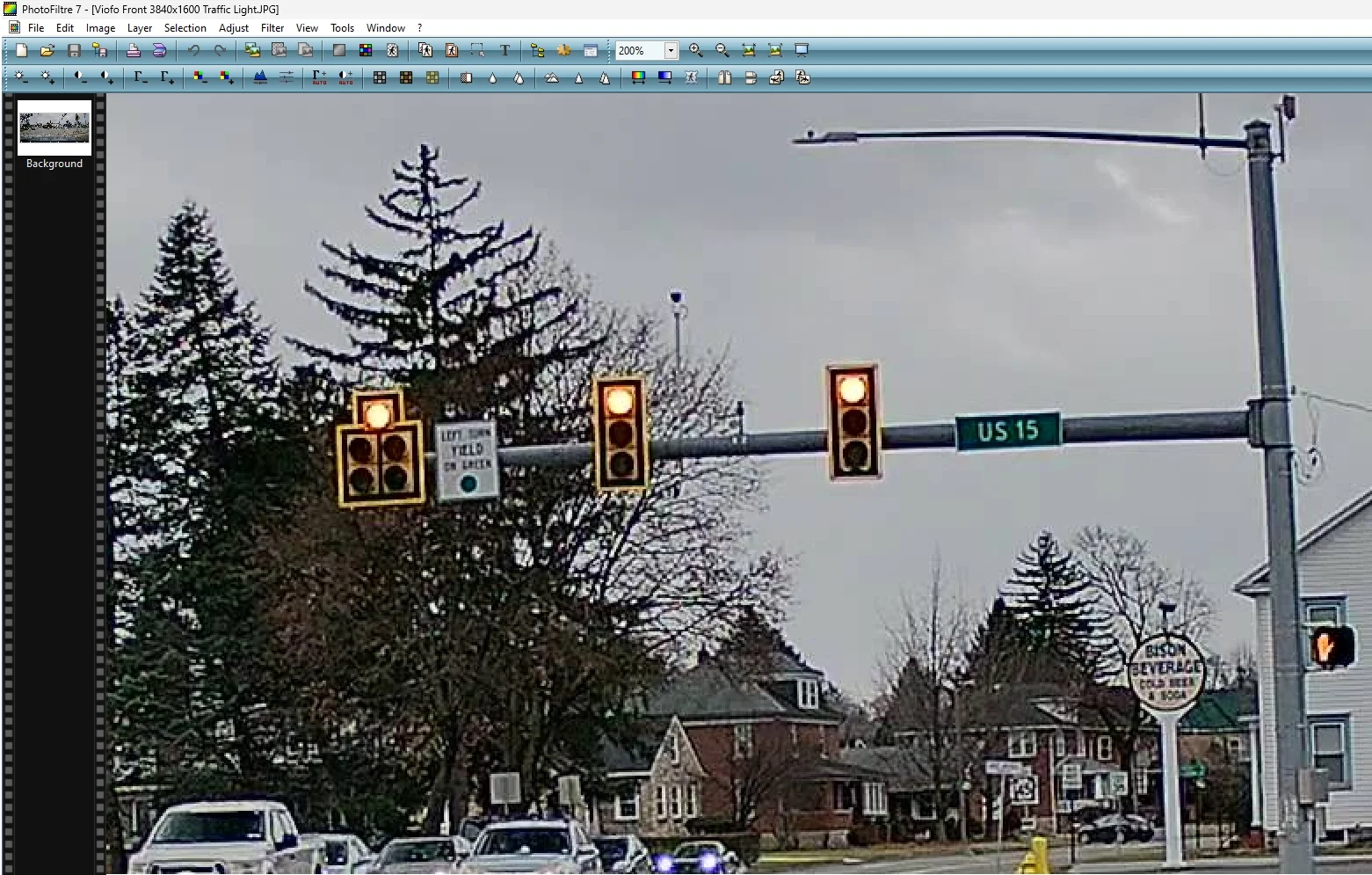

Overall, the Viofo image is a bit more clear while the Vantrue image shows a much wider angle of view. In an effort to more accurately compare the resolving power of each camera, I zoomed in on both images so the traffic light consumed about the same amount of screen width. This is definitely NOT an apples-to-apples comparison because of the obvious differences in lens curvature and corresponding angle of coverage of the respective cameras.
Below is a 200% zoom from the ViofoA139Pro at 3840x1600 resolution, 140 degree field of view, 27 pixels per horizontal degree of coverage:
Below is a 500% zoom from the Vantrue E360 at 2592x1944 resolution, 210 degree field of view, 12 pixels per horizontal degree of coverage:
Now, before you get too wrapped up in the details, recognize that the lettering that you can see on the traffic light in the two above images is WAY larger than the lettering that you'll find on license plates, so NEITHER camera does an awesome job at capturing plates beyond about 15-20 feet.
The advice that everyone has about reading aloud the license plate number following an incident on the road so it is captured on the audio of the recording is applicable to BOTH cameras. It is important to recognize that there is never a "best" for any product. This is the hallmark question from the newbie on every special interest forum (speakers, audio amplifiers, racing bikes, cars, etc) is "Which of these XYZ devices is the BEST?" This question cannot be answered without context. Best for what purpose? Best in which context? Best for accomplishing what goal? The details of use are an important factor in determining which product best fits a desired use case.
The Viofo A139Pro is a sharper camera (greater number of pixels per horizontal degree of coverage), but still fails to capture plates beyond a few car lengths away. It has a much more narrow field of view, though, and using it in parking mode will certainly NOT capture who dinged my door in a parking lot.
