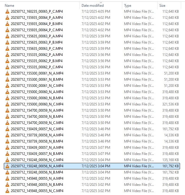

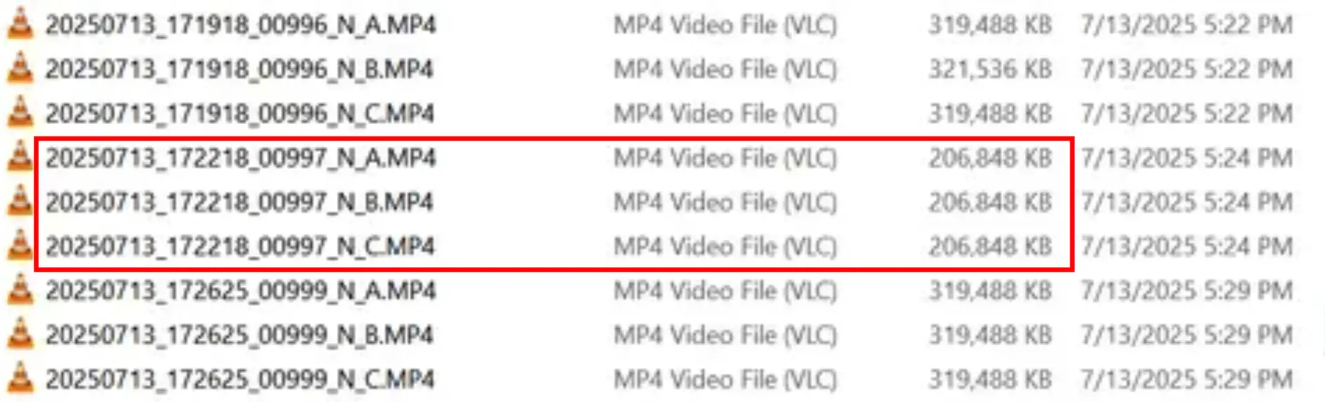

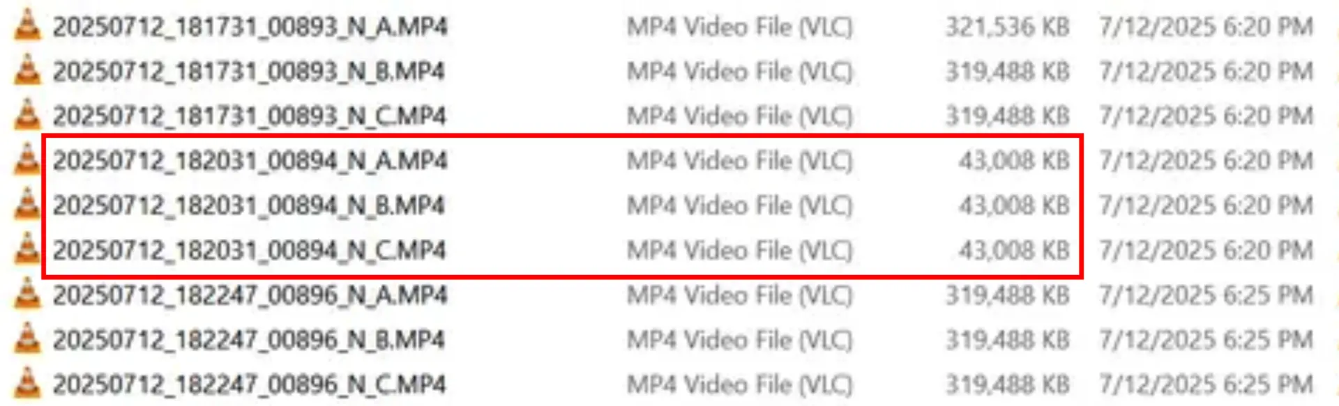

I've been exclusively using Vantrue provided SD cards with the N4S. I've reformatted the cards multiple times. I'm still seeing random video captures missing. The rear camera drops out first, then the others follow. The recordings seem to eventually start back up again on their own. I haven't been able to detect any pattern to when the video drops out or when it returns. Sometimes during parking mode, sometime during drive mode.
EDIT: The only consistency that I'm seeing is that the video file from the rear camera is one that is missing first if you compare time stamps. Sometimes it's only the rear camera that stops. Other times, all cameras stop recording. But the first missing file is always from the rear camera.
