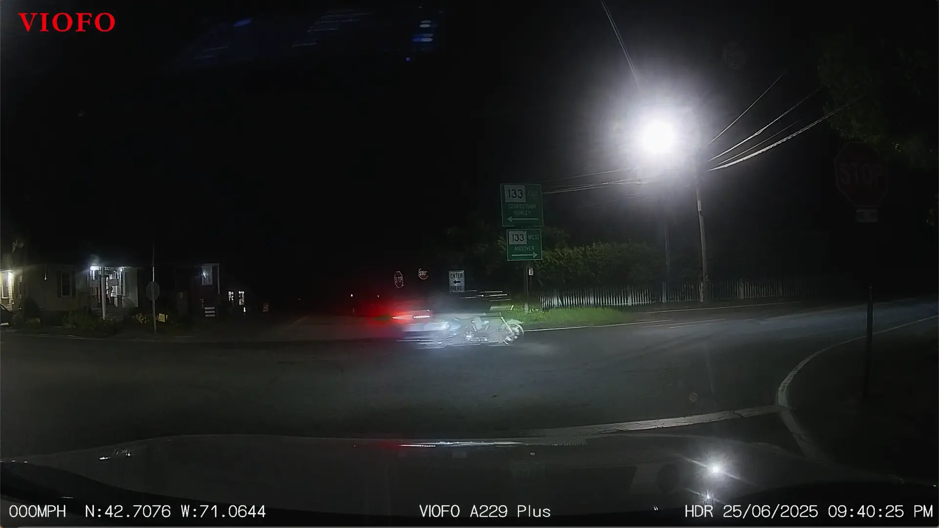

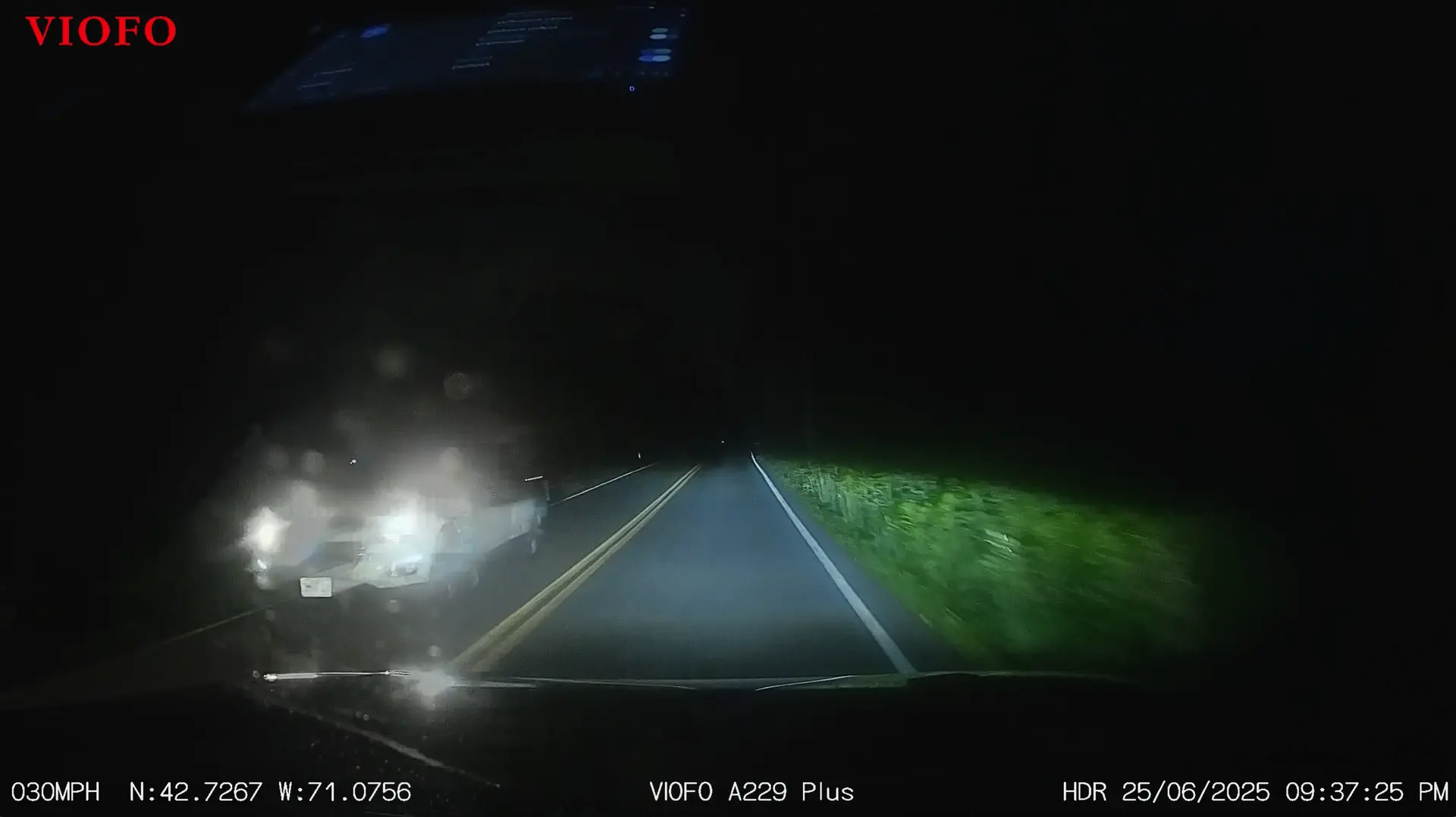

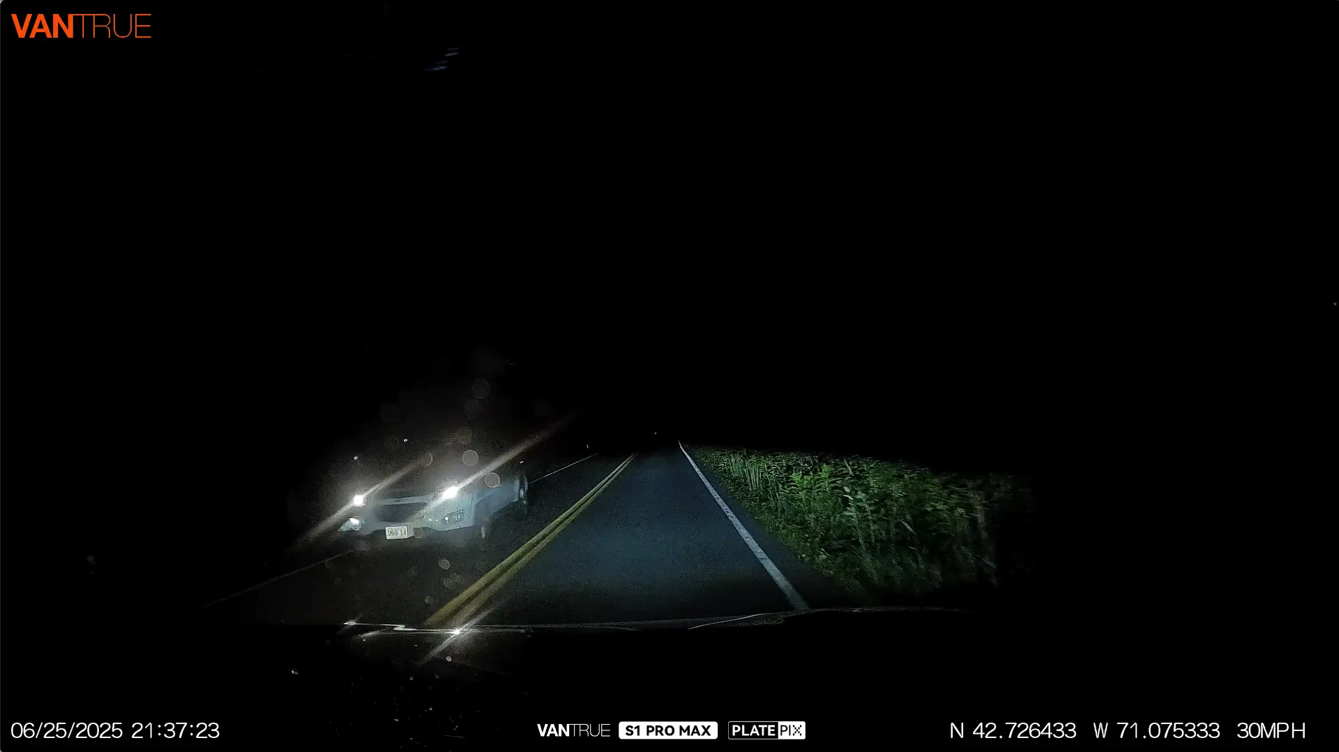

Night time footage of S1 Pro Max and A229 Plus:
S1 Pro Max shows much greater detail where my headlights were directly shining, such as the motorcycle (first and second images) and the license plate and front of an oncoming car (third and fourth images)
Areas not lit well by my headlights are very dark and in some cases cannot be seen at all (yellow building on left) with the S1 Pro Max

A229 Plus HDR ON
S1 Pro Max PlatePix ON
A229 Plus HDR ON

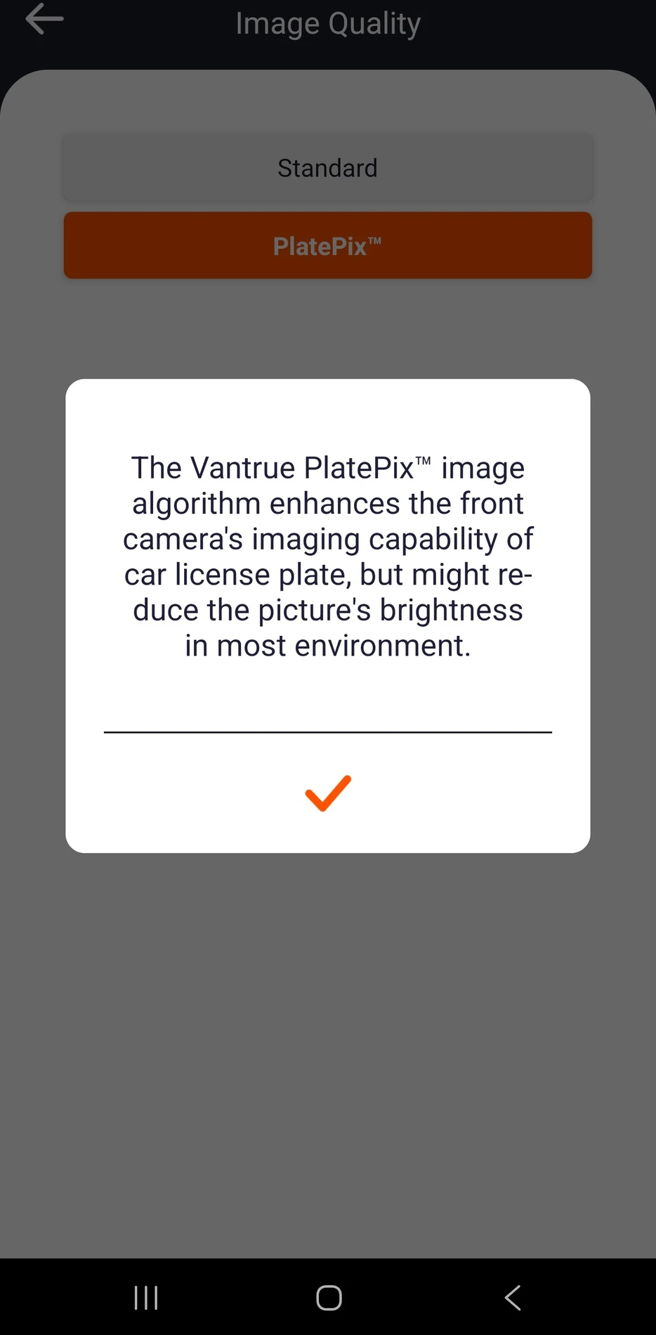

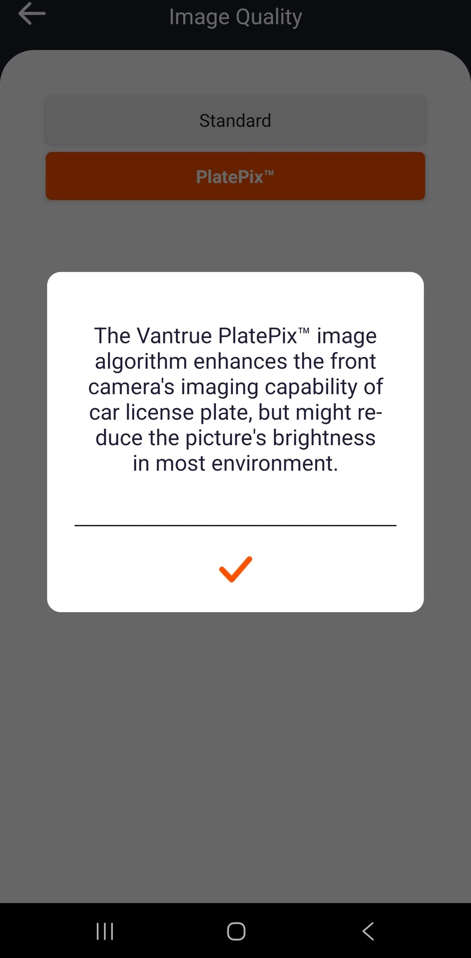

Until then, take a look at this article. PlatePix is more than just HDR, and it's not just for use at night:
My preference would be for Vantrue to incorporate PlatePix into the default mode, reduce the 'strength' of the effect so it's less of a compromise in shadow areas, and remove the on/off option since it seems to cause confusion amongst DCT members and presumably amongst customers.
