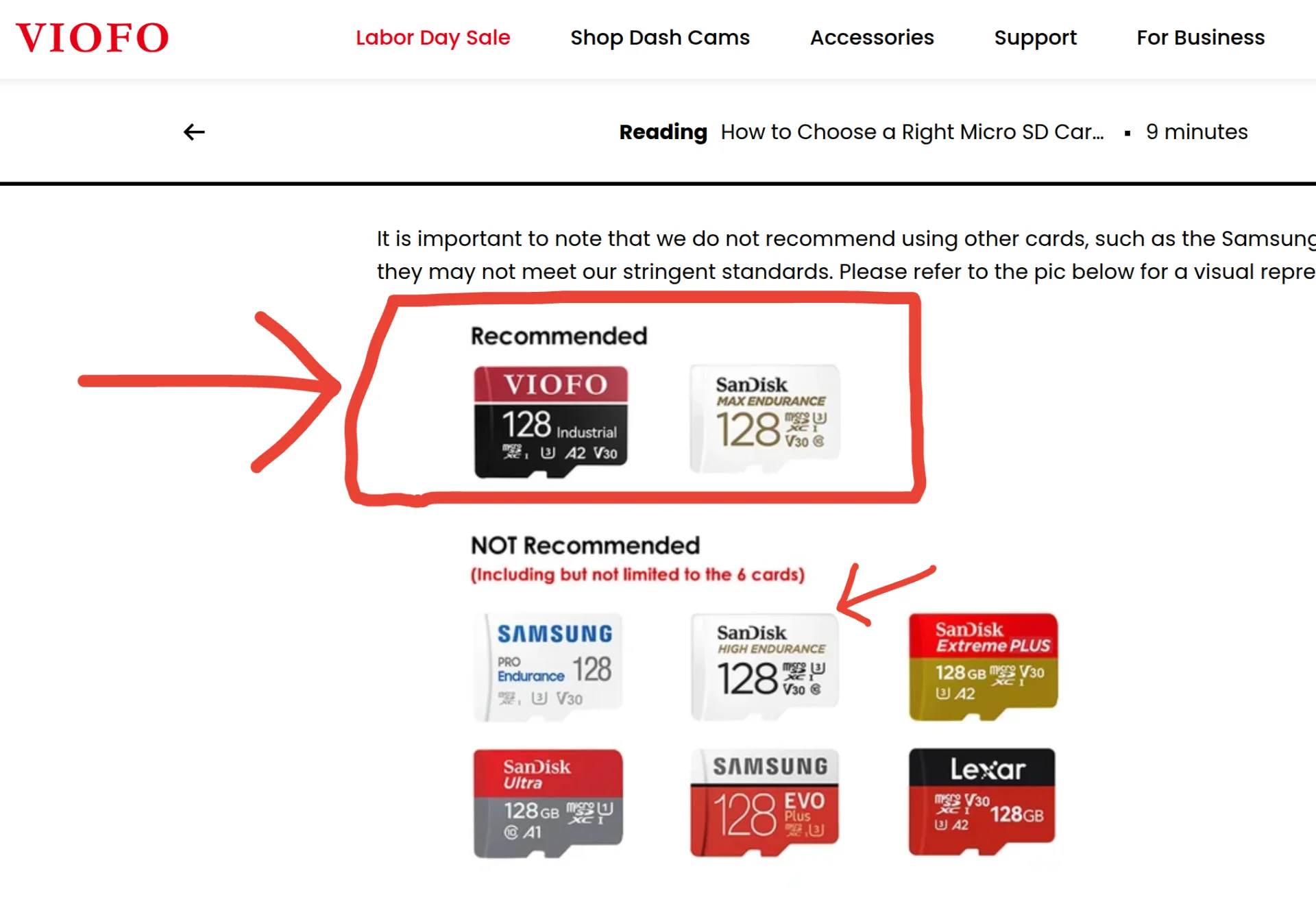

If you have a VIOFO dash cam, currently there are only 2 recommended SD Cards.
1.) VIOFO Brand
2.) SanDisk MAX Endurance.
Do not confuse SanDisk HIGH Endurance with SanDisk MAX Endurance, (see attached screenshots).
SanDisk High Endurance is NOT recommended.

SanDisk HIGH Endurance was never an Official VIOFO Recommended SD Card?
In fact it’s on the Official “DO NOT USE” list right?
