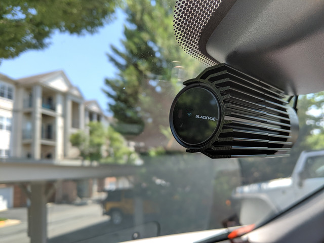

UPDATE: 20/6/2019
I came to my car today around 1:30pm and it was parked outside since the day before
Outside temp: 105f (41c)
Temp inside the car: 158f (70c)
Double heat sinks temp: 168f (76c)
Cam shell temp: 162f (72c)
The cam was working fine without issues

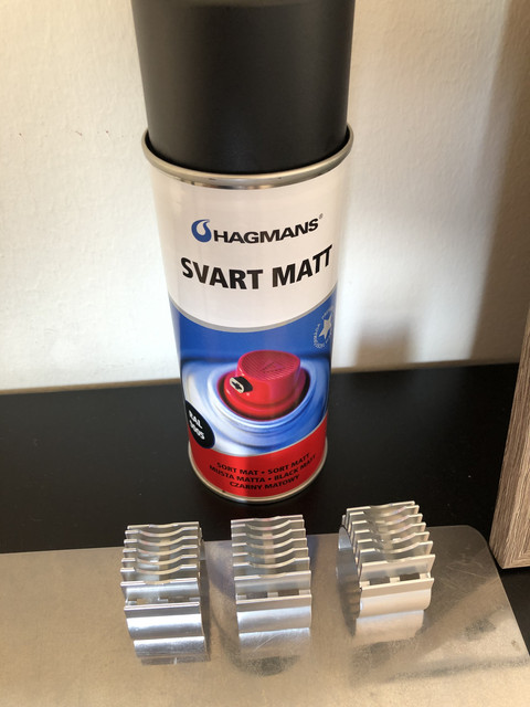

Cheapo $3 40*40mm ebay heatsinks. Fits like a glove. It did scratch the housing because it requires snapping on. 80mm is slightly too long so I'd recommend buying a 40mm+30/35mm.
I also ordered a $5 graphite pad from aliexpress but it hasn't arrived yet. It would've prevented the scratching but it was too tempting not to put the heatsinks to use. Thermal paste is too messy and traditional thermal pads are too fragile. Graphite pads are perfect. Cut to size using an xacto knife.
As for the effectiveness... I don't know. The housing is plastic and plastic is an extremely poor conductor. And the housing isn't even connected to the internals.
In an ideal scenario the heatsinks should cool down the housing and thus cool down the ambient air around the internals. But during my brief testing the heatsinks got uncomfortably hot to the touch, I didn't bother digging out my thermal gun but it was easily above 100f. Maybe the larger black surface area of the heatsink is absorbing its own heat and making the dashcam hotter?
I can't really tell how well this works without placing a thermistor inside or something.

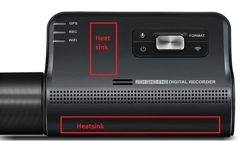

Sorry to highjack. I saw OP and a few other successfully achieve heat issue and would like some input. Was wondering would any heatsink work? I have Q800Pro and it shutoff at 80F and above outside temp.
Can I use something like this to help with the heat issue and placed as picture? https://www.amazon.com/gp/B07CVVPC7SThank you
