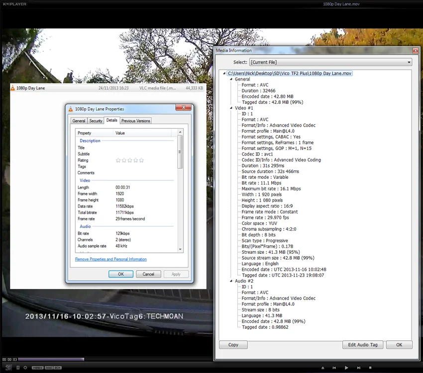

Question for VIco TF2+ users: Did Vico raised a bit-rate lately ??
As I remember, previous TF2+ version had lower bit-rate than mentioned in his review ( 13-14Mbps bit-rate ? )
Downloaded first video clip and analysed with KMPlayer and Windows properties. It shows me different values for total and date bit-rate.
Also want to point out at one more probably negative side, that Vico TF2+ records at 29.970 Fps, not full 30Fps, - this is disadvantage for those who want to use video editing softwares. Many of those video editing softwares I have tested ( even so called professional ones ) are very fussy for editing video clips with different Fps ( I think it has been asked in Blackvue thread ). If you want to work on more than 1 video clip, where others clips have different fps value, then program just sending you an error or freezes, etc. I am not telling oll video editing softwares are like this, but many of them I have work with. So just for those who plan to edit in future, need to pay attention on those small details.

Can you comment of why different data displayed on my screenshot from video properties. I want to understand this. You know better answer.
I think what you see reported in Windows properties is just an overview or summary and isn't completed with a great deal of analysis of the file
Thats why me and Techmoan ( and others ) always get different data readings, which confuses.
I havnt found yet most correct way to extract true data properties from raw video files. Do you know how its proper way to do this so the bit-rate and other data on techmoan review can be true and confirmed as well as for any other dash cam video clip properties.
I don't know of any industry standard or even any standard that everyone adheres to, measurement standards in electronics are vague at the best of times, to be fair though to the average Joe the data rate is nowhere near as relevant when judging products as the actual files produced, the numbers are just bragging rights in a lot of cases but don't actually amount to much
I agree with you partially about "average Joe" but more and more people educating themselves by coming out from that "average Joe status" and to be honest even average Joe can read difference between 11Mbps and 16Mbps as KMPlayer shows or Windows properties.
One vendor ( reseller, reviewer etc ) takes one figure ( 11Mbps ) and other vendor shows other figure ( 16Mbps ) , thirds one ( techmoan ) writes 13-14 Mbps, then it will be confusing for everybody, especially for average Joe and of course he buys from vendor that advertising higher value bit-rate thinking that it has product with newer firmware. Hope you see my point.
For the past 3 y I have been "married" to about 65-70 dash cams but this data properties issue is still confuses me.
I guess many other forum readers would also like to know "where is the truth" 😉
I am happy to read any comments on this issue from you or any other wise people, so me ( and others ) can educate themselves.
I think the lines get blurred when some of these cameras use VBR instead of CBR so what do the reviewers post in their reviews, average, best, lowest, add to that the results can vary dependent on hardware revision, firmware version etc and it's not a level playing field, some people get hung up on numbers but they don't always tell the whole story anyway, just having the highest bitrate doesn't automatically equal the best result, best decider is view the raw files, if you're happy with the results is far more important than if some other camera claims some better set of numbers or whatever, all well and good being 'good on paper' but it's real world results that count
