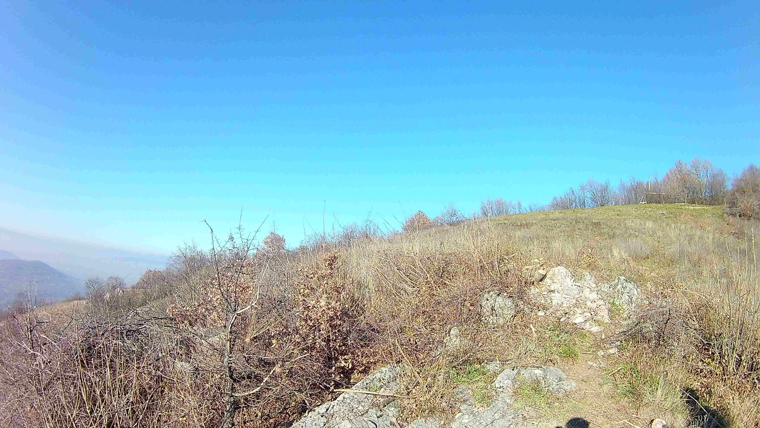

Do you think that a real 4K is looking so bad?
