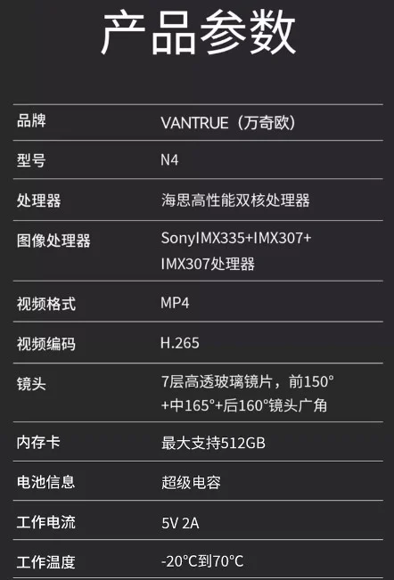

Any proof that Vantrue N4 is a fake 4K dashcam?
N4的图像传感器是IMX335,从视频看觉得达不到真4K的效果

Where did you find that information about IMX335? On their site they do not specify what sensor it's using.

Sorry I'm not good at English,But I will try my best。The following figure shows the parameters of N4,It's from Taobao,China。
I dont think IMX 335 will be able to compare so good as the N4 do to starvis 2 cameras like from Viofo, here i am thinking on everything but resolution.
Could be a error on a specific listing on Tabao ? it would also be strange if only 1 place listed IMX335
The parameters are indeed correct,I have used N4 before,be very disappointed with it。I have already sold it。
