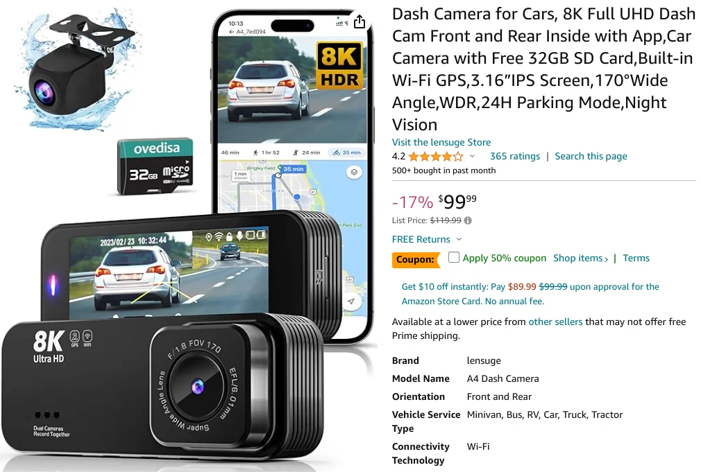

Now that we have Fake 8K dash cams does that count as industry progress?
https://www.amazon.com/gp/B0CGF5Y9M3
Maybe the FTC should crack down on Amazon for aiding, and abetting manufacturers whose sole purpose is to produce counterfeit items, and sell them with false advertising.

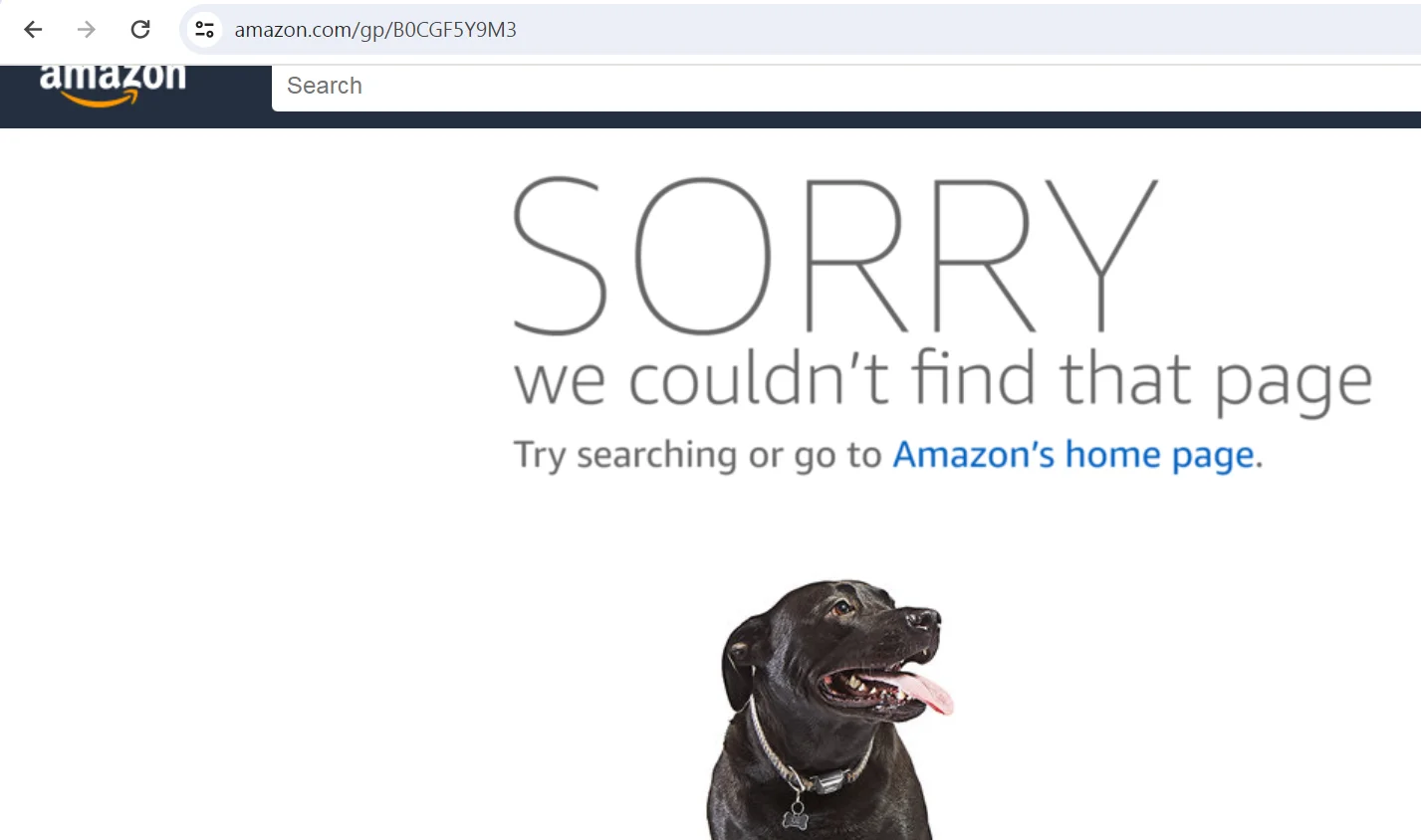

There is something strange, seems that they sold all cameras!!!
If I copy and paste your link this is the result:

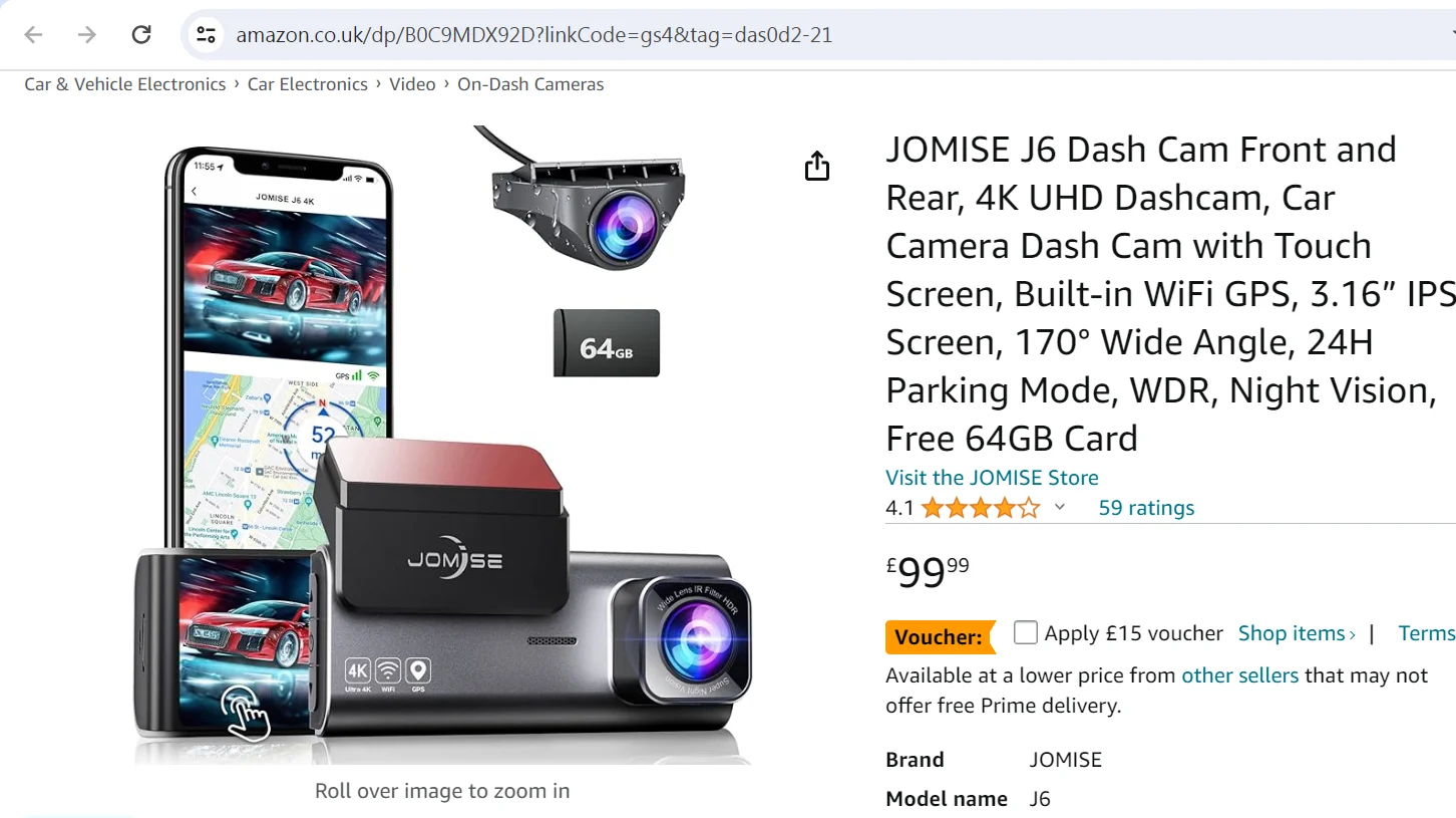

But if I will click on your link this is the result:
But on amazon.com I could find it here.
Fake 8K dash cams

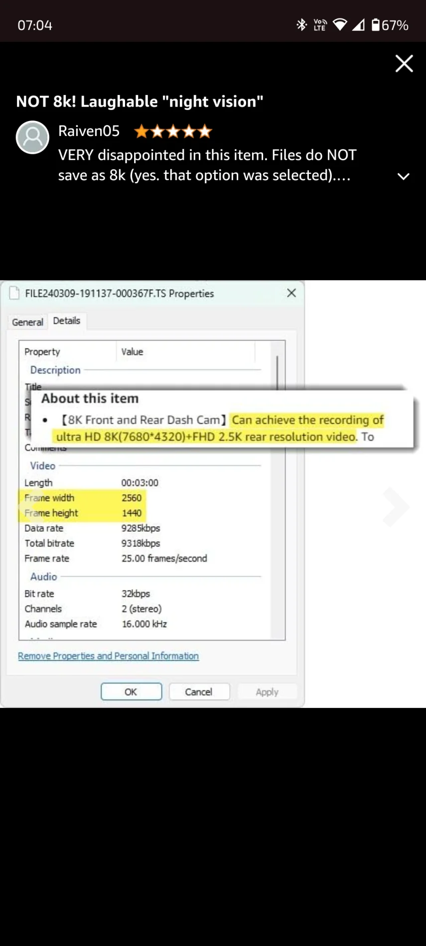

I love how they say in the product video it's their own Ovedisa processor and how you can transfer videos using USB-C cable (yet the camera clearly shows it's a mini-USB port), typos everywhere haha
Anyways, looks like it's a 2560x1440 resolution dashcam at 25fps LOL. Not holding my breath that that's native either haha 😉

I don't know what this alleged "8K" camera is really all about but it seems suspect to be sure. Since it is two channel, I am wondering if they might be claiming two 4K channels, thus 4K + 4K = 8K. 🤔
Also curious about the 32GB Ovedisa memory card it comes with. How much 8K footage can you expect to record to that card, assuming it even works at all? :smuggrin:

Unfortunately (fortunately?) not when it comes to the sensor haha. Can't find a manual online, and the box listings on eBay don't say anything either. No HDR, only WDR, so we all know what that means lol
haha, from the description they really do imply it's full 8K video.
"Can achieve the recording of ultra HD 8K(7680*4320)"

They claim 2h w/ a 32 gb card

I just saw in one of the Amazon images they mention it uses a Sony Starvis sensor. I'm going to assume it's the IMX335, given the 1440p video note you saw.
I'm looking through the lineup of Sony's Starvis sensors and they don't even make an 8K version. The highest they go is 4K with all the different 8MP sensors. They do offer one 12MP sensor, the Starvis 2 IMX676, but even that wouldn't be sufficient given 8K video requires a ~33MP sensor.

You're probs right it's the imx335 - not a bad sensor by any means but definitely not interpolation king of 8K LoL.
