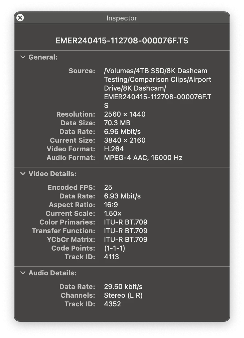

Just took the new "8K" dashcam for a spin. The video quality is pretty abysmal. Looking at the video details, it makes sense why. It's 1440p25 video at just under 7 Mb/s, lol. This is with a 1CH configuration in case it performs better this way than the 2CH setup.
Edit: Looking in VLC (which gives me a more variable bitrate while playing) instead of Quicktime (which shows a fixed bitrate for a clip), I'm seeing a bitrate ~9.2Mb/s like @Agie shared. Either way, the video quality itself is pretty potato'ey. Way worse than I'd expect from other IMX335 dashcams.
Edit 2: So for context I'm doing a quick comparison with the 8K Ace Pro and lol wow. So that's recording at 7680x4320 @ 24fps. The bitrate is ~170 Mb/s reported in Quicktime, or ~165-170Mb/s in VLC. File sizes are closer to 1.3 GB/min instead of 70 MB/min, haha. Frame rates are very similar at 25 vs 24 fps, but the resolutions, bitrates, and resulting file sizes are way different.

lol, yes I'm aware of his screenshot and was confirming parts of what he shared, though you'll note the bitrate that I'm seeing (~7 Mb/s) is lower from the bitrate from his screenshot (over 9 Mb/s) so things do vary. (Edit: Just discovered some variances with that depending on which software I'm using too and I updated the previous post.) I've also got a bunch of sample footage I'm rummaging through at the moment against 4K dashcams and the 8K Ace Pro, plus I want to compare it to some other 2K dashcams as well, but I'll probably move all that to another thread once I put the pieces together. If everything I wanted to know and discover about it was available in an internet search, then you could argue there is no real reason for me to purchase one of these, but even if that was case, I always like to have first hand testing, experience, and sample footage to share whenever doing any sort of PSA type video. 🙂

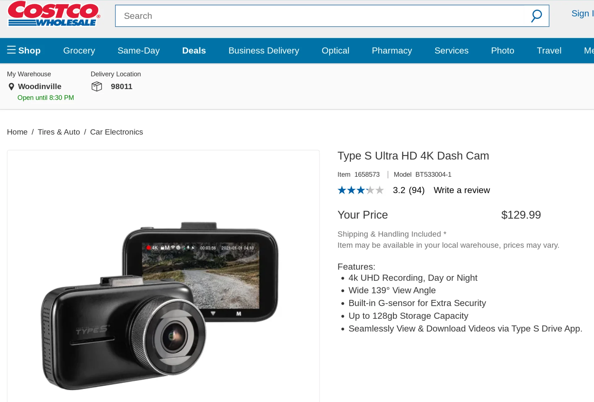

Well, that "screenshot of license plate" is clearly a complete fake. Even an 8k narrow field camera isn't going to show a license plate that clearly at 50m, as indicated by the field of view. This is one of the problems I'm discovering with the TypeS cameras I just bought from costco. They look nice when just reviewing footage, but then when I need to read a license plate or see any DETAILS it becomes painfully clear that the HVEC compression kills everything. Even at the last frame where a plate is visible in oncoming traffic, they're unreadable! I'm getting sick and tired of being suckered by these dashcam makers.

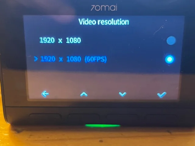

Returning a 70mai A810 4K Dash Cam. It is 2K, not 4K. The only choices in video setup are 1920x1080 or 1920x1080 (60FPS) both of which are 2K.
