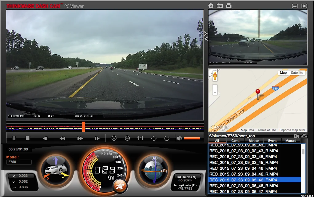

pc software is ok but not great:
- no simple edits are possible (for instance saving only part of a clip)
-it's not possible to see all recordings in 1 list. each recording is grouped (event, manual, parking etc)
and u have to click on each separate group to see the footage.
- I can't get the map to work. it show the route the gps recorded, but the actual map is not there(?)
when I zoom in or out I can see it for a split second and then it's gone again... weird.
