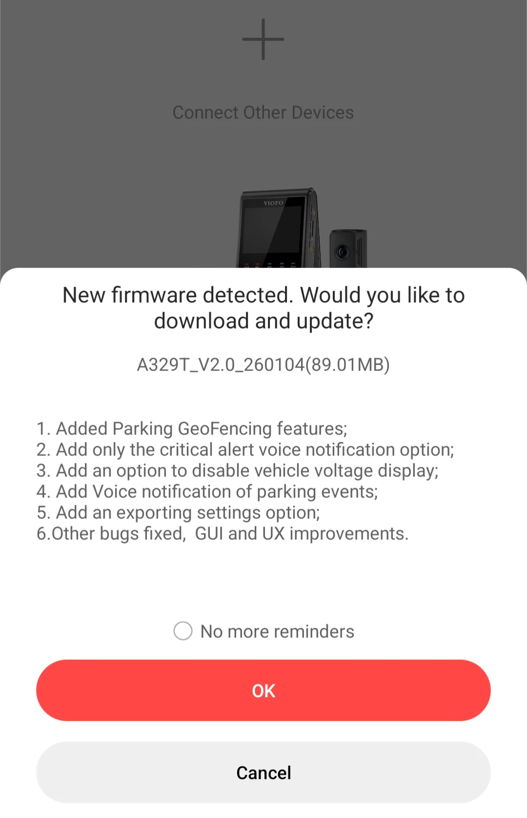

There have been a few people asking about beta firmware updates for the A329T.
I updated to the latest version of the Viofo beta app yesterday then I was offered an OTA update to A329T_V2.0_260104.

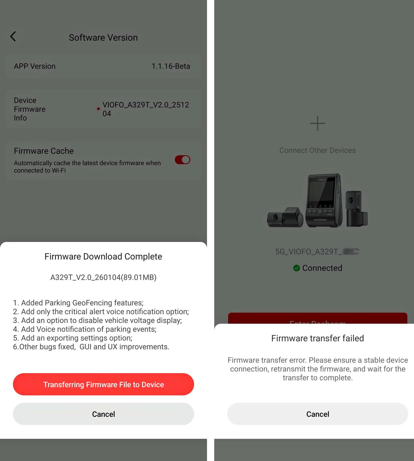

I too did this, BUT it failed 🙁
It went through the download, 100% complete but the transfer failed.
All the earlier warnings about BT and stable connection, Android Auto etc were followed. The Wi-Fi connection happened fine.
I uninstalled the beta app & tried again, twice, but still it failed to update the dashcam.
Is there a way to reset the dashcam itself, as I think that may be required?
Edit: I tried a dashcam reset by inserting a pin in the hole (left side of screen) until the cam went off & restarted, but still no joy with the f/w u/d.
Is that the correct reset procedure?

(seems this may be required to update firmware OTA, or the update may give transfer failed, as user DJ70 mentioned previous to my post)

Edit saved the day 🙂 Tnx.
I disconnected the SSD, then went through everything as before. Firmware updated successfully! Now on 260104.

I ran into a problem updating the firmware OTA for an A329S with a SSD drive connected. I had successfully updated another A329S without a SSD drive just before I attempted to update the unit with the SSD drive. After repeated unsuccessful OTA attempts, I powered down the A329S, disconnected the SSD, and powered it up again. Without the SSD drive connected, that A329S updated successfully to 2.0_260104.
Yea. Seems successful OTA firmware update requires ssd to be disconnected.
I am guessing, perhaps, that the OTA process may be copying the firmware file to current active storage, thus being the ssd, and then triggers the update process, but that process requires firmware to be on the internal sd card.
If the app says "transfer failed", perhaps the validation check for the completion of the file transfer, assuming maybe file integrity check, is then expecting to find the file on the sd card, and it does not find it, thus it triggers Transfer failed error condition.

True, at first I wanted to update my A329T without a memory card, but the attempt failed. 🤣
