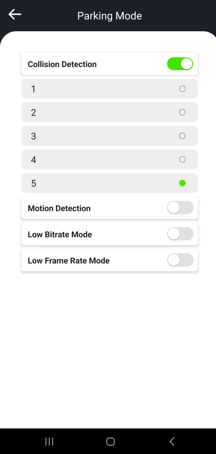

I suspect he either hasn't disabled all parking mode like shown in image above... or he has the camera hardwired to a fuse that is linked to other systems with Canbus and not playing nicely.

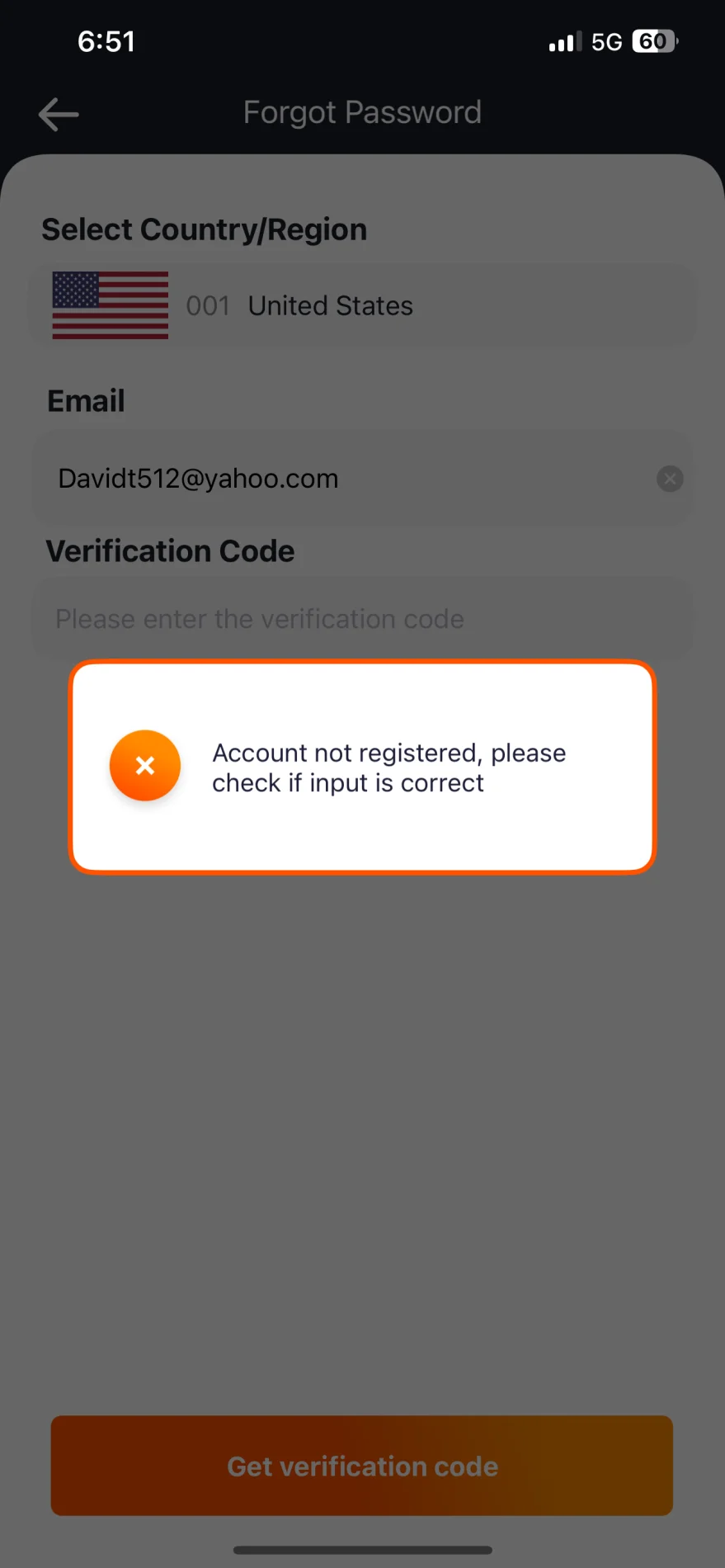

Interesting that there is a place to login from the app, but it won't accept the login information I use and registered on their web site with from my Windows 11 laptop. So, I suspect it's not pulling the latest firmware to send to the device.

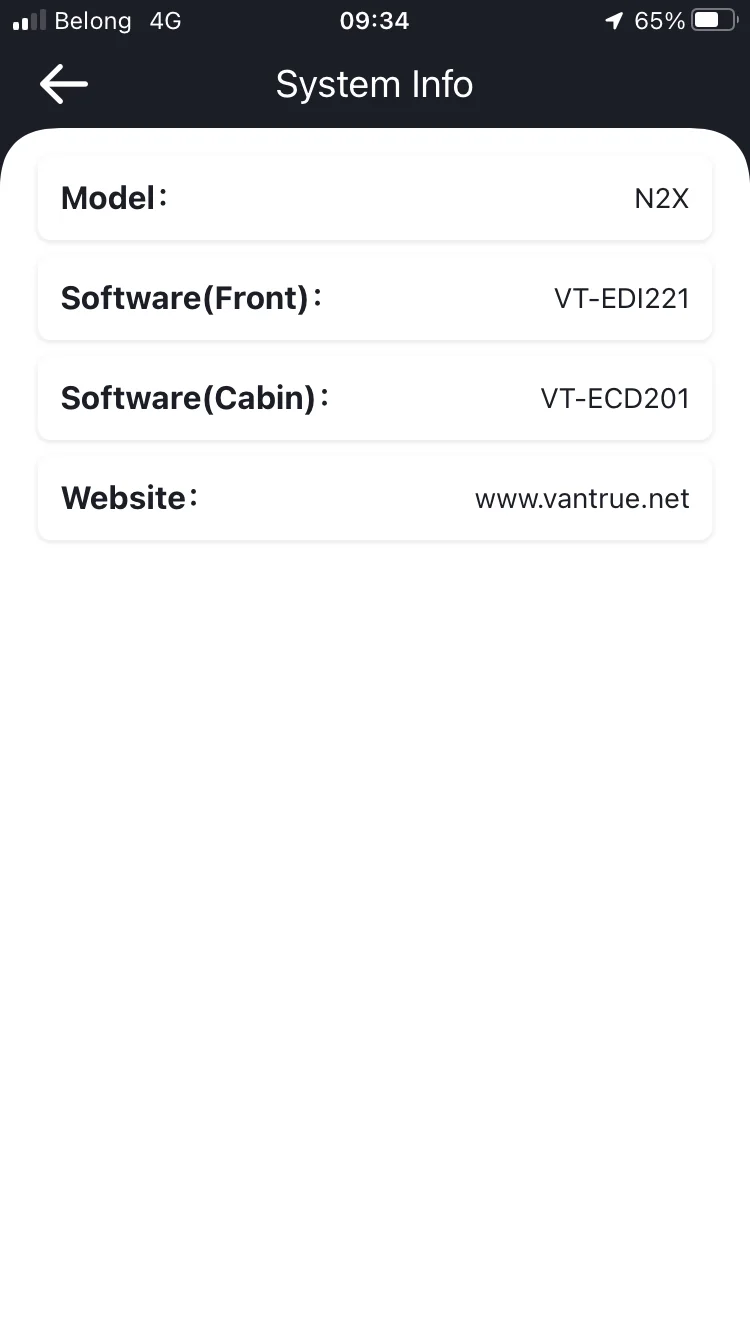

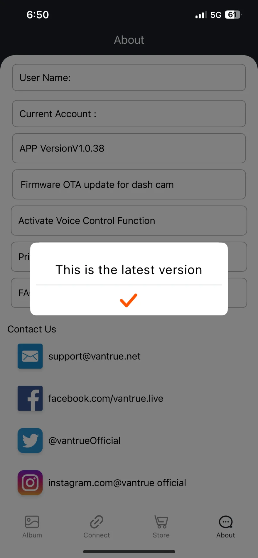

I seem to be having some issues logging into my account from the app. I can log in just fine from my laptop. Weird. Also, see the attached version info. Maybe it's because I'm not logged in from the Vantrue app?

Update firmware / software. Both are OUT OF DATE. Newest is 1.0.58
Once updated, if the issue persists, then you have the camera hardwired to fuses that are not in fact "Battery (Always On) and Access (off with Car"... or You selected a Fuse that has other systems tied to it with Canbus and it's causing conflicts.

Have it send a verification code to your email.. then enter the code...
Did that, entered the code it sent, same error. I even deleted the app from my iPhone and downloaded it again. Same thing trying to log in. I can log in to Vantrue.net just fine from my laptop, and I see my device registered just yesterday. I did download the latest firmware, copied it to a Micro SD card, and updated my N2X. So at least it's updated. And, I went back and checked all of the Parking Mode options and made sure they were off. It does indeed power off now when I turn off the car. So.... I think it's working as it should. The only thing I have yet to test now that I did the firmware update, is to see if it still creates a bunch of still pics along with the Parking Mode videos...... and I need to figure out how to login to my account from the Vantrue iPhone app. Apparently, it's the Chinese New year from Jan 28-Feb 4th, so they aren't responding to inquiries until next week.

I went back and tested all of the Parking Mode options and made sure they were off. It does indeed power off now when I turn off the car. So.... I think it's working as it should.

Did that, entered the code it sent, same error. I even deleted the app from my iPhone and downloaded it again. Same thing trying to log in. I can log in to Vantrue.net just fine from my laptop, and I see my device registered just yesterday. I did download the latest firmware, copied it to a Micro SD card, and updated my N2X. So at least it's updated. And, I went back and tested all of the Parking Mode options and made sure they were off. It does indeed power off now when I turn off the car. So.... I think it's working as it should. The only thing I have yet to test now that I did the firmware update, is to see if it still creates a bunch of still pics along with the Parking Mode videos...... and I need to figure out how to login to my account from the Vantrue iPhone app. Apparently, it's the Chinese New year from Jan 28-Feb 4th, so they aren't responding to inquiries until next week.

I'm getting an error logging in, too. So that part seems to be on Vantrue's end.
I don't think you need a login / password to utilize the connection via the Camera's Direct Wifi.

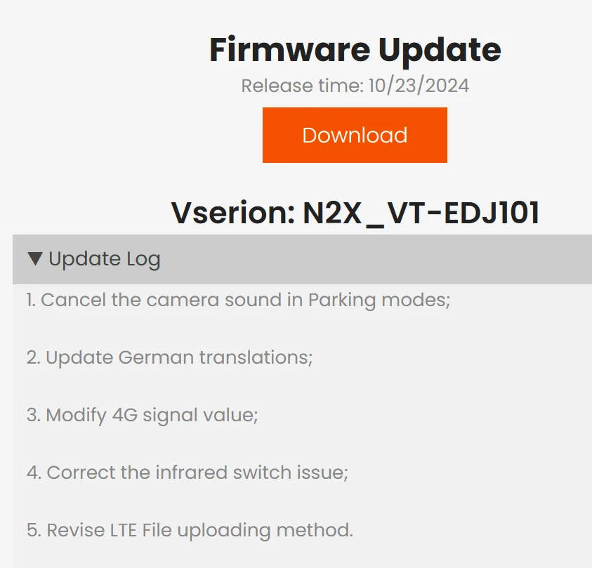

Here is newest Firmware: https://www.vantrue.com/pages/n2x-manual-firmware

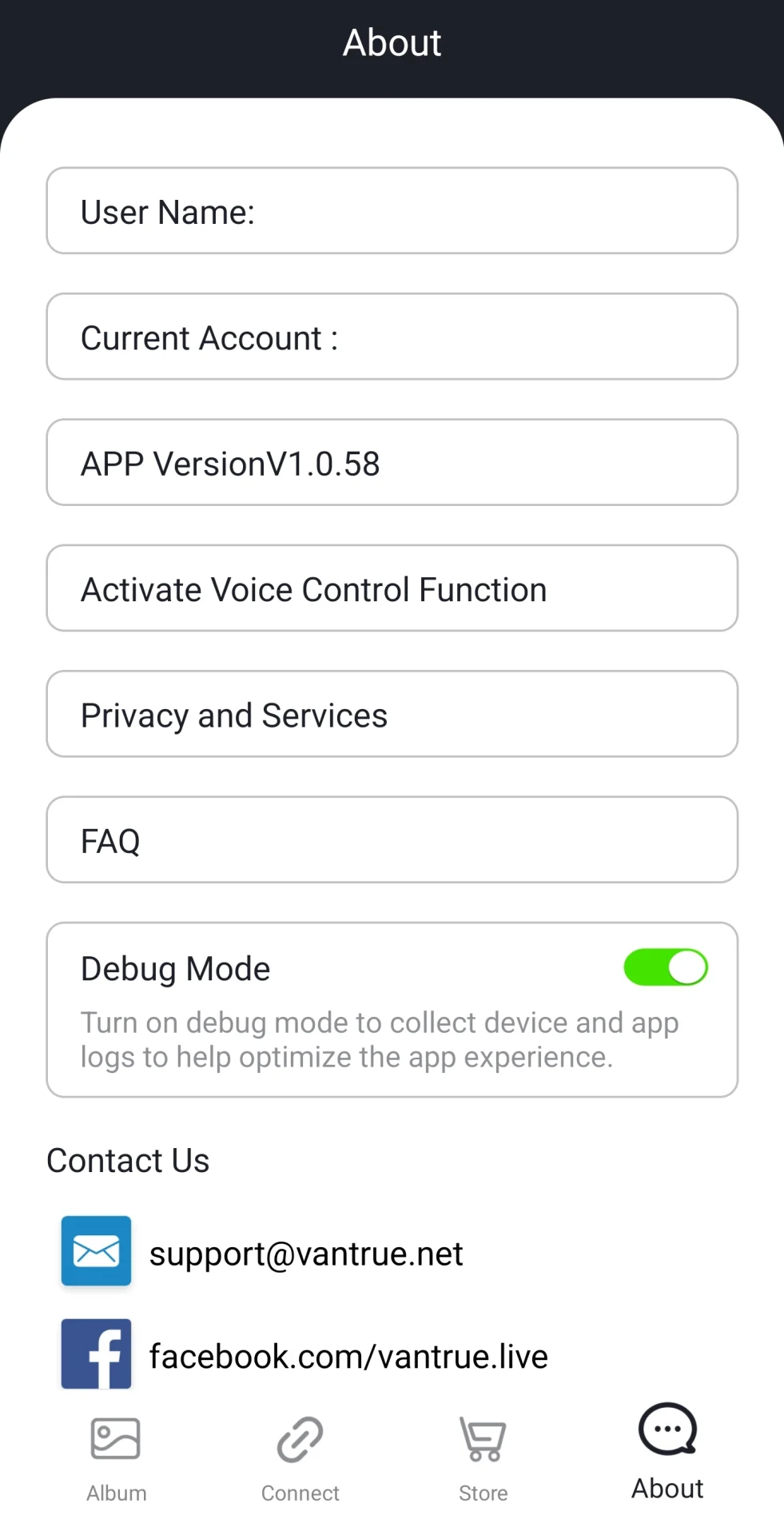

Newest Software is 1.0.58 for Android

Thanks for the link to the firmware.
It seems there is a newer version of the software for the N2X even though the app doesn't prompt to update it.
The version is
Vserion: N2X_VT-EDJ101..... lol​
Hey @Jeff_Vantrue spotted a spelling mistake.
found here: https://www.vantrue.com/en-au/pages/n2x-manual-firmware
I'm about to update my N2X to the newer firmware. 🤞

I just double checked the Apple IOS store, and the lastest version is 1.0.38 for iOS, not .58

Well isn't that interesting LOL. Mine is out of date then, too.
