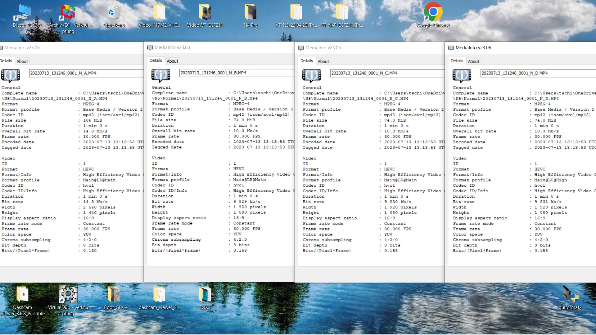

This is what the bitrate of four cameras looks like when recording at a resolution of 2560x1440.

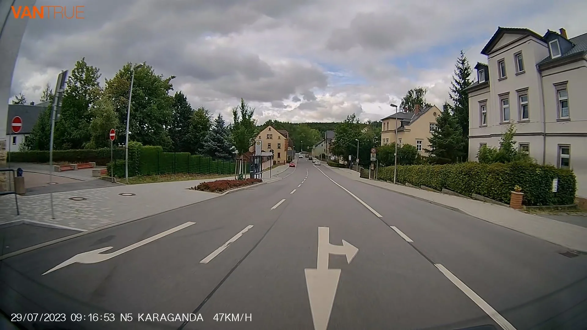

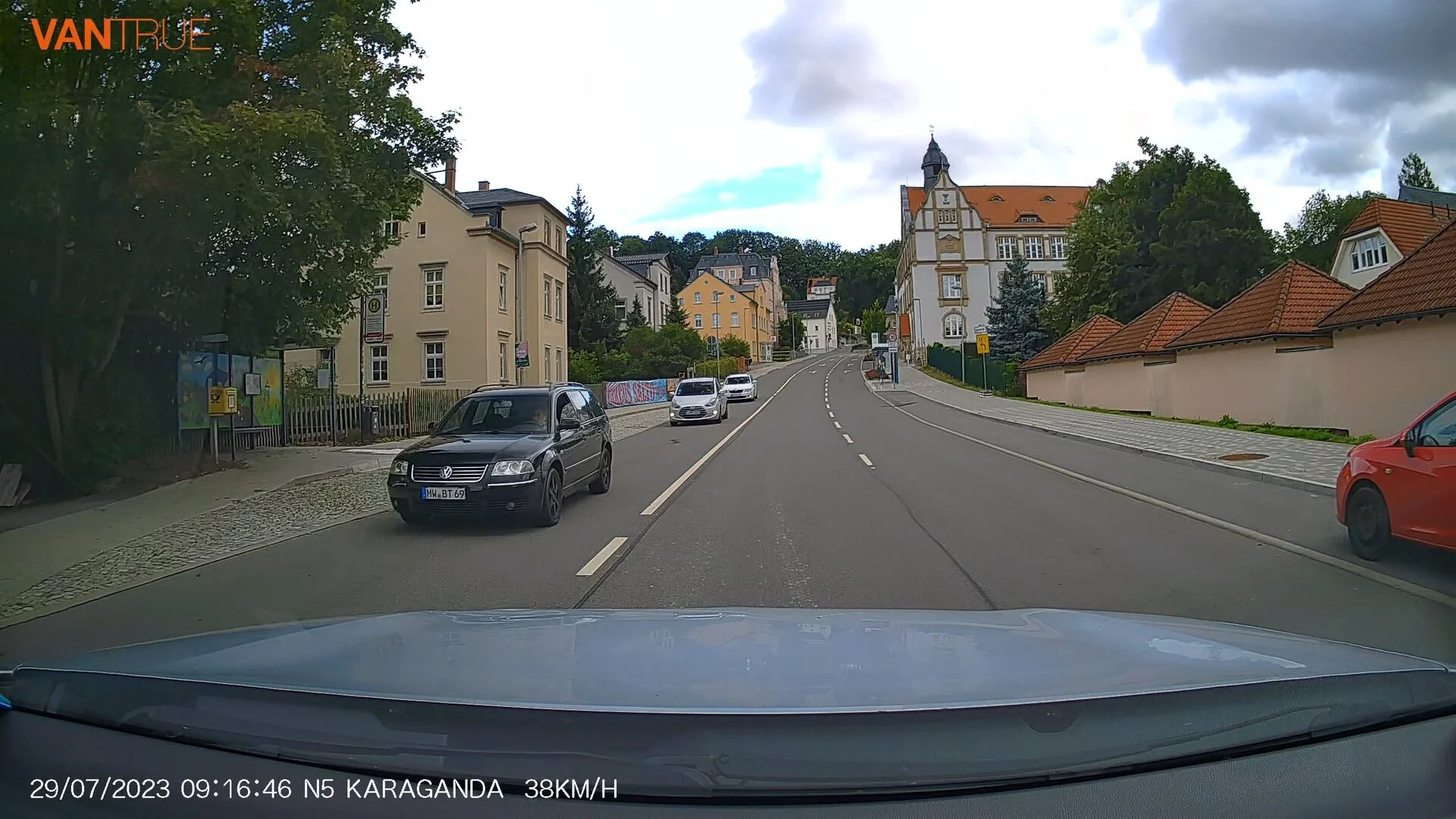

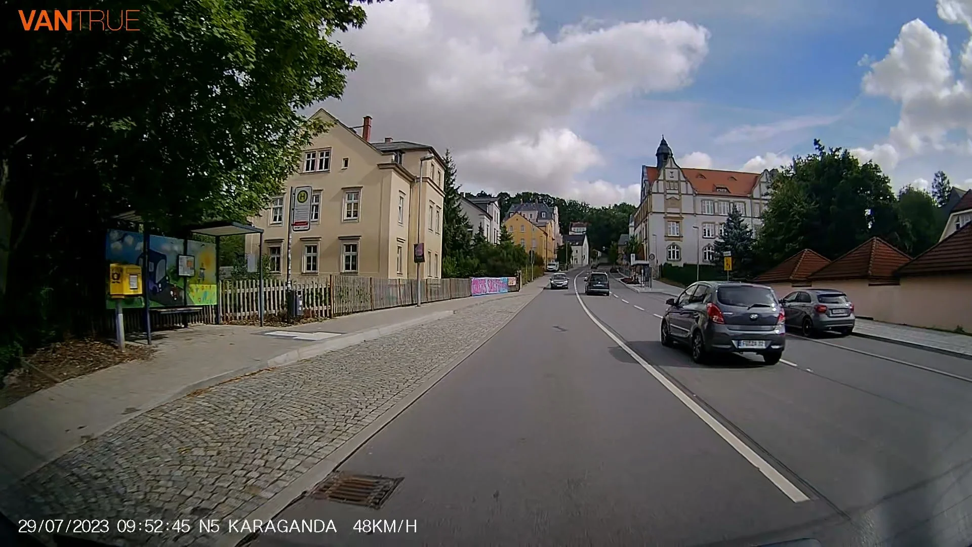

Screenshots from the front and rear cameras.

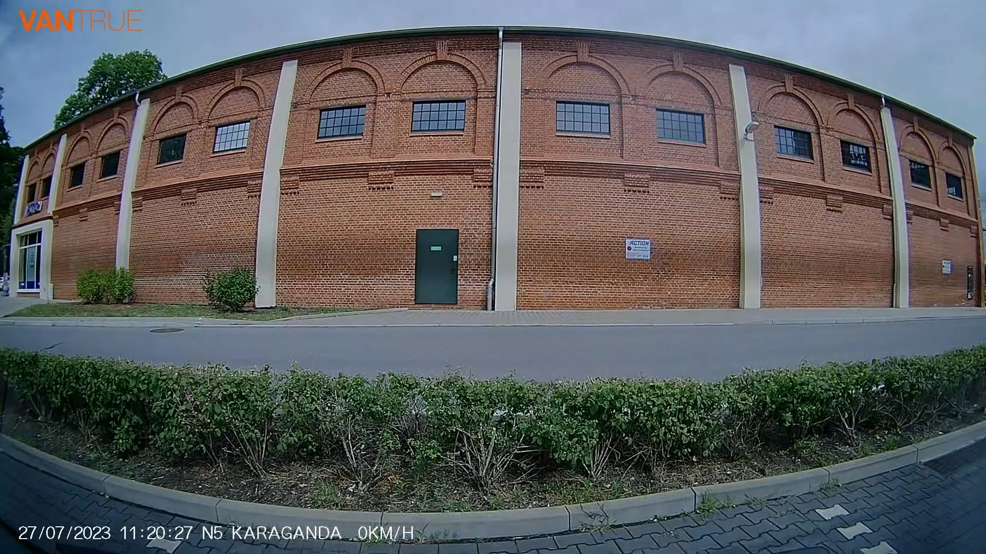

Screenshot from the interior camera on the firmware VT-ECD201
Screenshot from the interior camera on the firmware VT-ECF211
Somewhere something went wrong...

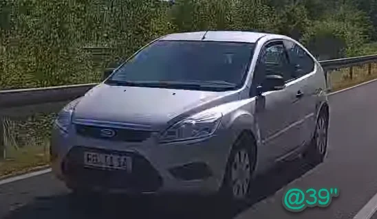

Vantrue N5 front camera
MOD - firmware on which the video was shot is here.
Doesn't look very sharp at this point in the video. This is a direct screen capture at the highest res in youtube.
Considering that along the road there are green spaces with many leaves,
then there is not much chance to see something on the stock firmware, with a bit rate that is half as much.
On the original video everything looks fine. ;)
This is what the bitrate of four cameras looks like when recording at a resolution of 2560x1440 on the MOD firmware.
