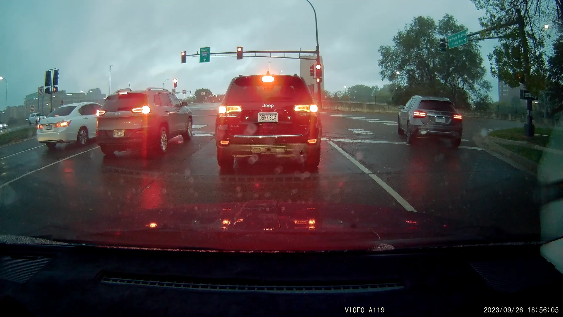

Thought the new A119 Mini2, be the latest and greatest fancy sensor was superior with HDR and all that.....
So why does it look darker, much more Nosie and just crappy compared to my old and very well used A119 V1 that has "WDR"?
I also notice the A119M2 switches between this grainy noisey picture, to a softer but much less noise image, then back again... it was lightly raining and a the wipes moving across would trigger the change. Mainly noticeable in the clouds.
EDIT: To anyone reading this later on, HDR in dash cams is new to me, and i did not know that HDR is to be used when it is fully DARK out.
This low level/rainy scenario is kinda an in-between time where both HDR and non HDR the image is not going to be ideal.
VIOFO and many other here, strongly recommend to use the HDR timer feature, to turn on HDR after it is fully dark out, and off, just after sunrise, for best results.
DO NOT used HDR during the day time/sunlight.

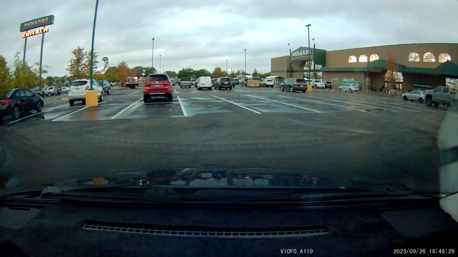

Here is also 2 more compares. HDR just looks worse.
EDIT/UPDATE: see my re-test, when it was fully dark out. HDR is better!

General rule of thumb is to set the HDR timer to turn the HDR to come on at night, and during the day the HDR should be off...
It is quite dark (not night dark but still) and gloomy out during this test. And the old v1 did better with its "WDR" making it look much brighter out.
Under these lighting conditions HDR should be OFF.
You'll get the best performance out of the A119 Mini 2 using HDR one hour after sunset, (complete darkness).
The darker image makes room for the HDR to put more detail in the bright areas such as the bright windows on the building, and reflective plates if you had your headlamps illuminating any.
The noise in the sky appears to be rain drops, which the Mini 2 can see but the A119 is failing to see.
The wipers remove the rain off the windscreen, the Mini 2 can see this rain, so removing it reduces this "noise", but the A119 V1is not seeing it, so the wipers removing it makes little difference!
Your Mini2 appears to have a better focused lens, allowing it to see more detail of the rain on the windscreen as well as outside, but it also has better focus because it has a wider field of view, thus a greater depth of field. The wider lens also slightly reduces the detail on distant writing.
To me, the Mini 2 image looks the better image, although it is a little darker than I would like. Maybe turning the brightness of your monitor up would help you see the detail in the darker areas? Or alternatively view the video at night in a darkish room.

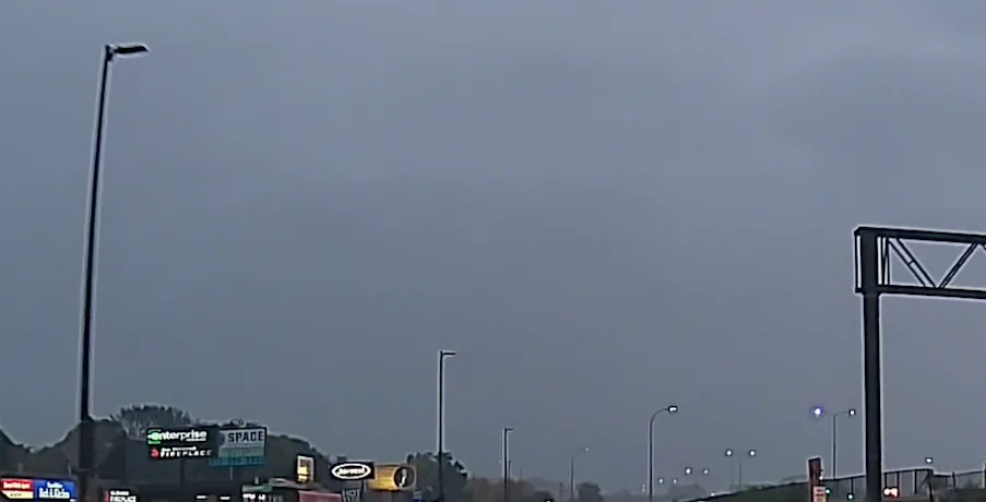

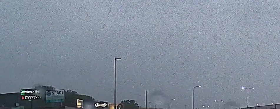

lol. No. Not referring to the rain drops. The whole frame shifts to a Nosie mess then back again. The sky is distorted then not. The clouds look like there is a bunch of tiny black specs in them, then it goes away, not at all what it supposes to look like. For sure is NOISE. Both images from the A119M2 couple frames apart. HDR processing for sure is just wonky. But, i guess it not dark enough, so that is why.
It is looks like a different types of frames in H.26x encoder - I-frames vs P-frames vs B-frames
